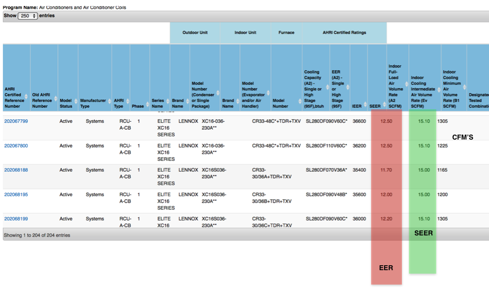

The issue with a "dedicated" 16 SEER outdoor unit (split system) is the 2 year old indoor coil may not have the volume area to work properly with the outdoor unit to actually get the SEER rating you think your paying for. At this point, when mix / matching split systems, throw SEER out the window, so... you might as well go cheap as possible.
See attached. Dropping down to a XC-1636 2 stage AC in a Lennox outdoor unit, with a CR33-30/36 coil, the best you're going to get is 15 SEER.
5 questions which don't really help you, but curious on my end (which may give you options with the installing contractor)...
1 - Why a 80% variable speed two stage gas furnace in dedicated down flow application? Generally speaking, in NC, an 80% gas furnaces are used in attics because contractors don't want to deal with potential water issues during winter time using a condensing 90 plus furnace OR it's dedicated down flow positioned in a closet where you don't have room for a flue off to either side OR it's a price issue for a condo and cheap is best.
2 - Exactly what SEER rating was the contractor trying to sell you with a 3 ton XP20 outdoor HP unit using a CR33-30/36 coil? I ask because I don't see a system match using that coil with a 3 ton XP20 HP. That would make sense to me because the coil starts off rated as a base 14 SEER, and generally speaking with all manufacturers, the higher the SEER, the more coil surface area you will need, generally in the indoor coil, where you have to "up size" to a large indoor coil to get the higher SEER.
3 - Assuming since the original plan was a fully modulating heat pump, are you currently using an iComfort t-stat on the wall with your current SL280DF gas furnace?
4 - How long ago was the gas furnace installed?
5 - Is the ductwork all new with the gas furnace, or was it already there? (you mentioned you'd prefer a 2 ton but the contractor went with a 3 ton and I'm assuming the contractor did the load calulations and gave you a copy for your records).

Addressing by question #
1- The furnace is a condensing type in the 90+% efficiency. It was originally provided due to adding a future heat pump, which I am no longer going to do. The furnace is extremely cheap to operate, actually much cheaper than the power to operate a heat pump. Natural gas up here is the go to energy source. The furnace is in the garage of a single story building, down flow with ducts in the crawl space. Slab on grade is unheard of here.
2- 14-16 SEER depending on weather variations. Example snapshot in time today: Outdoor, temp 40F, humidity 96%; Indoor temp 71F, humidity 31%. Last thing we need is removing more water with a colder evaporator. In fact we could use a humidifier year-round to have better comfort. The 3 ton coil with a 2 ton compressor would help that situation. For no more use of the AC than we need here in the NW any SEER above 14 is a +. It is a comfort thing, not must do like in your area.
3- Yes on the thermostat
4- 3 years ago
5- Existing ducts. I need to evaluate that relative to the now AC application. Definitely need to increase the insulation of the ducts for both the heating and cooling cycle. Heating cost would come down some more. Ducts were installed almost 30 years ago. The estimator never got back to me on the calcs and I was too busy at the time to follow up.
I have had them doing routine maintenance service but am getting dissatisfied. At 84, I avoid crawling around in the crawl space so, need to hire out some work. Even finding good labor help around here is futile. It is the old thing; I know how but can't do it anymore.
I am in the planning stage and need to address items as funds crop up. Early on (this year) duct insulation and adding an outlet in the kitchen. For some reason the original install omitted that room.
Thanks again for all the good advice, Ron

The new furnace is a SL280DF.
Ron
The Lennox SL280DF is a 80% variable speed 2 stage, not 95%-98% AFUE.
SLP98DF is 97% AFUE variable capacity, which I assume Lennox means modulating.
EL296DF***XV is 96% AFUE variable speed two stage
The above two furnaces would use the iComfort communicating t-stat.
The EL296DF***XE looks to be a two stage X-13 (ECM) blower motor which does not use the iComfort t-stat.
I only mentioned the t-stat because from what I've read so far, unless the contractor spelled out exactly what YOU wanted, and YOU wouldn't take no as an answer from him, I don't think he gave you all your options per price point at the time of sale and how this could play out if you change your mind. I have no qualms selling a homeowner what THEY want, but if it were to go agasint my professional opinion on what needs to be done for the best interest (IMO) of the homeowner, I'd note it on the contract as a CYA. People tend to forget what they said a couple of years ago, but it it's initialed at the time of sale, it's documented.
From what I've read so far, not certain why he just didn't sell you the high end gas furnace by itself less high t-stat with the option of either dual fueling or going straight AC when you decide to do it. You probably wasted at leasat a couple of grand on the coil and t-stat alone when you really didn't need to at that moment in time (added the fact that it's a given that the homeowner can change their mind "years" down the road and you don't want to put yourself into a corner).
