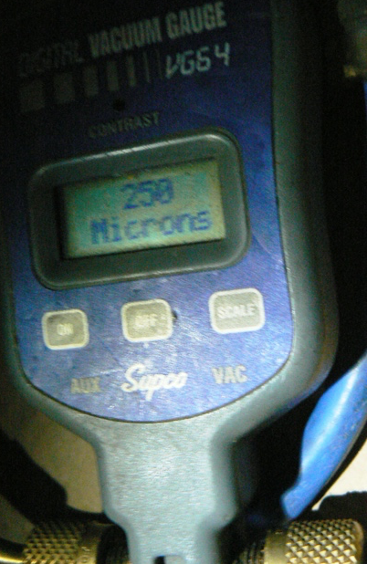

If you do it yourself, also make certain you have a decent vacuum gauge.
This was on my own home, around 10 at night (250 microns).
Biggest mistake IMO guys make is getting lazy to is pulling a GOOD vacuum, ensuring the system is sealed, and using cheap silver solder for braze joints on the the copper fittings. System the gauge is hooked onto in the pic is an Armstrong heat pump system. In 12 years of operation, never had one part go bad on it. Have another Armstrong split duel fuel system, and in 15 years since it was installed, one bad capacitor on the heat pump and a variable speed motor in the gas furnace (let me tell you, even at a dealer cost, those variable speed motors are outrageously expensive).
My point about the lack of failures at my home is that the brand name doesn't have much to do with how good the unit is (all manufacuturers have issues here and there). What's more important is the quality of install. If YOU take pride in your work and feel confident that you know you'll do a good job, in all honesty, you'll probably put your own HVAC system in better than the average HVAC contractor would. That said, that's why GOOD HVAC contractors sometimes aren't the cheapest.
