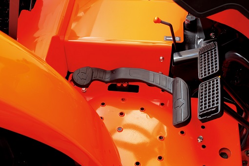

The peddle took me a little while to get used to, now I like it. Big mistake placing your foot on the top and "rocking" back and forth. Its just way too uncomfortable for anyone over 5ft tall. Use your toe on the forward end and rest your heal on the floor board. For reverse, lift your foot and place your toes where your heal was, and heal on the rear part of the peddle. Yes, its more movement of your leg, but way easier to control.
As crashz states, that is the way to operate rocker pedal. I think first impulse for some is to place foot across whole top of pedal, which again as crashz states, a big mistake, then they're turned off to the treadle.

Really, I don't see it as a big mistake at all. I find it odd that that's the way someone uses the treadle pedal in the manner you've described and the one shown in the video linked earlier, if that's what a person likes then so be it. Our son has an L3940 with almost 2000 hours on it that's used 365 days a year on a cattle feedlot, lots of in and out feed troughs. It's other main job is to load a 155 bushel manure spreader. I've timed it and that spreader can be heap/pile loaded in under 4 minutes and I've never seen anyone here lift their foot off the treadle pedal to go from forward to reverse. Now I realize the L3940 has a slightly different shaped treadle pedal but he had an MX5100HST at one time and it was the same shape as a L2501 but maybe a bit larger pedal not sure. I don't recalled anyone not being able to just rock their foot on the MX.

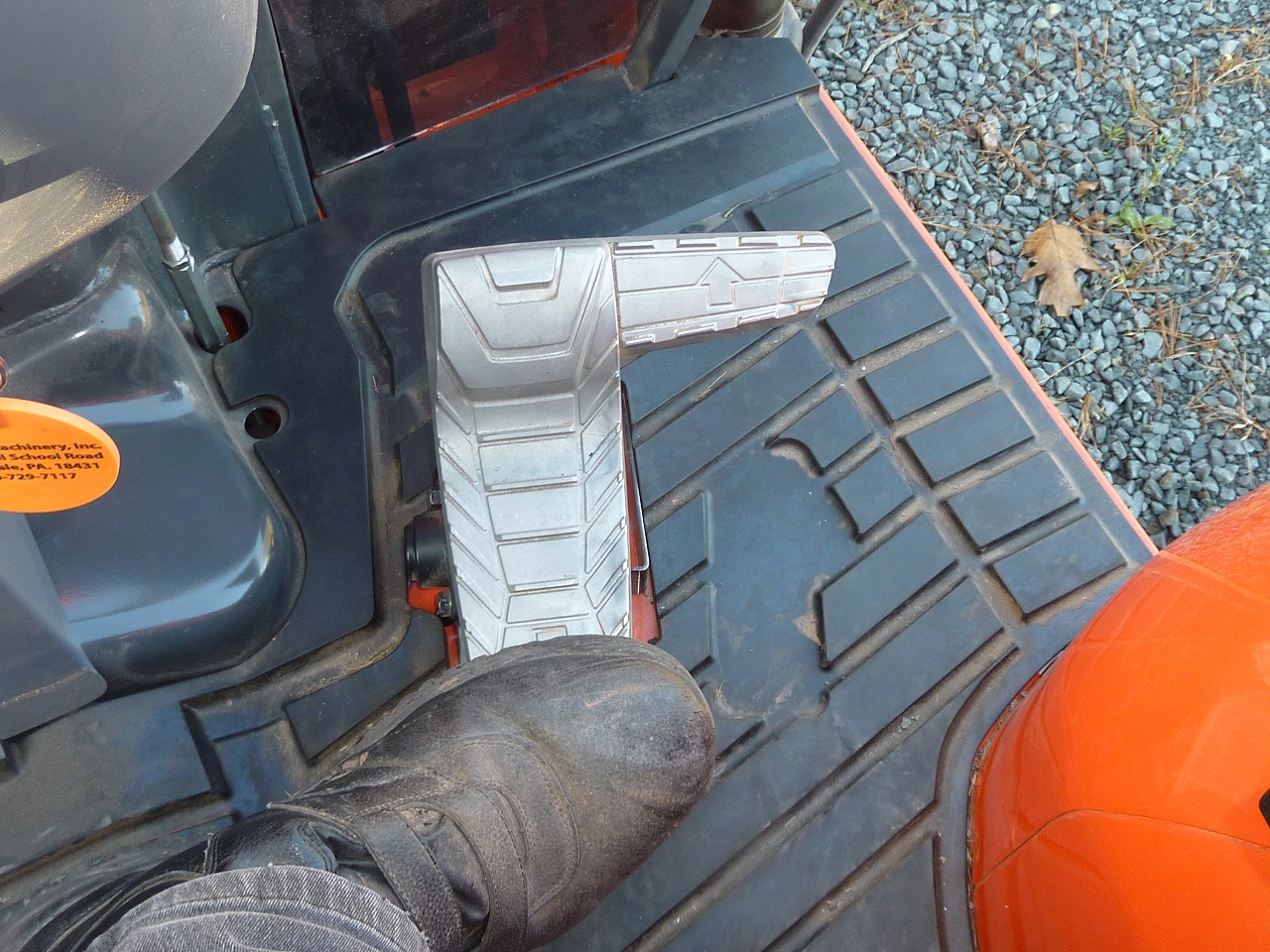

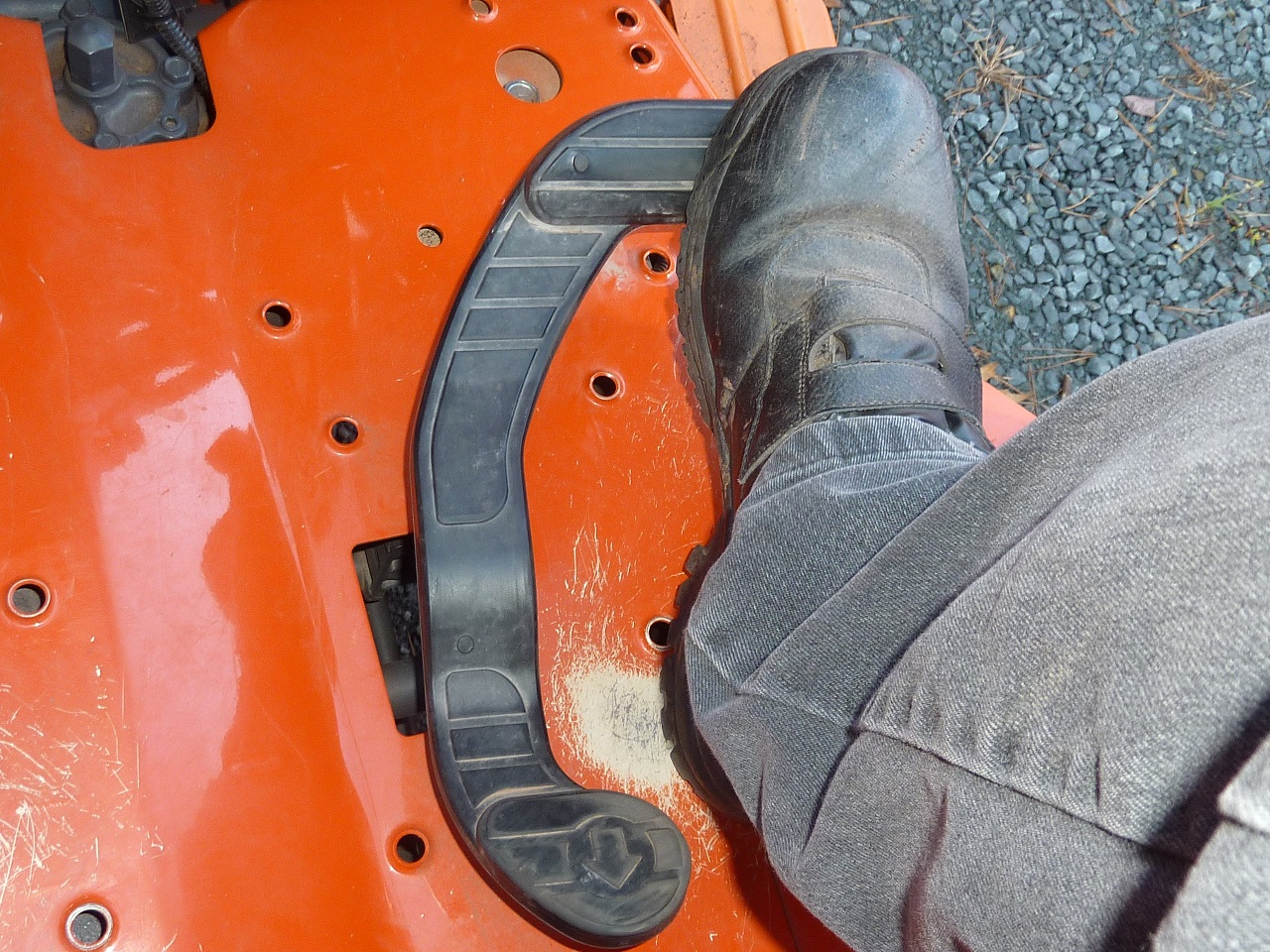

Obviously there are a lot of differing opinions on gear vs HST. If you don't do much maneuvering or frequent repetitive tasks, Save a few $$ and go with gears. In my case, five of the six Kubota's I've owned over the years have been HST's. For the work I do in tight spaces, I much prefer the time savings of not having to stop and shift frequently.
I'm not sure what model year Kubota tractors you're looking at. Since there is no clutch on Most newer L series HST's, many now have split brakes on the left. This is the case with my current L6060 and MX5800 and I frequently steer using brakes.

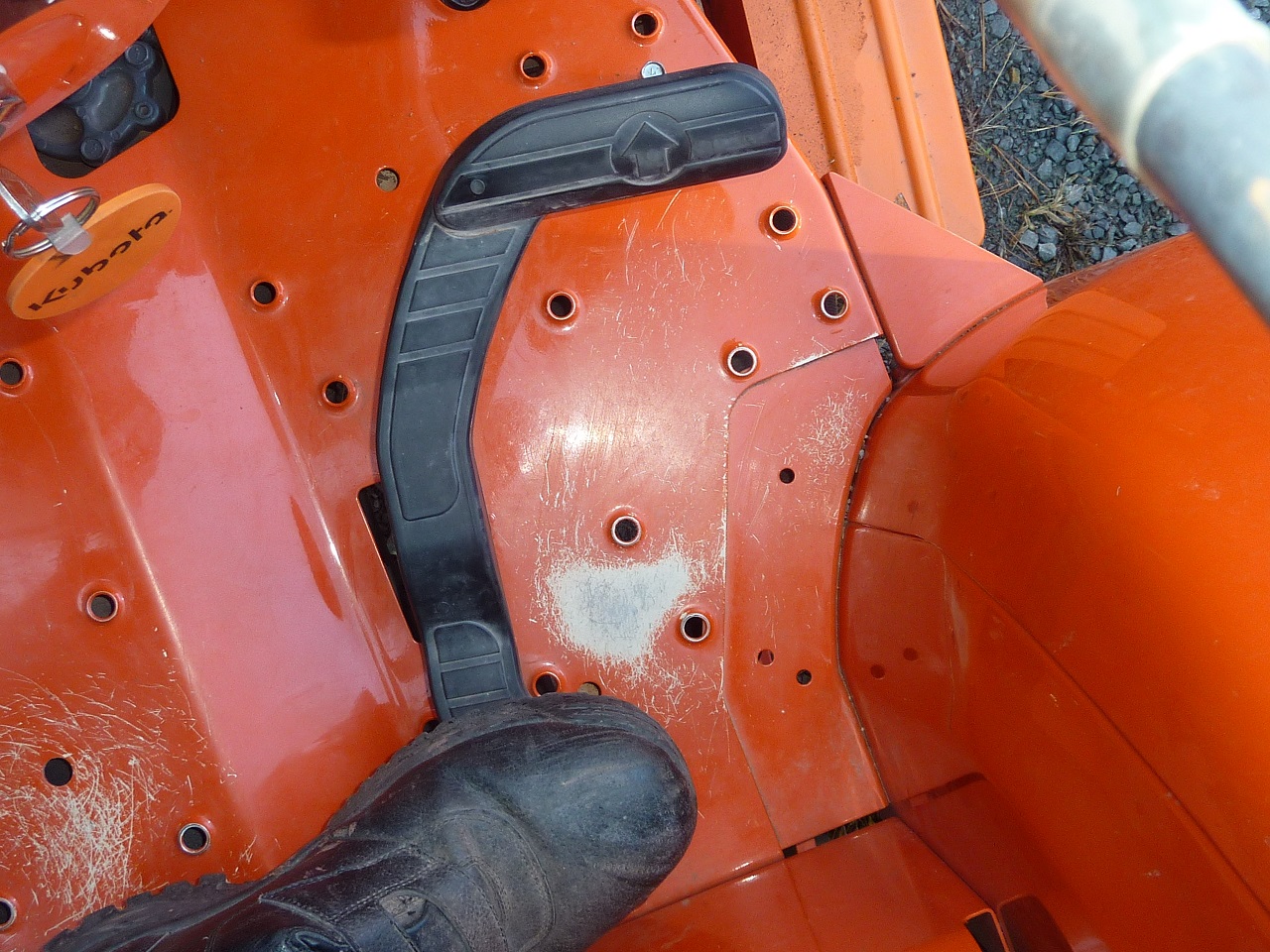

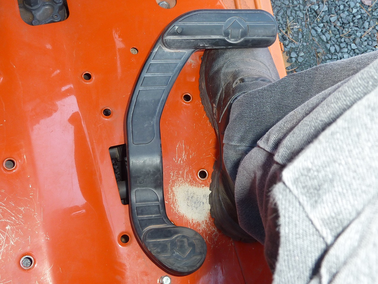

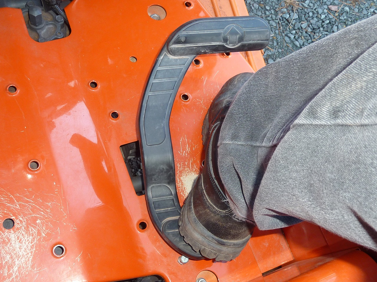

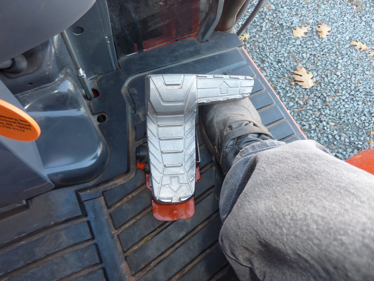

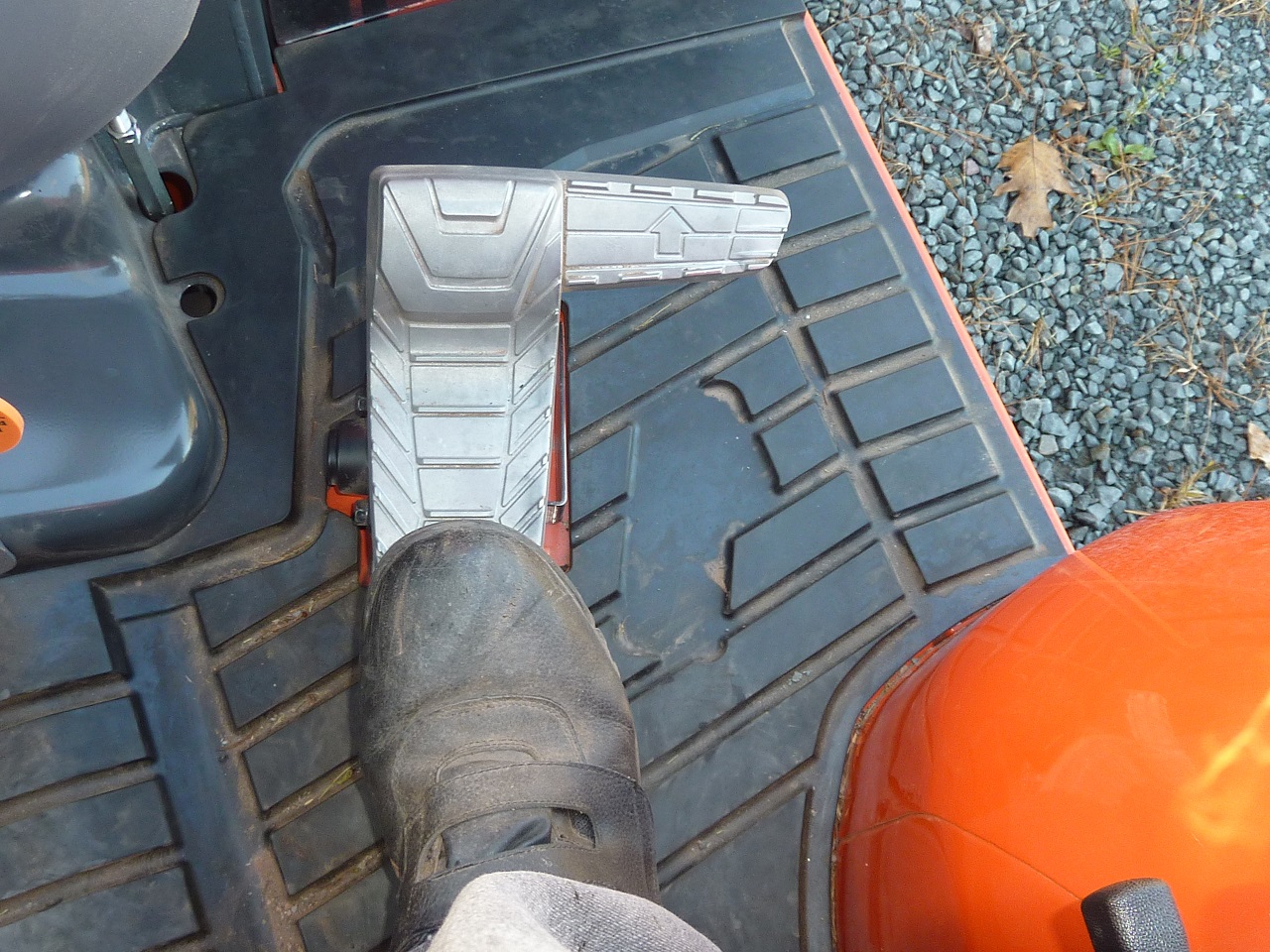

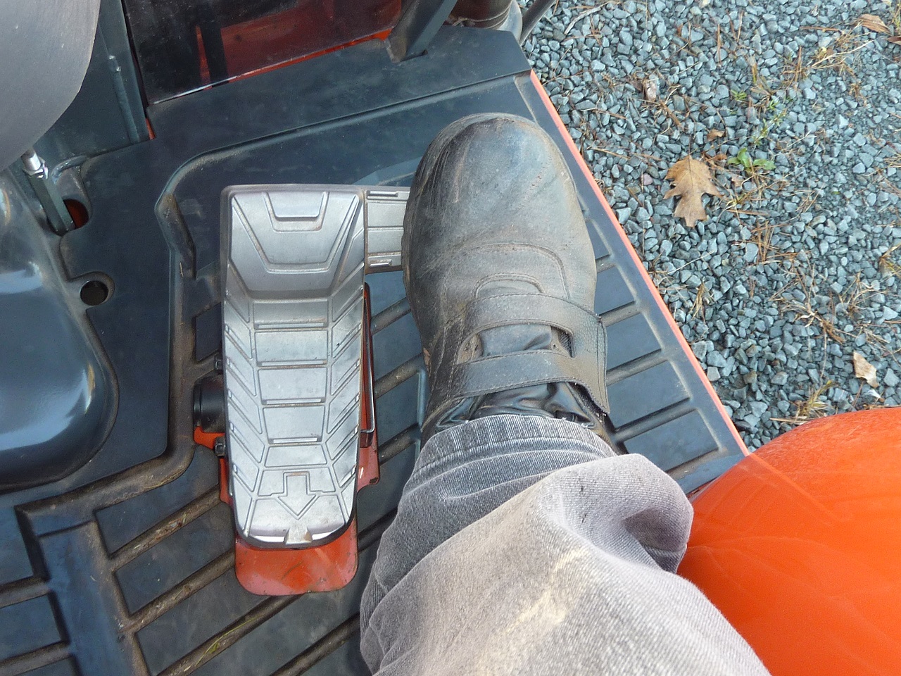

The HST pedals are also subject to personal preference and some user adjustment is required to use comfortably. I use these techniques:
L6060
MX5800
When operating in reverse, I use the toe of my left foot as shown in the third picture in each row. I can't speak for others but I have arthritis & two joint replacements and have no trouble with these operations.
Your bottom pics are how I operate my MX5800 as well. Never operated a Geared tractor so I have no experience to say anything about them.
