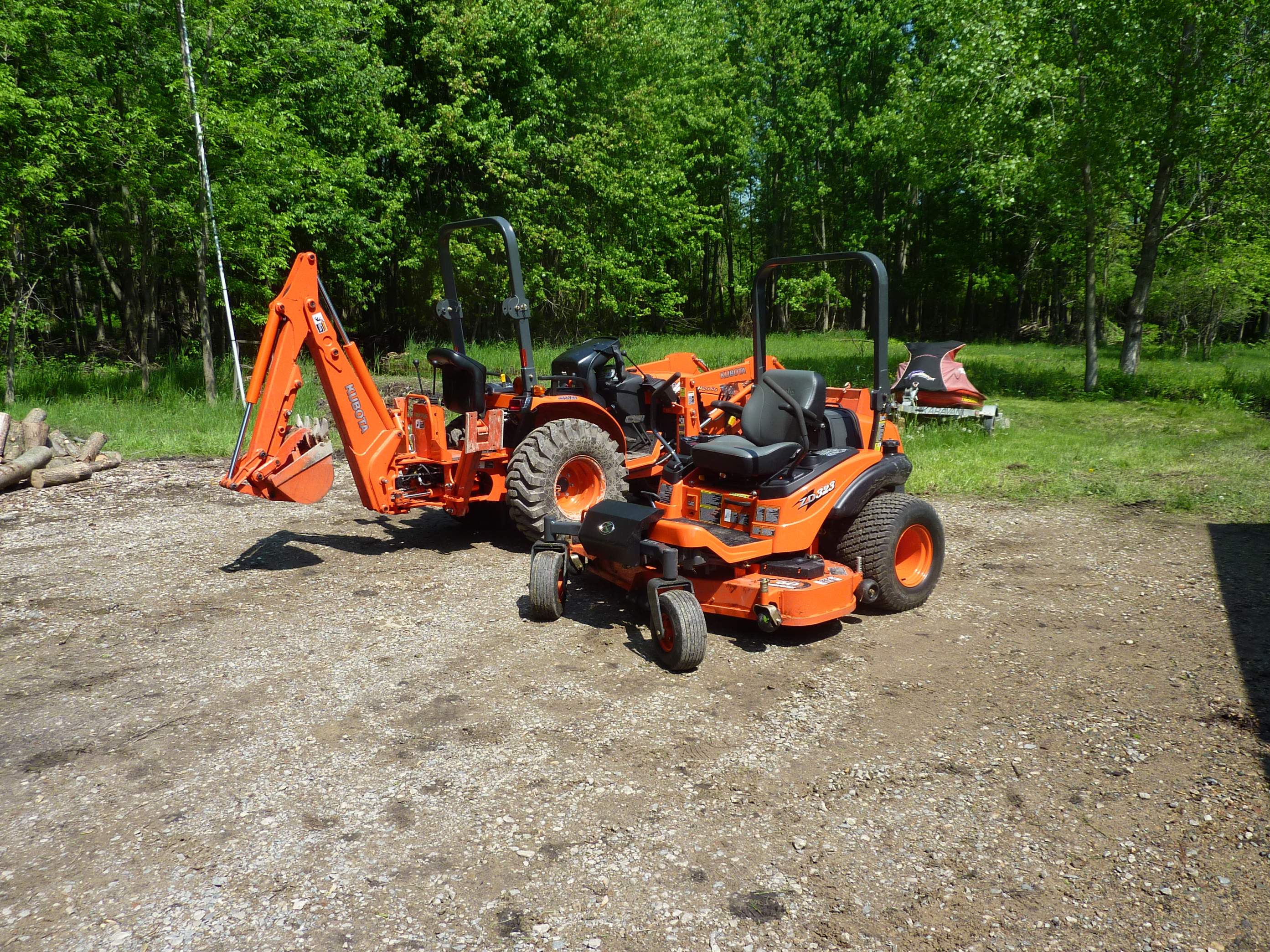

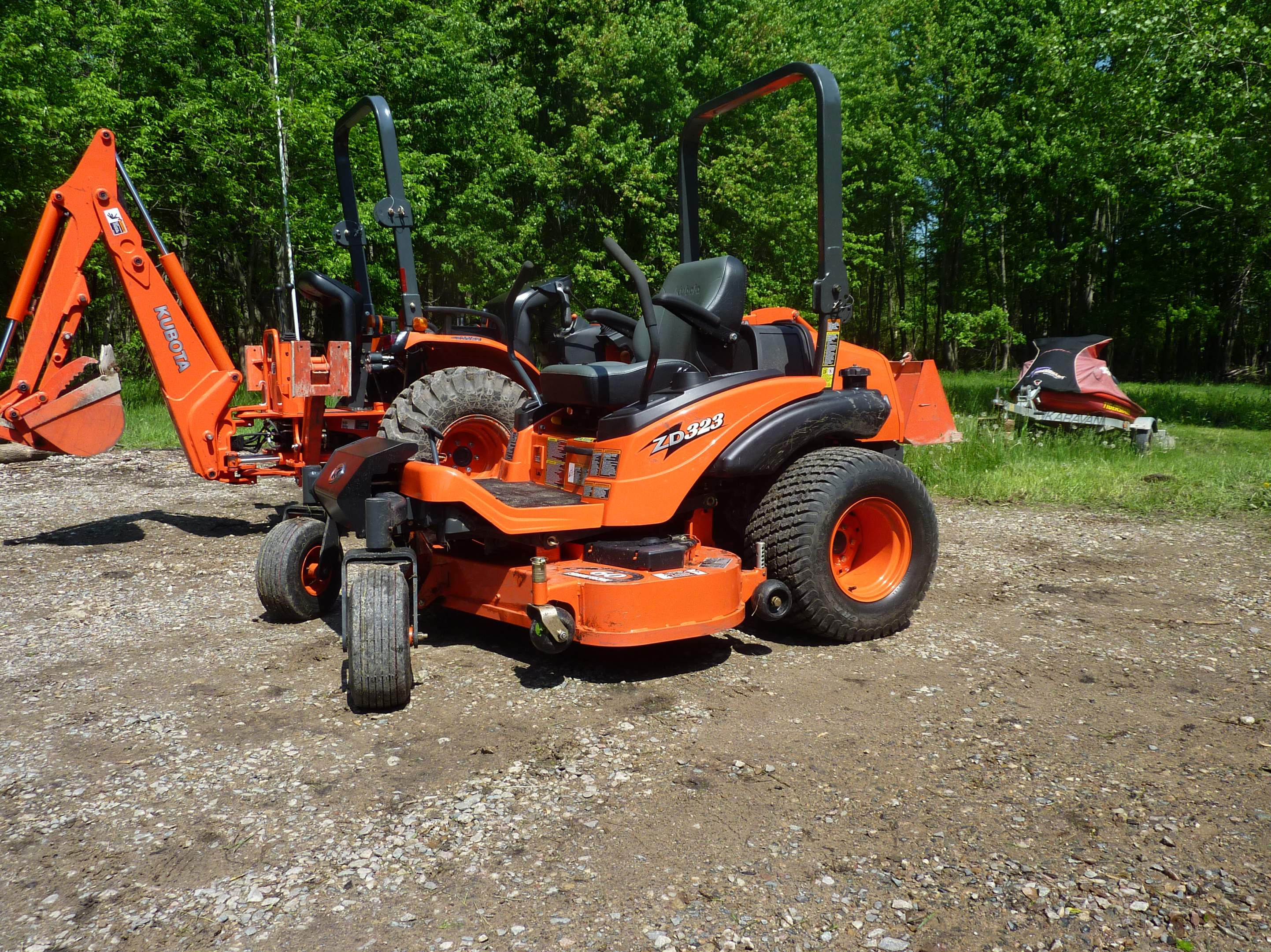

After a lot of research I chose the ZD323 as the new mower. My original intention was to put a belly mower on the B3030 but realize that I didn't want to tie up the tractor for mowing duty. I bought from my favorite local Kubota dealer and as usual, I found his advice to be on the mark. He wanted to be sure both my wife and I would like the mower so he delivered it, told me to use it before I made a decision.
What I had trouble with was which of the three engines I should choose. Seems from reading on the Internet the 26HP was the most popular. My dealer suggested the 23HP model based on my needs which were the ability to cut tall wet grass. He told me the 26HP was designed to be used with the grass bagger and the bigger one with the 72 inch mowing deck.
When they delivered it, it was drizzling and had been raining for the past three plus months so the grass was wet and tall, just under knee height. I gave it a test and without issue, the 323 mowed right through the tall wet grass.
With the speed that the mower cuts I figure our mowing time will be cut down to about three hours. My wife got on it and didn't have any problems navigating the mower even through it was her first time on a ZT.
