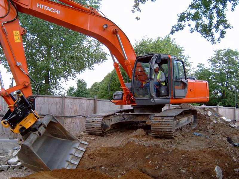

/ A very helpful tool! #2
What am I looking at? Something that spins bucket in a circle? Interesting. That gray box on the right looks sort of out of place.
Yes a spinning bucket and same time tilting bucket. You can spinn the bucket 360 degrees endless at the same time tilt the bucket to the both sides +/- 40 degrees. Helps you create magic things and you dont need to move the machine around so much.

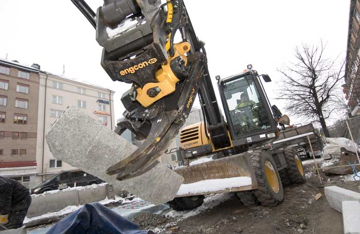

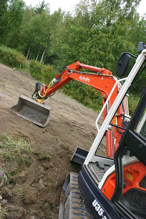

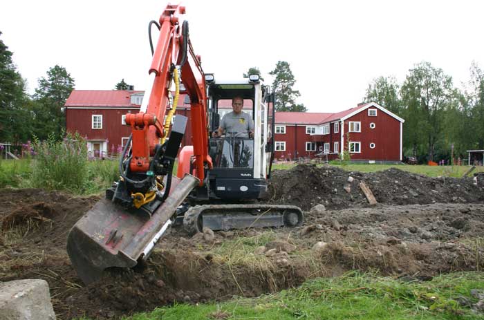

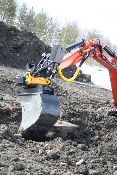

More pics coming, enjoy!

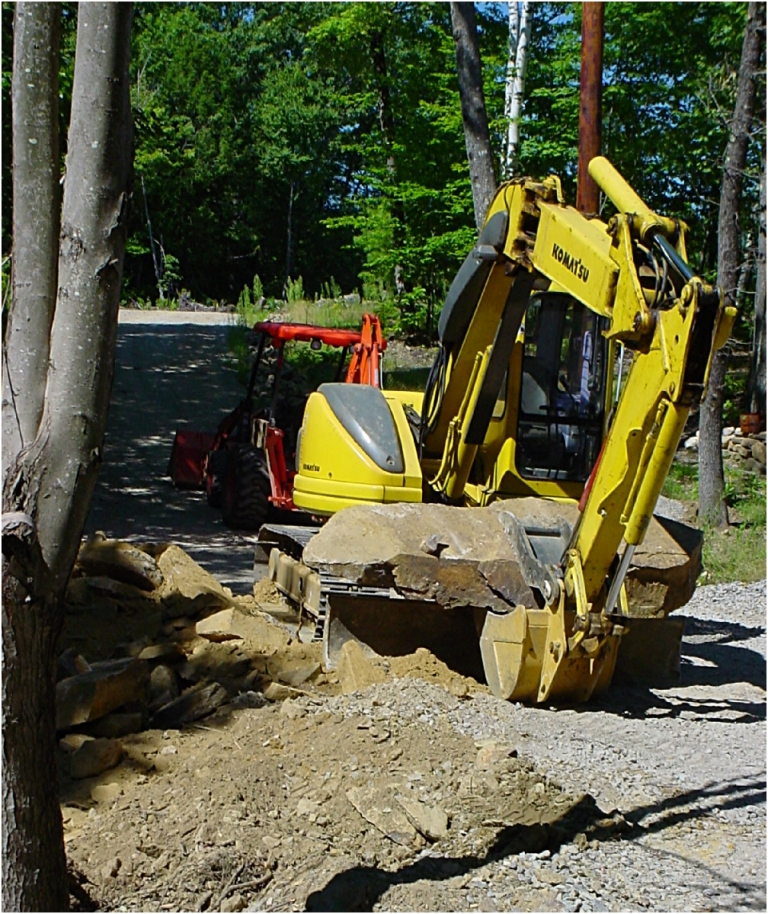

Given the pepples I move with way to small an excavator and little TLB, I'd break that neat toy in less than 10 minutes. I guess it is a nice idea for fine work in loose material, but does not appear stout enough for the business end of a machine.
However, I'd be happy to assist this company in testing and developing their product for "robust" use.
Sorry but its not a toy, they make these for machine up to 32 tons. Of course are you only dealing with big rocks I dont see the point using a rototilt.
It more or less a must this equipment if you want to get a digging jobb over here. Jobs go faster, more precision, and you save fuel, dont need to move your machine all the time.
