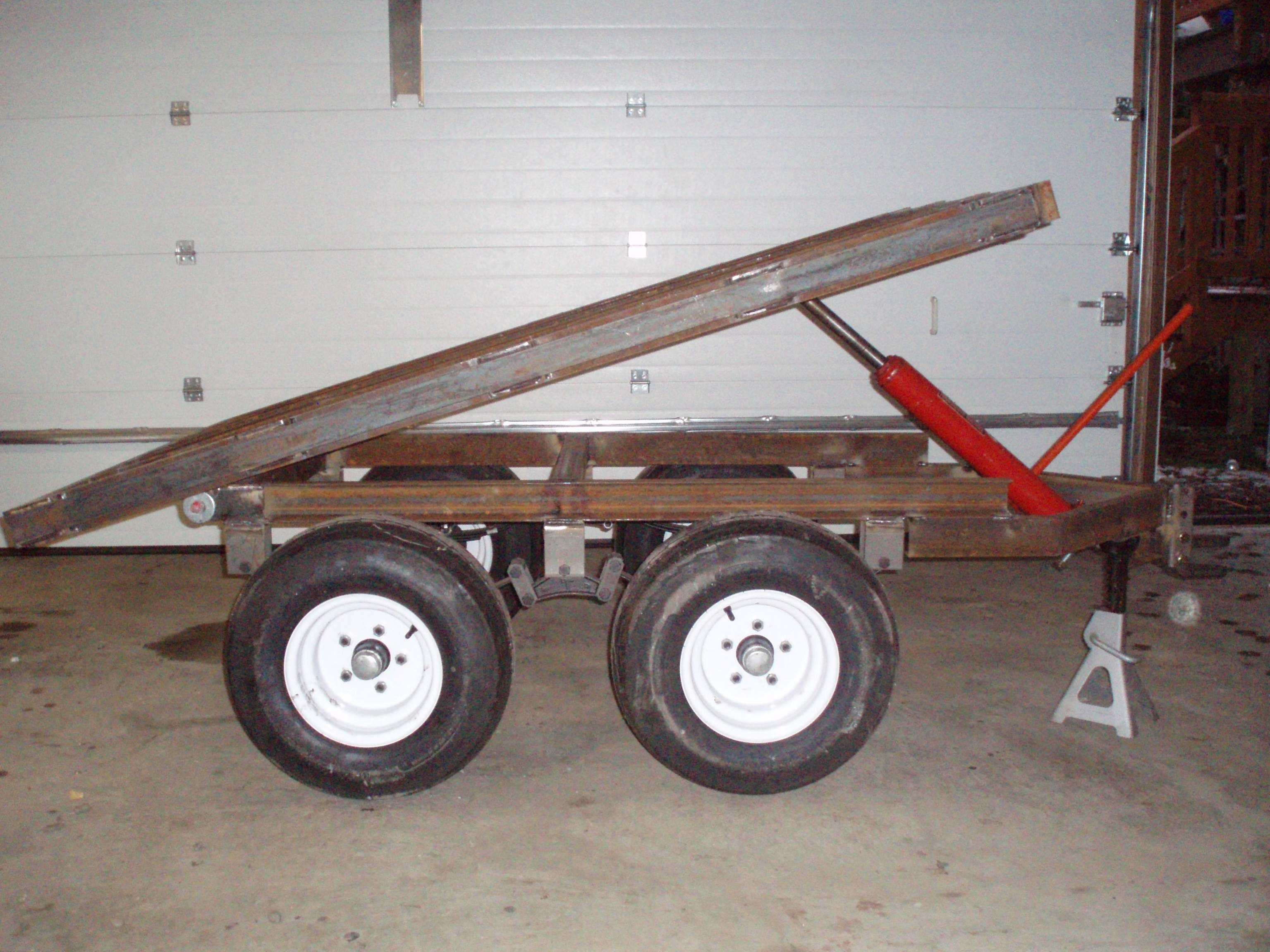

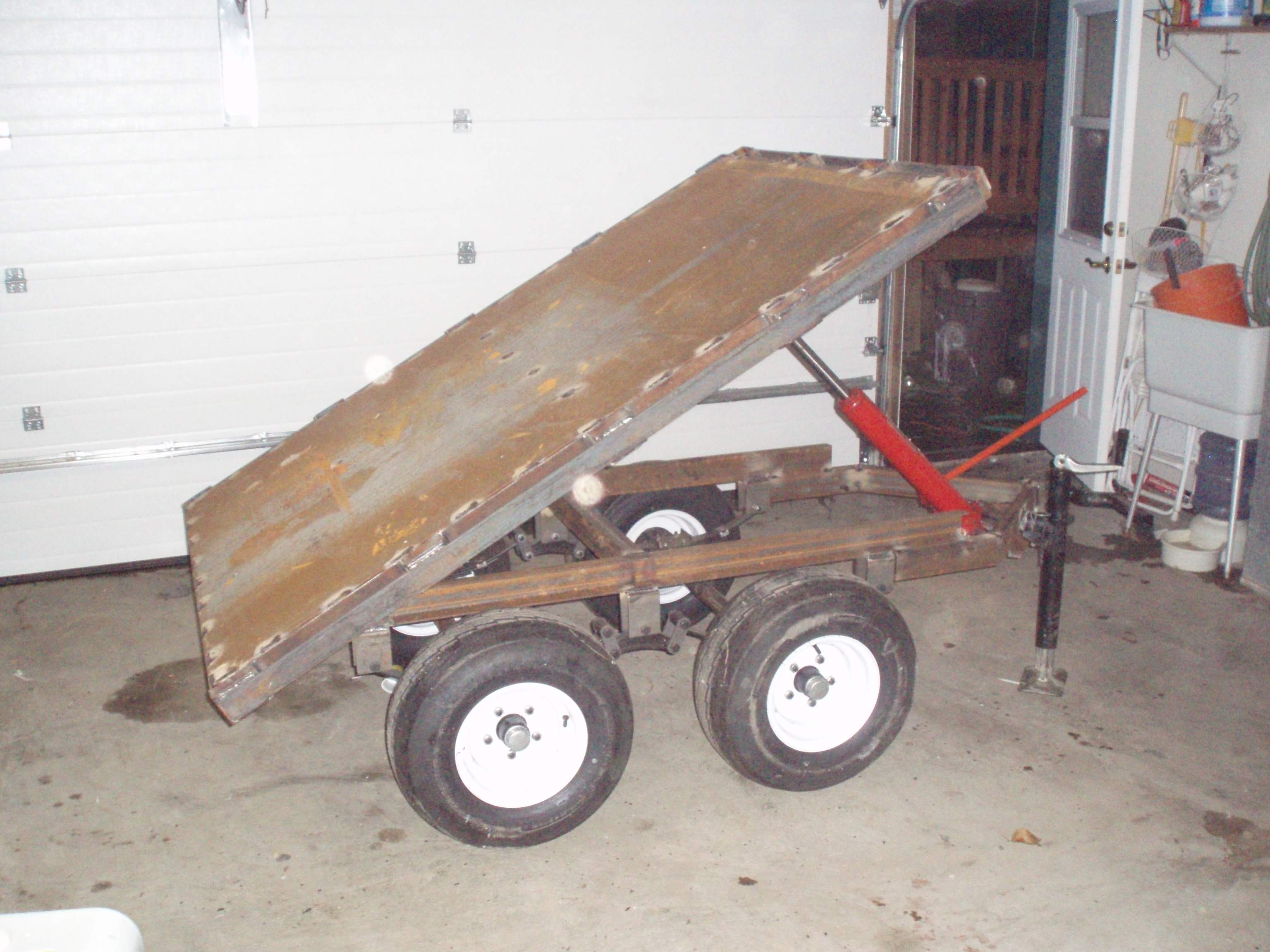

This spring I was laid up for a couple of days and found a ATV size dump trailer for sale on the internet, and decided I could build one. My wife is in to gardening and composting and I constantly need to haul supplies or dirt. We also have several horses and we haul manure out of the paddock every spring. Currently I use my FEL and it has a very small bucket. ( one argument for the new tractor but that is another story)
I started with a couple guild lines.
-Must be able to go behind my 700cc quad(maybe not fully loaded)
-Since my tractor does not have a rear service it needed to dump on its own, I did not want to buy a electric hydraulic unit so I decided it needed to use a log ram bottle jack like on a cherry picker.
-I liked the 4x6 size of the unit on the net sooo..
-dual axles for the tongue weight and heavy loads
- Try not to tie up a lot of cash
So here is the final build before decking and paint
I think that It might work well for hauling firewood to the house and yard chores. And maybe even save my poor tractor a couple trips with a full bucket.

Looks like quality workmanship and a good design. Hats off to you for a good job. What size is the cylinder?

Be interested to see how that handles turns.Seems like you would drag the front tires a lot.

I have a dump trailer and find that I need every degree of tilt it can muster to unload. I think you will find that 45 degrees is not enough for anything offering much stiction (sticky and or friction.) Firewood is not a challenge but dirt, manure, and other stuff involved with gardening will require shovel work if the tilit angle is not great enough.

Answering a couple questions,
The cylinder is a hydraulic jack, the type you find on a common cherry picker, I got this one for $35 at a garage sale a couple years ago, and now I can tell my wife "see I do use the junk,er items I buy and store".
The tires are wide snowmachine, quad trailer style, and the front does scuff on tight turns, I already see that a longer tongue is needed. But was concerned about being to big. I thing I cut this one to short and thing another 12 to 18 inches are needed. How is my next issue.
Now to the big question, will it dump dirt, Not very well is my guess. I used to work in gravel pits and ready mix plants. Several reference books list the tipping angel of earth as 30-32 degrees. Yet every dump truck and trailer I have used has lifted much more. I hope that the angle will be enough to work fair. I used a metal floor and have read a couple threads about slick paint helping. I also have glacier silt, gravel and sand for soil so I hope this will help.
As a note, I placed a rub on three sides. hopefully I can use simple side boards to stop every thing from just dumping

I see a problem besides not having a steep enough angle for dumping dirt is the back end of your dump needs to be at the end of the pivot.
I have repaired many homemade dumps because the very back is past the pivot point of the dump. The entire load may get hung up and rest on the overhang bending the frame of the overhang.

The frame does need to be beefed up that is for sure, I have to add some bracing to mine when I can get around to it.

Need to change something, thought you guys had doubts as to the deck, now I see you were referring to the frame. the frame is box tube with c channel. One thing is the rear spring mount goes to the back of the frame and just misses siting under the hinge. I could have built it heavier, but worked hard to keep it light, and since it is a yard trailer i think it will hold up

Only thing I would change is to have more tilt. I too have seen stuff stick to the bed where a little more angle helps get it ALL sliding off. How much do you think it will hold when you get the sides on ... a yard or so ... maybe a little less?

I agree with Rob, more tilt, for sure. Go for a minimum of 60 degrees. (90 being straight up/vertical).
