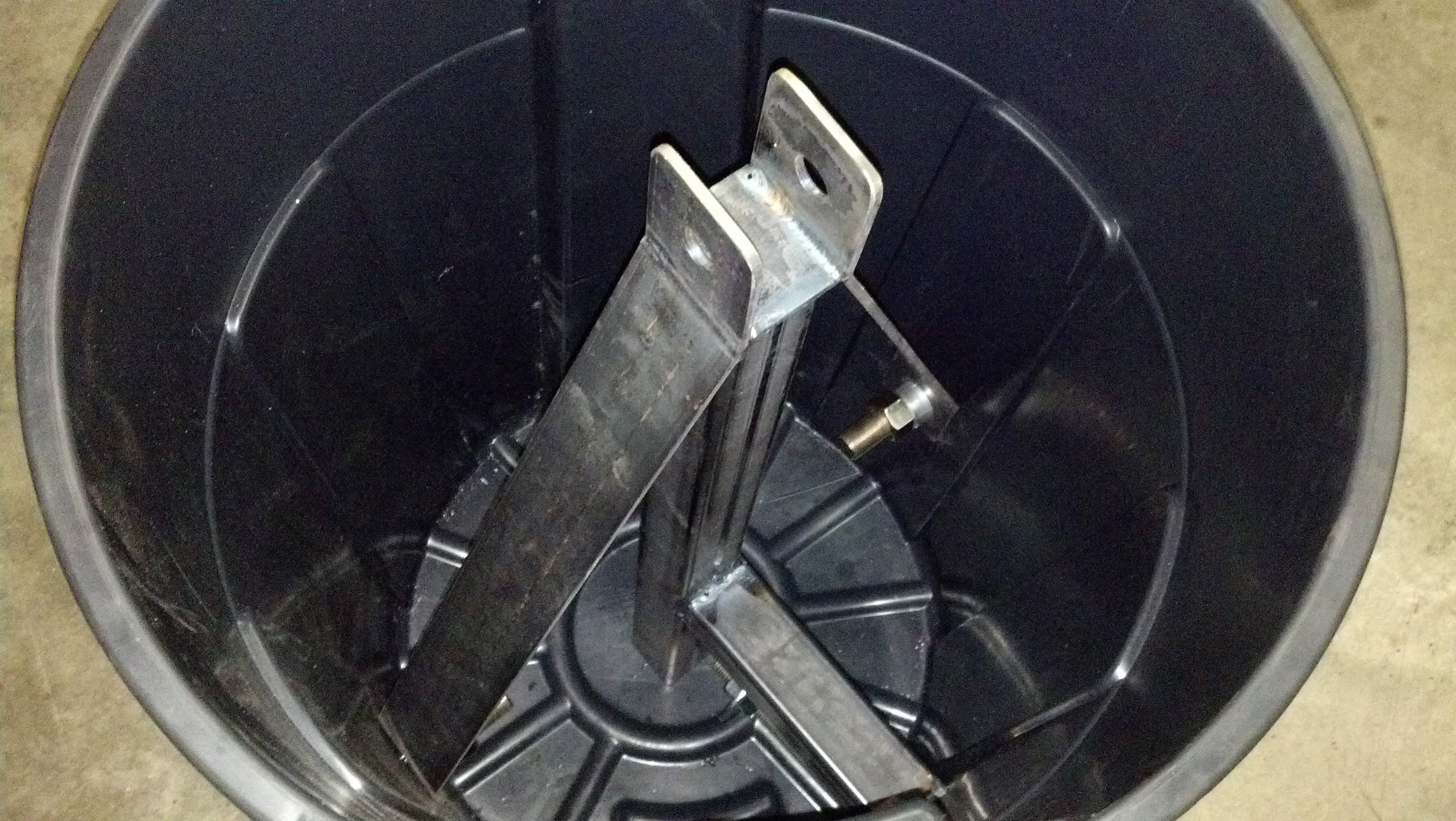

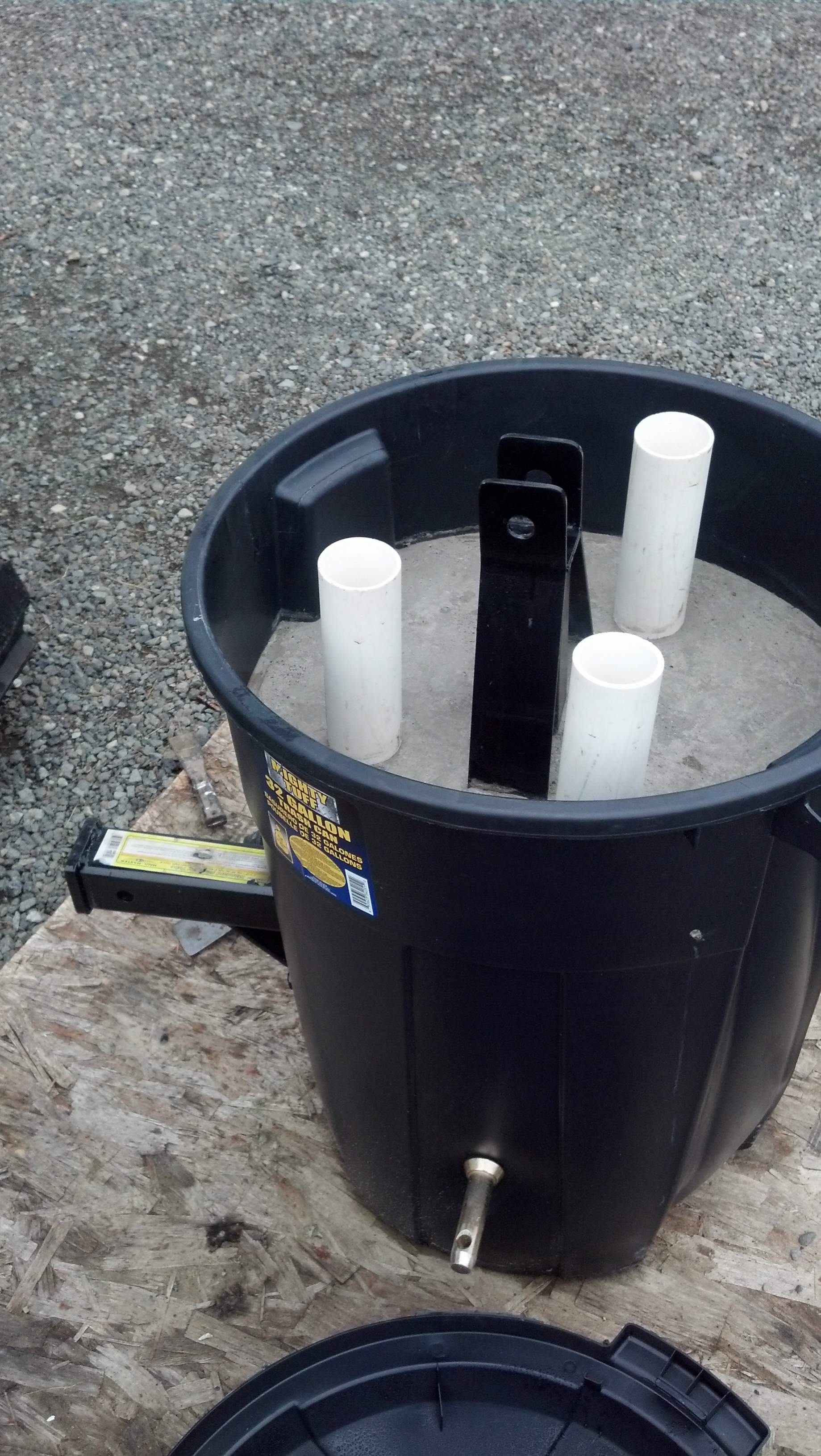

This thread has been very helpful, glad I found it before making my counterweight. I fabricated the frame with 3/16" flat stock and 2x2 box tube. I used a trash can so I could put the lid on it when storing outside. In hind sight I wish I'd have used a 55 gal size barrel due to now having to adjust the sway bars on the tractor. I used threaded pins to bolt through the side of the barrel and lubed them up so if they break or bend I should be able to unscrew them and replace, (in theory anyway). 084.jpg077.jpg081.jpg074.jpgI also picked up a cheap receiver from Harbor Freight and mounted it off the back. The pvc pipes have a screw through them to hold shovels etc as I'll be drilling out the bottom for drainage. I used six sixty lb bags of Quick Crete and combined with the frame the overall weight should be approx 400lbs. That is what my tractor manual recommended for max weight. I might have to cut a slot in the barrel for the stabilizer bar when it's raised. Just letting the concrete harden for a few days before I try it out
