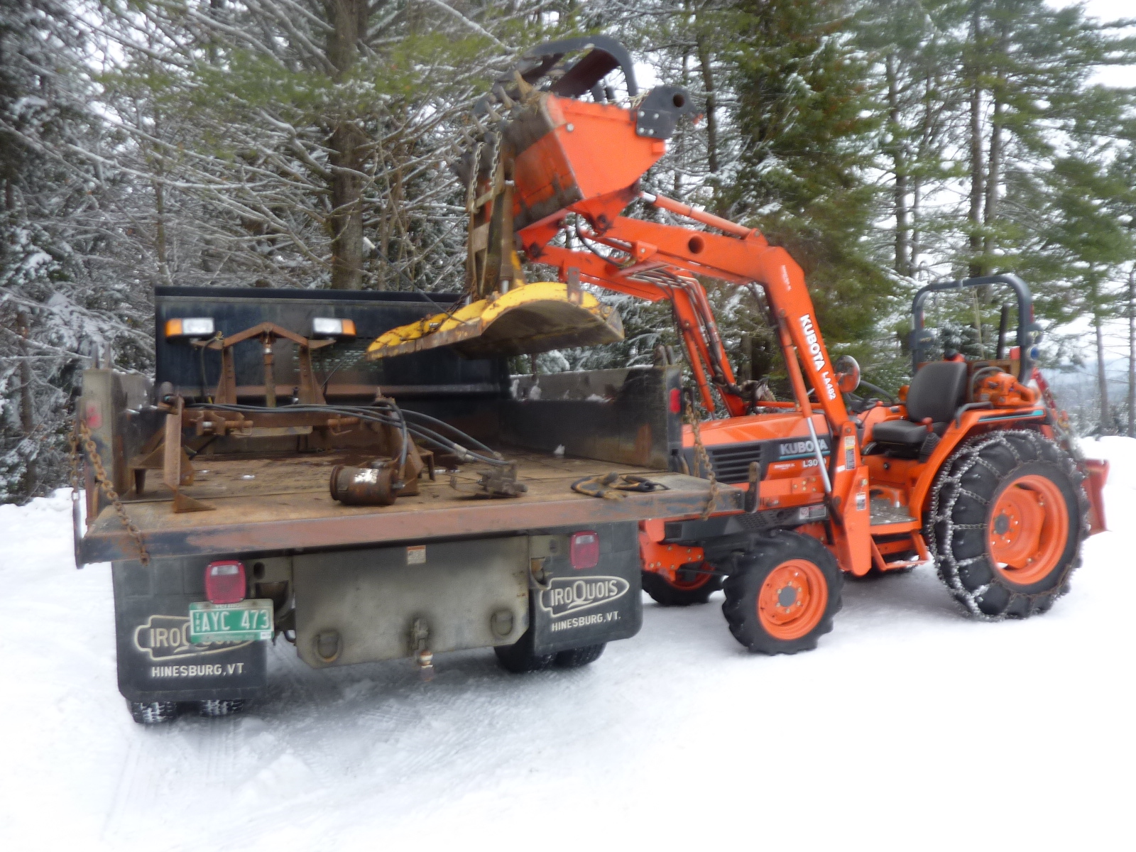

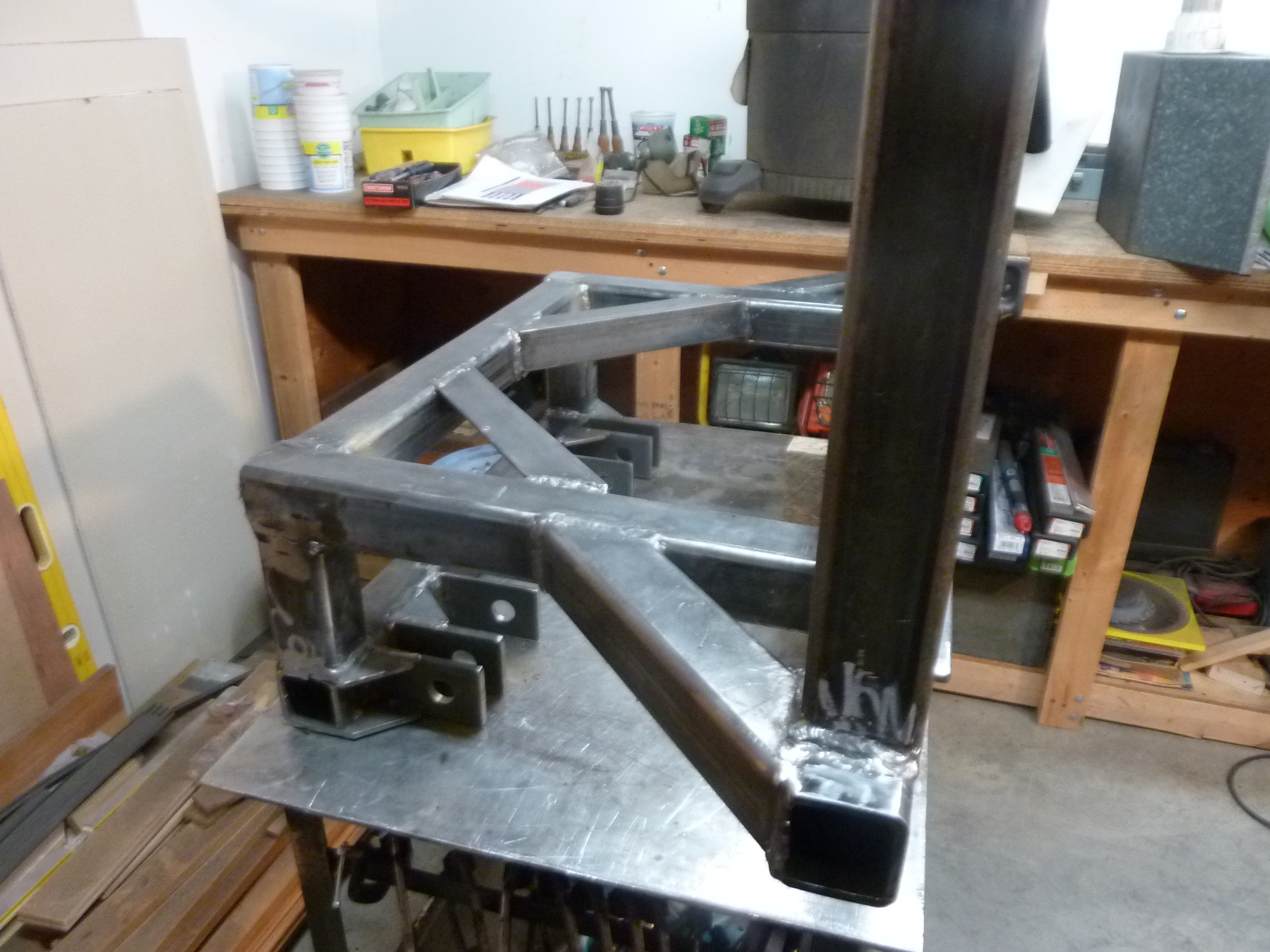

I wanted to put a plow on the M5640. I found a guy who wanted to restore a '91 F150 and would give the plow to someone who would take it off the truck. So I did. The plan was to sell the pump, valve/control, head gear, and truck frame parts and start out ahead but that hasn't happened.
I really liked the concept shown by TractorNH in this thread: https://www.tractorbynet.com/forums/build-yourself/401291-snow-plow-build-finished-underslung.html and decided to build with that idea. Here is my version

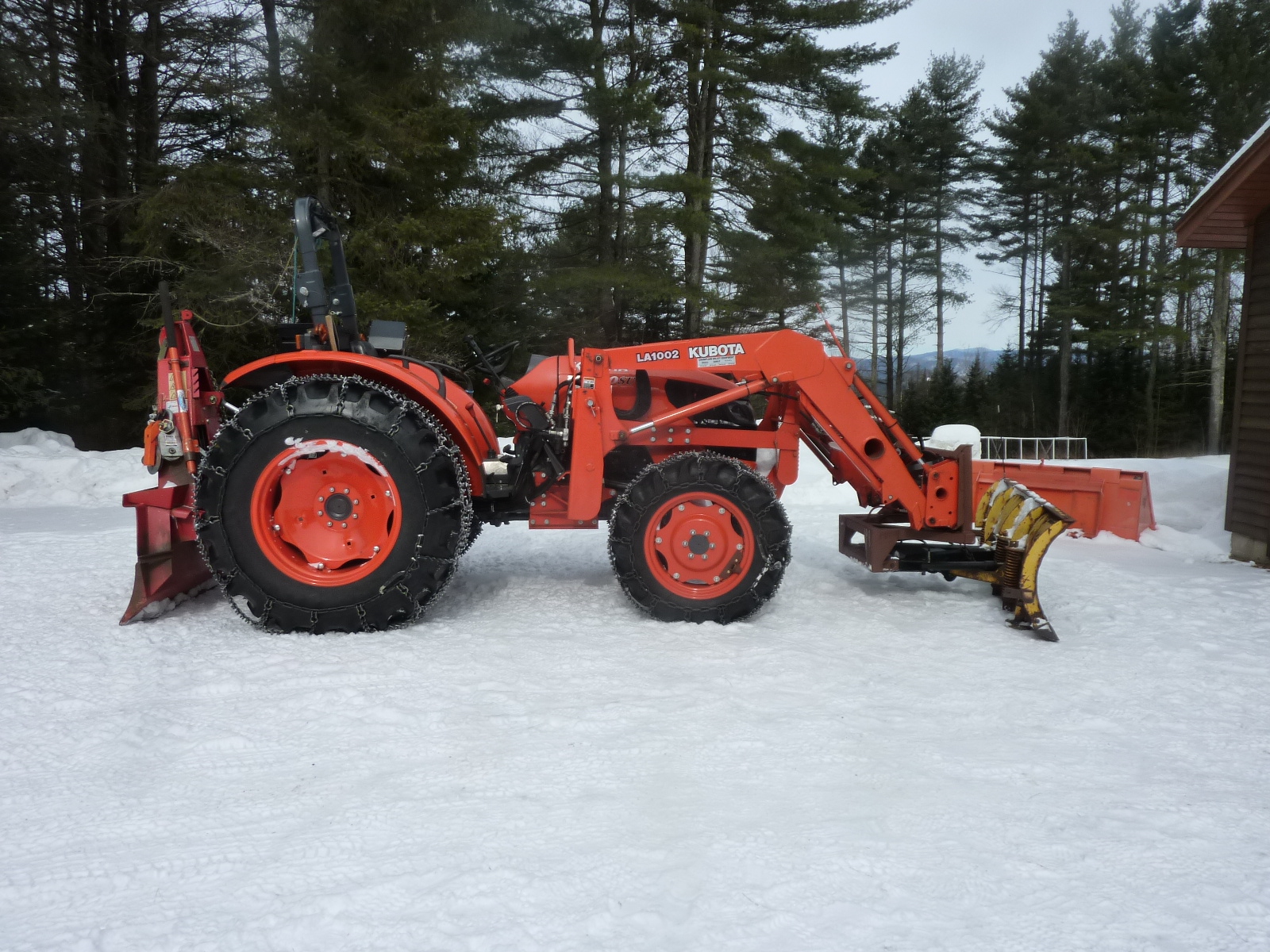

For my use I saw these advantages: 1) Plowing - The blade rides along and follows the road surface under it's own weight just as it does on a p/u. I have a long irregular gravel road. A plow with a solid SSQA attachment would be a problem for me. In float the weight of the FEL is on the plow making it very heavy which is not good on a unfrozen gravel road. If you take the FEL out of float you have to constantly control the blade height. No problem on a flat drive way but very difficult on a long rough road.
2) Better Steering- Because the blade is set back and not way out front less side leverage is applied to the tractor when plowing with an angled blade which is the normal mode for a long road. And, the weight of the loader arms and heavy SSQA frame hang out front and put extra weight on the front tires for better steering traction.

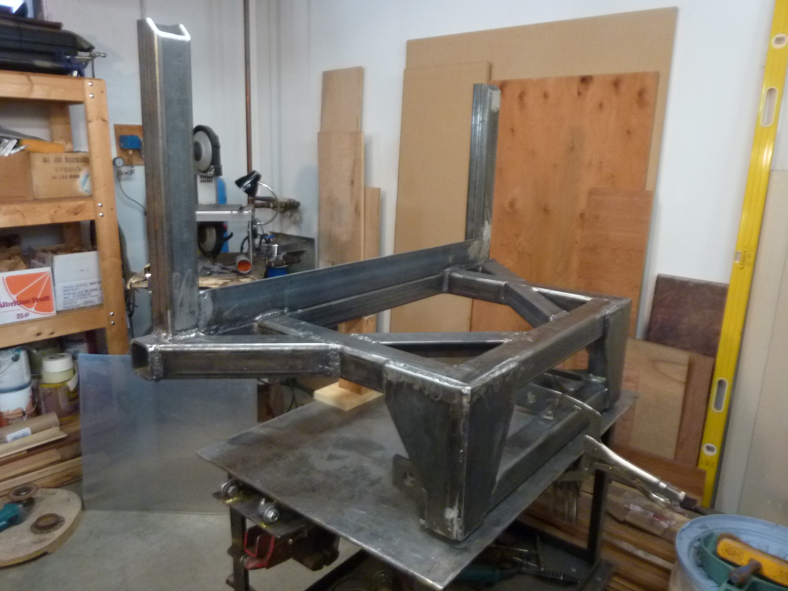

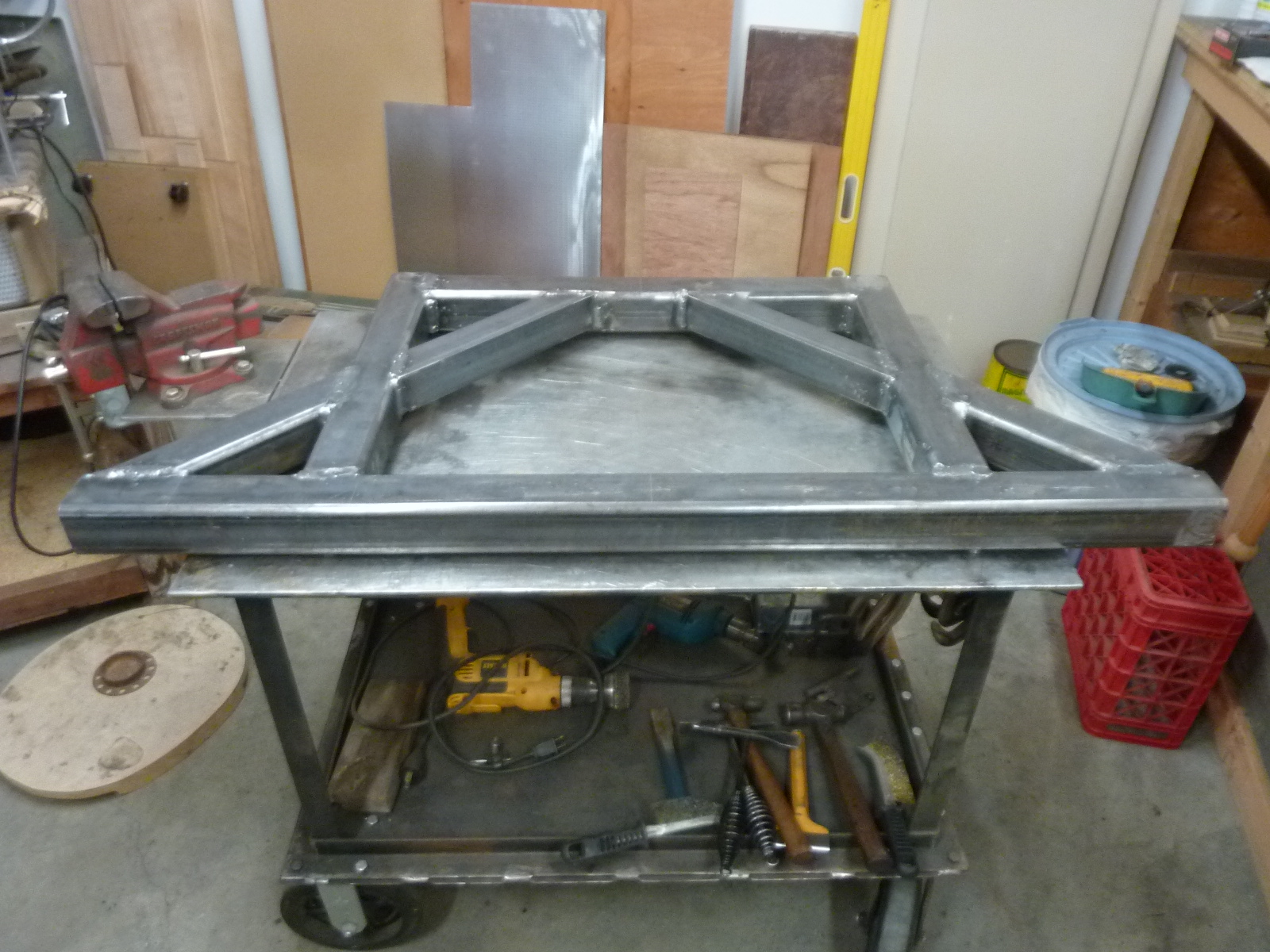

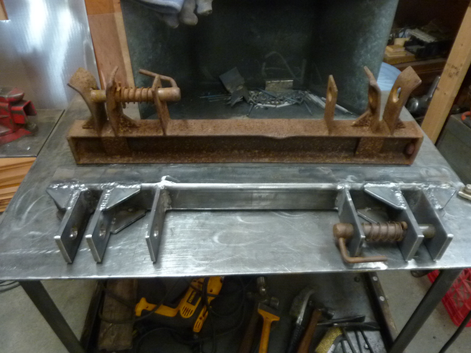

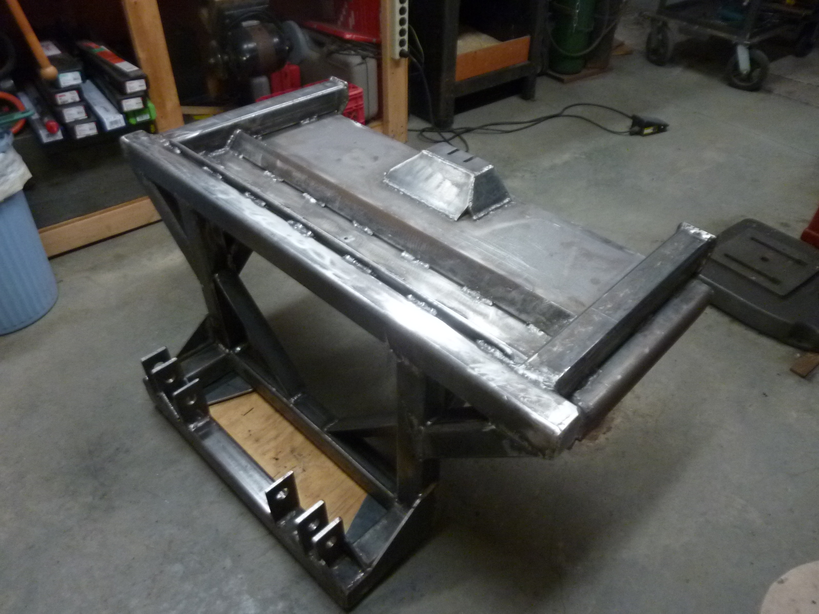

This is how the build progressed. First I built a new push beam. The old one had seen better days.

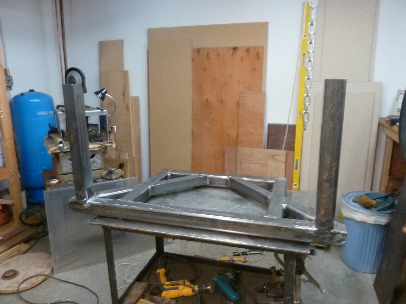

Then the basic frame. I plan on serious plowing with a heavy tractor that is not easy to stop so I think that I made it strong. But I really have no clue about what is strong enough. The square tubing is 2-1/2" X 1/4". The angle is 2" X 1/4". Same width as the push beam and as deep as I could and still allow the plow to angle fully.

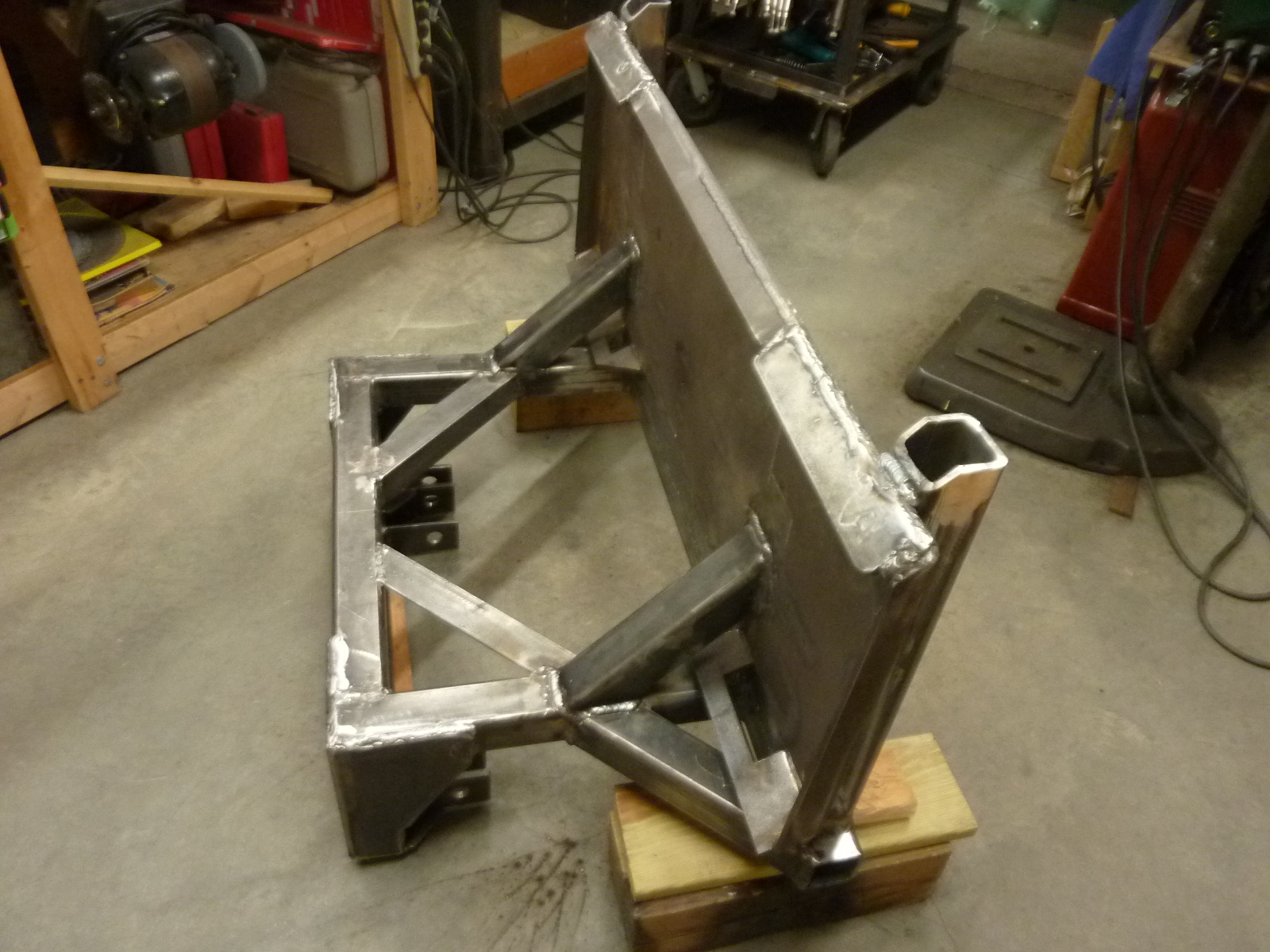

Two posts for attachment to the SSQA plate and line up with the loader arms and tractor SSQA push pads.
Welded on the new push beam.

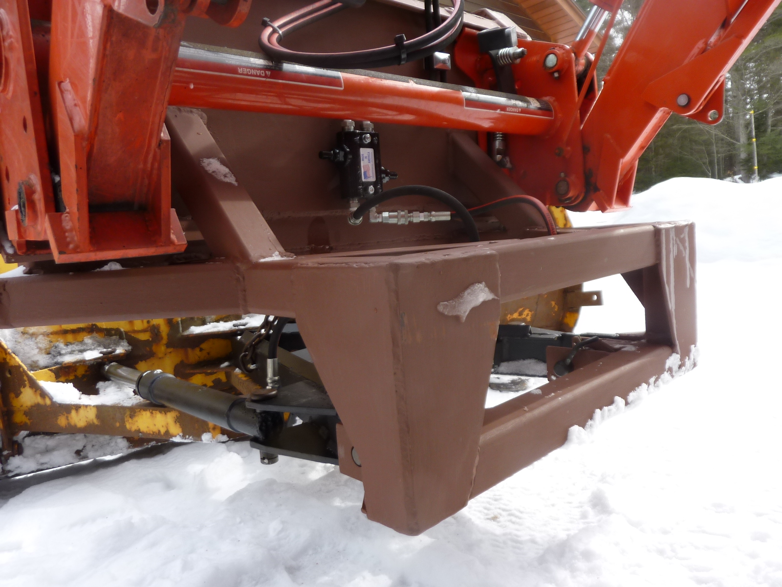

And added some corner brace plates plus a length of 3" X 3" angle between the two posts for a weld point across the bottom of the SSQA plate

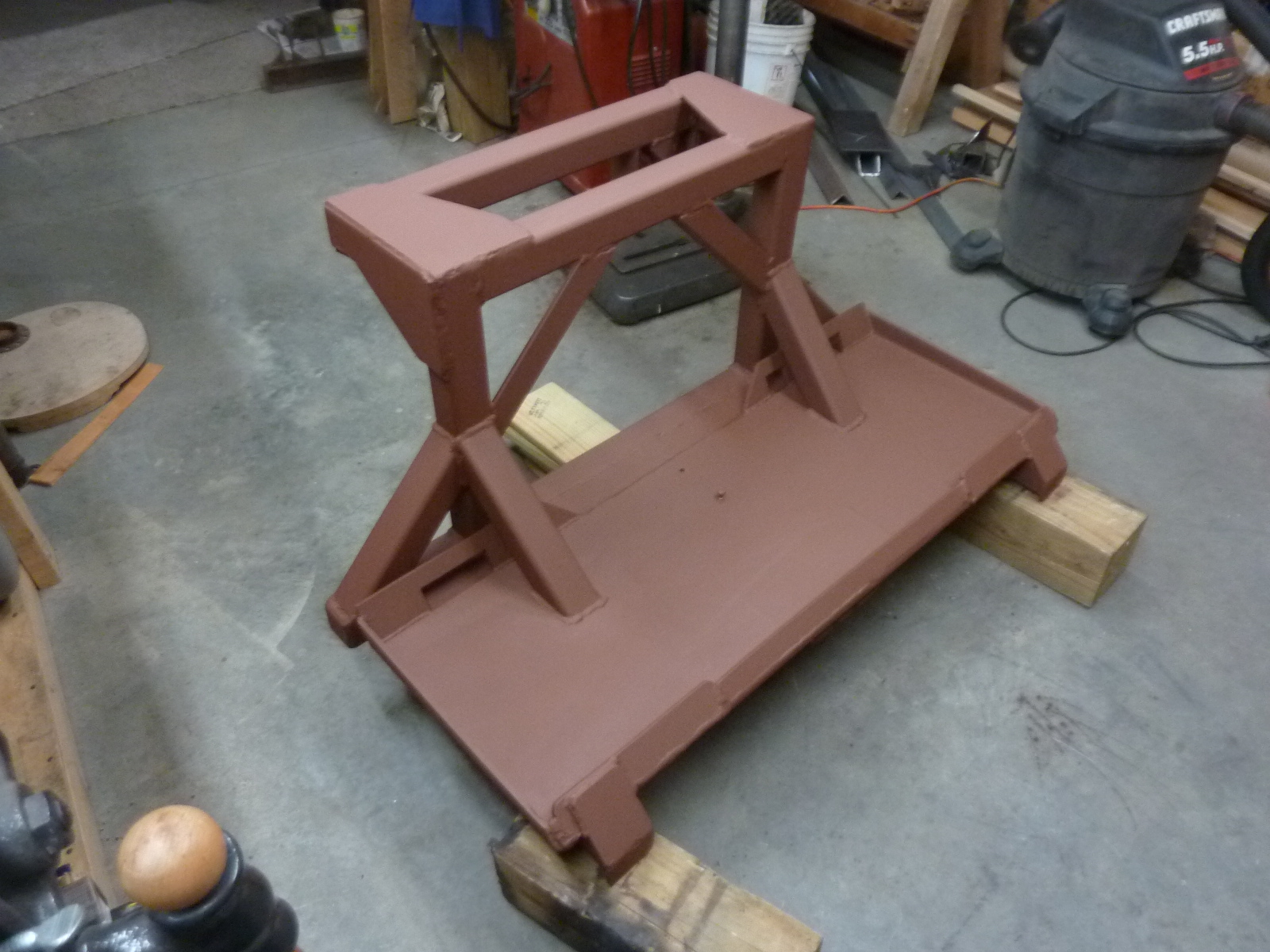

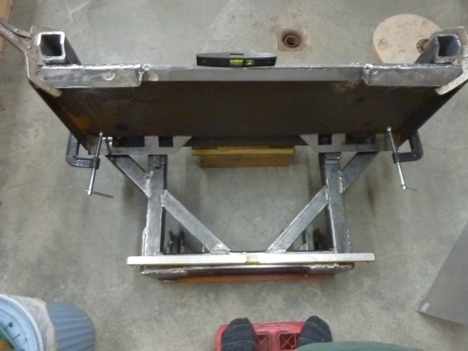

Set the SSQA plate level to the push beam

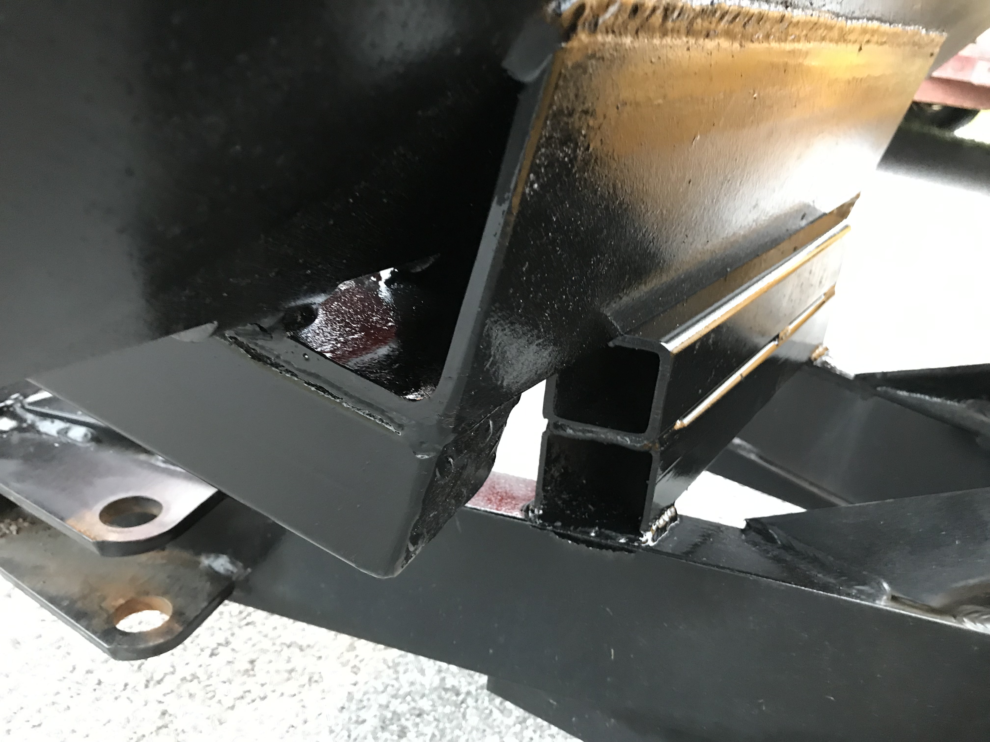

Added some angle braces - frame to SSQA plate

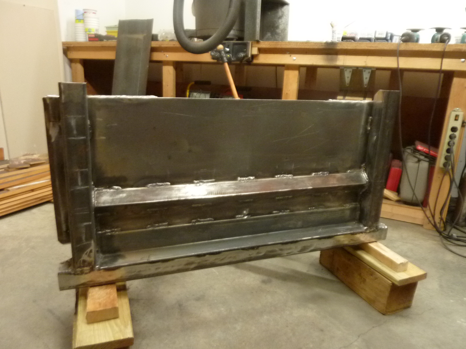

A stiffener across the plate to catch the angle braces

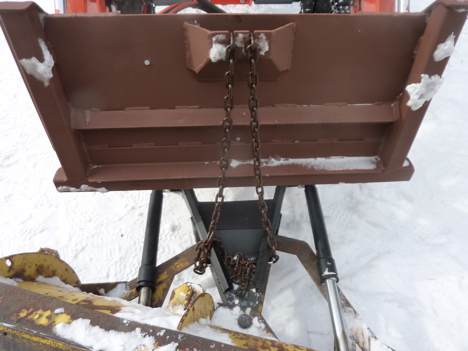

Made an easily adjustable attachment point for the lift chain and storage for the loose slack chain.
Finally some primer
The hydraulics include a pair of flow control valves and a cross over relief valve

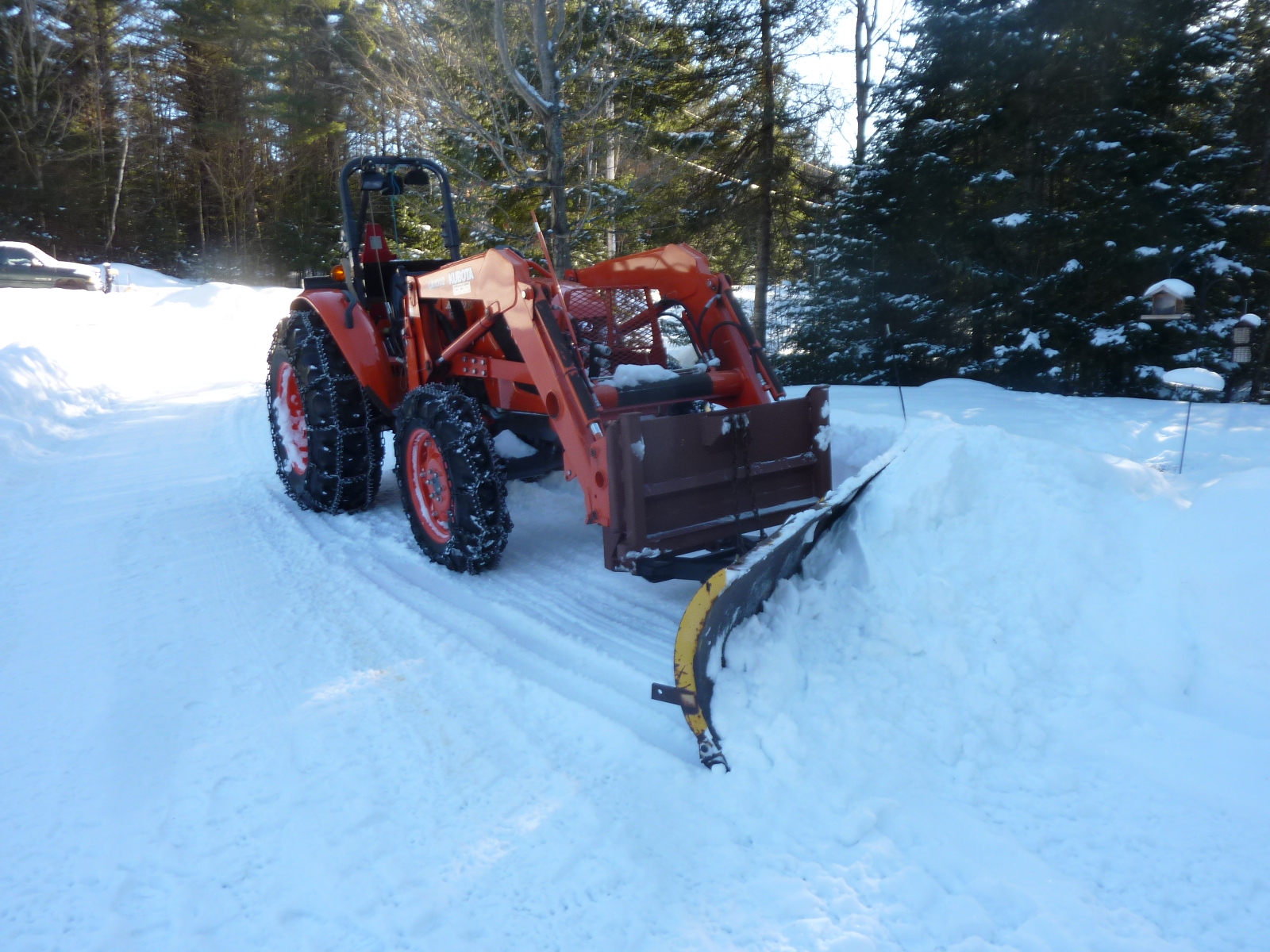

Mounted on the tractor
And it can push snow. Harder than my one ton actually.
I know this is overly complicated compared with most designs but it just happens to be the way I did it or how it turned out. Just take it for what it is.

It does look good and well built. It will be interesting to see what tweeks it may need as you use it but it looks really good at this point.

The hinged chain style works good in places that don’t see the ground freeze, and stay frozen all winter- in that case as little weight as possible is best to prevent digging. On the other hand, in places that stay frozen having extra weight tends to help scrape down to an inch or so of the road surface by riding on shoes and using bucket curl to get the proper cut angle.
Your build looks good! It’s always satisfying to build something and then enjoy the product- especially one like this that looks like it will last for many years.

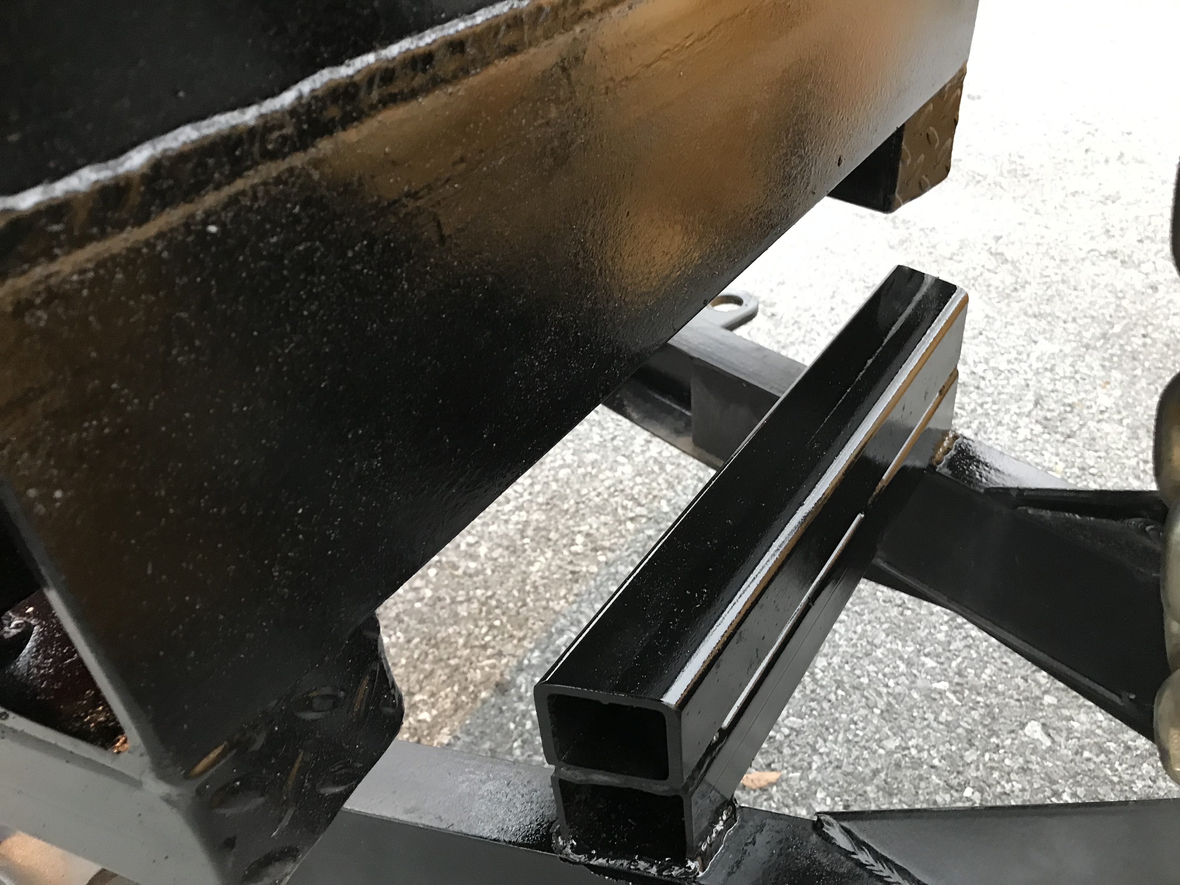

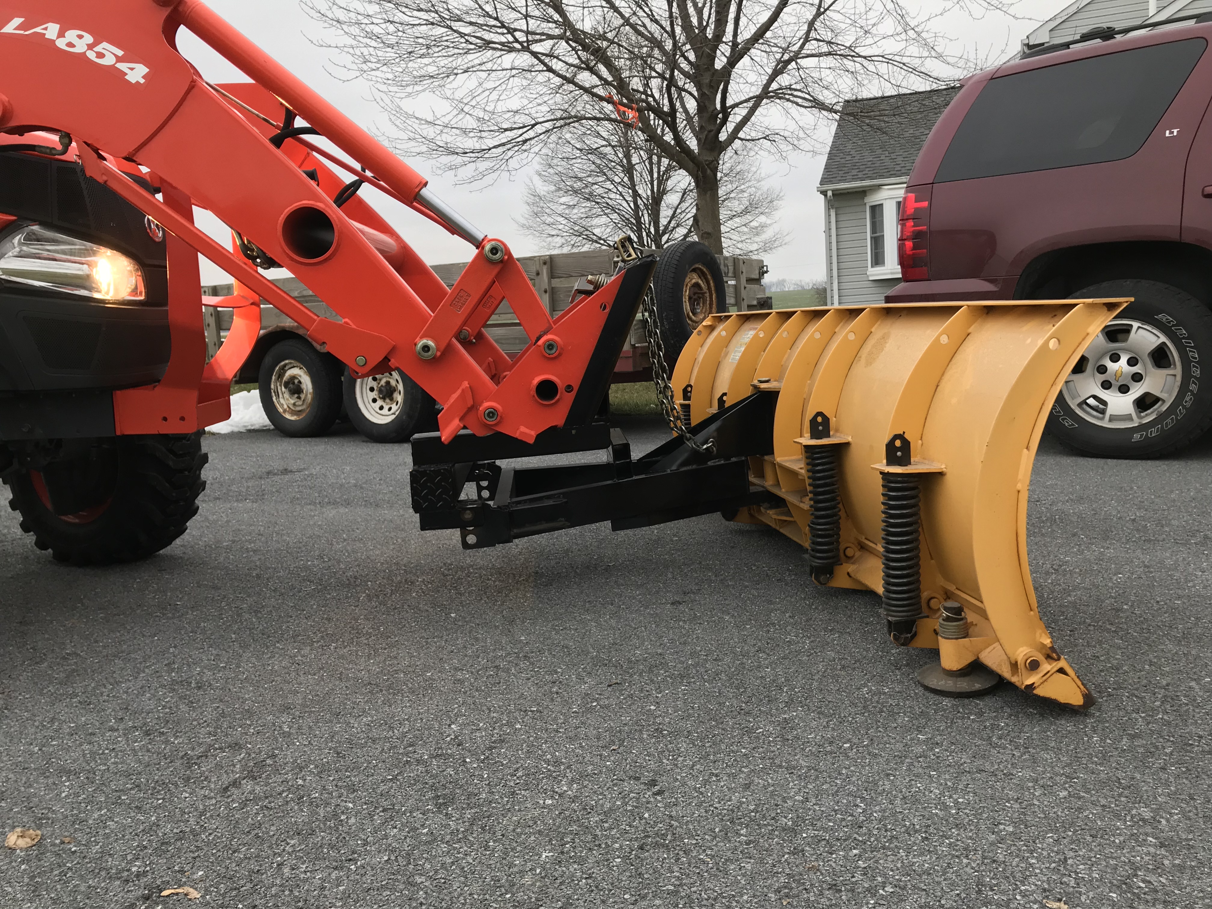

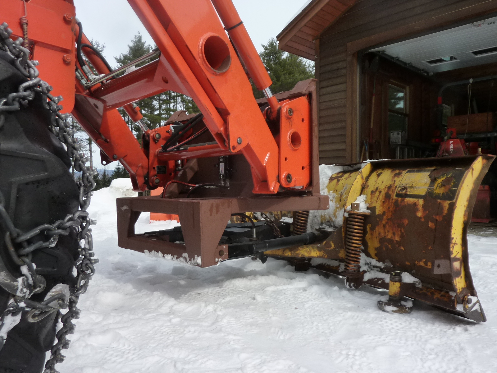

This mounting method doesn't pose a problem. With the hinge and the chain, the blade can be used three different ways. The pictures below were taken before the hydraulics were hooked up, but you can see the relationship of the pieces.
1. Weight of the blade only (FEL arms held in a position that allows slack chain and hinge to function. The left picture shows the slack chain and the center picture shows the gap between the SSQA plate and cross member)
2. Weight of blade plus FEL arms (FEL in float mode, and the SSQA plate bearing on the plow frame. Right picture shows SSQA plate down against the plow cross member)
3. Down pressure applied (Using FEL arms to press the SSQA plate down on the plow frame, Again, right picture)
Also, by dialing some "dump" into the SSQA plate with the FEL arms raised slightly, the plow can float and the edge of the plow can backdrag away from a garage door nice and clean.

Thank you all for the comments !!! And like chim explained this is a very versatile mounting arrangement.
Light float with just the blade weight, heavy float with the blade weight plus loader arms and SSQA frame weight, or down pressure. Just set it up from the seat by adjusting the SSQA angle and height for the snow conditions, steering conditions, and type job you are doing.
