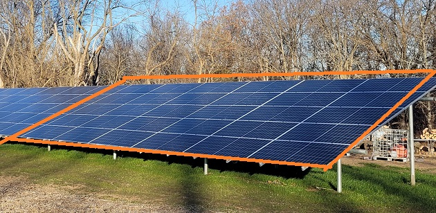

<snip>On another slant -
Has anyone seen a good DIY solar carport implementation? If so any good links?
I've got to replace a carport that was about 20x40. Basically I need to roof over the area to keep stuff underneath protected from the Mississippi sun and rain.
The previous carport was only paneled down on one side so I'm not looking for a complete enclosure.
I could orient it in a solar friendly angle.
But I'm thinking those big panels on frames could easily be adapted to a carport roof.
And I am thinking the carport isn't wind rated enough to add solar panels to it and withstand a Cat 1 hurricane or even close. I hate the idea of adding solar panels just to have them blown away at the first hint of a storm.
You may have a substantial carport, but I am envisioning one of those kinds like a lot of people are installing these days that just bolt to a slab in a few hours of time.
David from jax
No, I was thinking of a solar install with parking underneath.
This was a nice site to see this morning. I know of 2 people that lost panels last night. Lot's of downed fences, trees, etc. Highest wind gusts recorded in our area were 85 mph. We never lost power but the outage map showed 27,000 without last night.
What I was thinking of was building about this much solar panel, 5' to 7' off the ground on the low end (south) and whatever on the high end (north).
attachment try 2
With a little (2'? 4'?) extension of metal roof on the north for additional rain protection.
The entire structure would be built to "solar specs", (wind rating and snow/ice load) over the present parking lot.
   / A newbies DIY solar install #168
I had thoughts of having my ground mount be up higher so that horses could use it as a sun shade in the summer, but the standard mount needs to be installed near the ground and raising it would completely change the engineering calculations for wind.
There obviously exist these things (local businesses have large carports of solar) but considering the prices I'd definitely get something engineered even if you DIY the work.
I wonder about that too. I've seen where animal or tractor shelter where it's regular construction with rafters, and also purlins going across the rafters, with the panels screwed into both the rafters and purlins. The panels acted as the roofing material. Good ventilation below and some protection from sun and rain.
