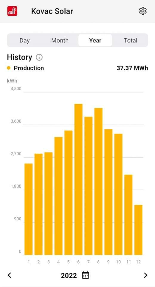

   / A newbies DIY solar install
#247
Update.....hard to believe it's been over a year already. Here's our year end solar results One pic showing our 2021 electric bills for our all electric home including heat without solar compared to 2022 with solar. 4,400 sq/ft of conditioned space. Also another pic showing production by month. Really happy with the first year results.
Some quick highlights.
1. Savings 2021 to 2022 was $3906.
2.. Total electric bill for 2022 was $751 or $62/month avg. 2021 was $4657 or $388/month avg. (Nov & Dec 2021 bill was changed to the cost without solar as we started it mid Nov 2021)
3. Of the $751 for 2022 $465 was our monthly connection fee so we actually paid $286 on the year for usage.
4. Payback on the system if savings stay the same around 72 months. Less if rates increase.
5. Total system production for 2022 was 37,370 kWh
   / A newbies DIY solar install #248
Solid investment. As we knew it would be. Great work!
