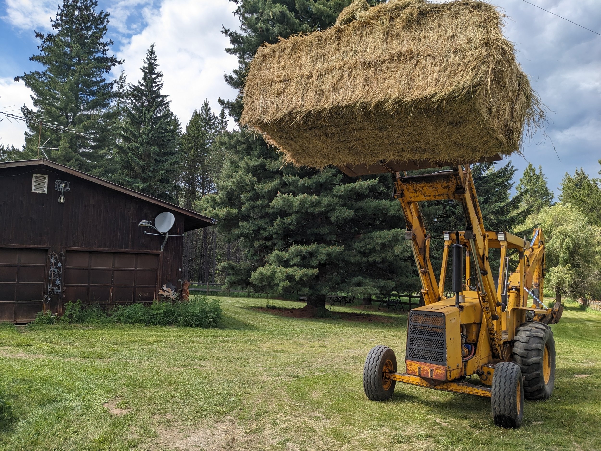

Needed another tractor to move large square bales off of my trailer since we have been picking up and load hay with our own equipment in the growers field.
Hoping this works as a way to unload my trailer instead of tying the load to a big stump putting the RAM in 4 low and dragging the bales off the tilt trailer.

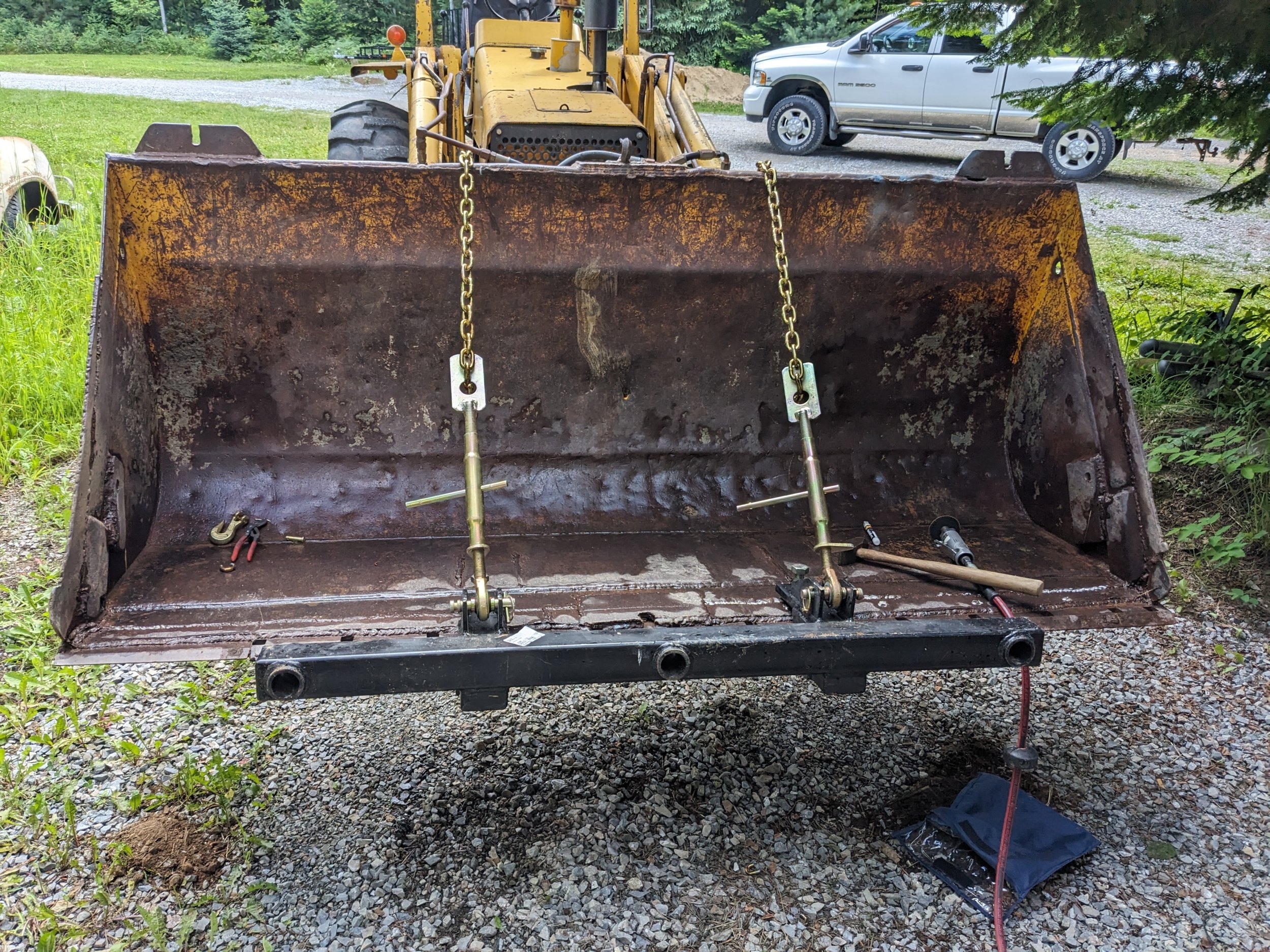

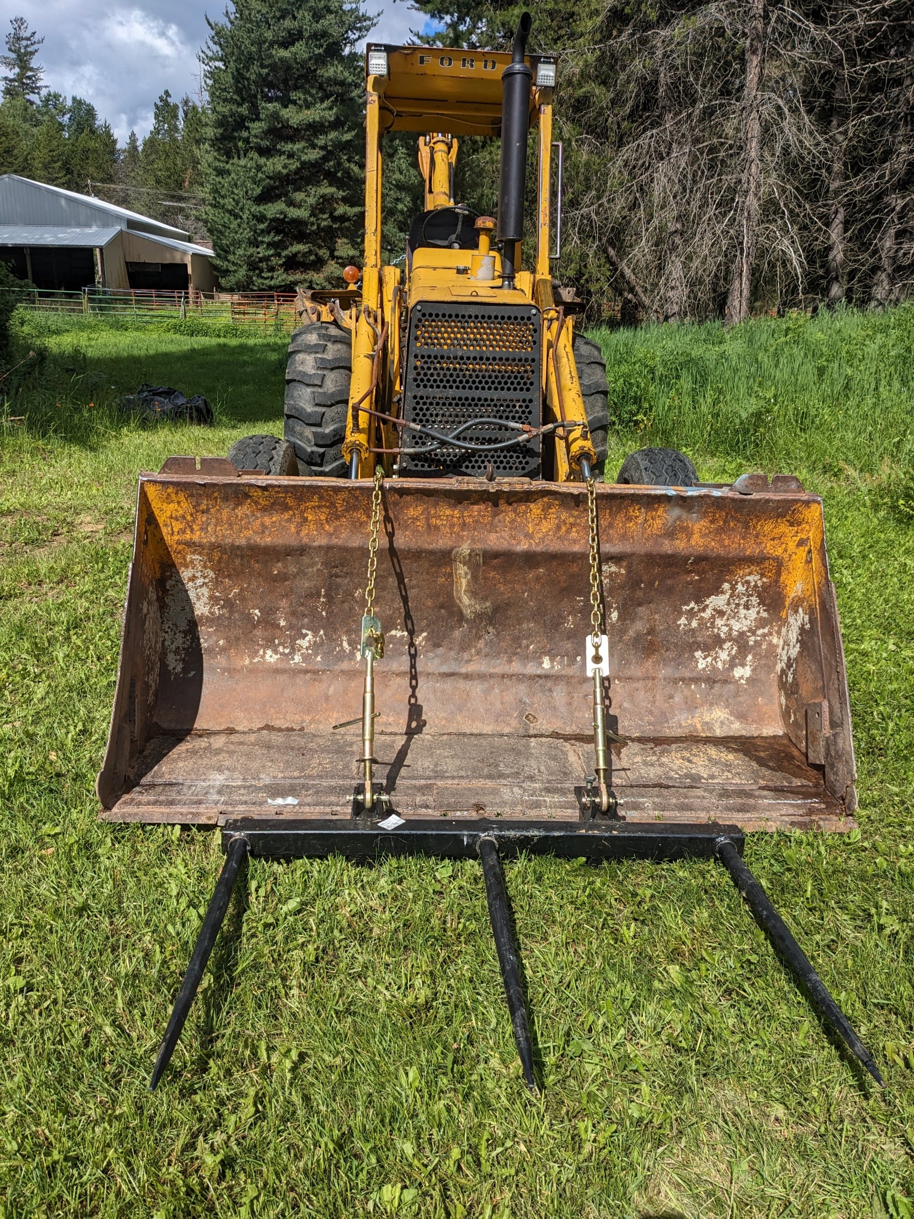

Ordered up a 3 spear chain on bucket bale spear from Neat Farms / attachments for my old Ford 550 TLB.
Chains on and also has large bolt thumbscrews to lock the frame to bucket edge.
rated for 3000lb this should work for moving unloading and stacking 3 X 4 X 8 squares.
Should also be handy if the other tractor is down and a bale needs unstacked.

The metal thickness is Much heavier in this Neat attachment will accept a 2 inch thick bucket bottom the thumbscrew bolts are a 3/4 inch thread and the bare frame weighs at least 150 LB IIANM
I would not own a bucket add on attachment that relied on thumbscrews Only
The chains around the bucket add a whole lot of rigidity
We will see, Nothing is for sure until I get a 3 x 4 x 8 square bale on it. I do almost wish i had noticed they offered longer tines than the 39 inchers that I got.
My biggest concern is the actual width... if the bales SAG on the sides there will be some attachment mods additional welding and Tines added. :)

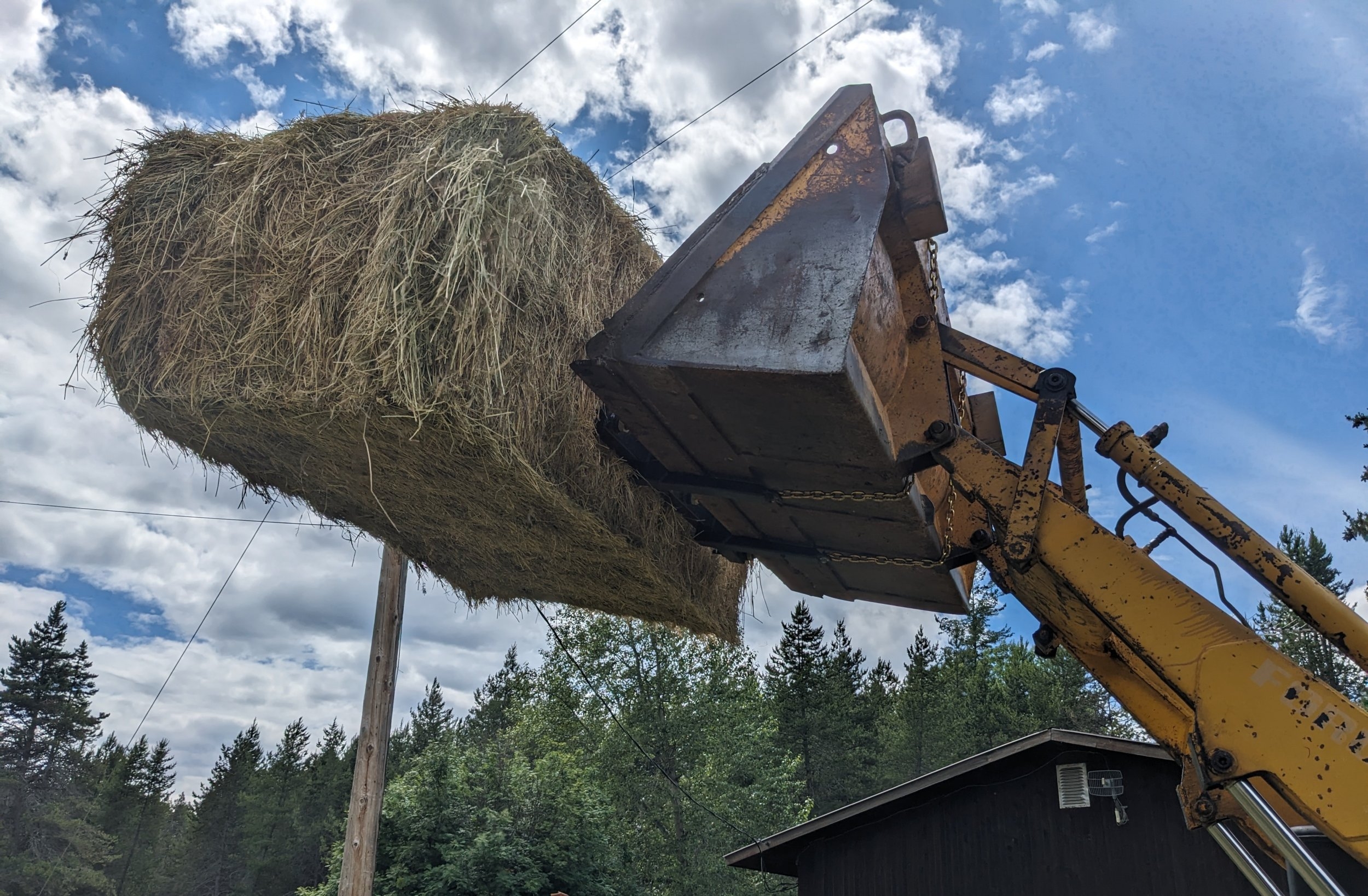

your bucket does seem pretty substantial but I would be worried about bending the top lip down with a large bale especially considering how the geometry of that attachment is.
/ A "Neat" large hay bale solution for TLBs
That bucket is really beat up but it is the heavier industrial version of the two Ford offered back in the 70's for the 550.
the bucket is 87" wide and weighs over 700 lb.
I seriously doubt the bucket will give much.
Ford always seemed to use hard steel back then.
Seen lots of cracked Ford stuff that needed welded but very little where it bent distorted and tore like mild steel does. There is a hole punched through it though

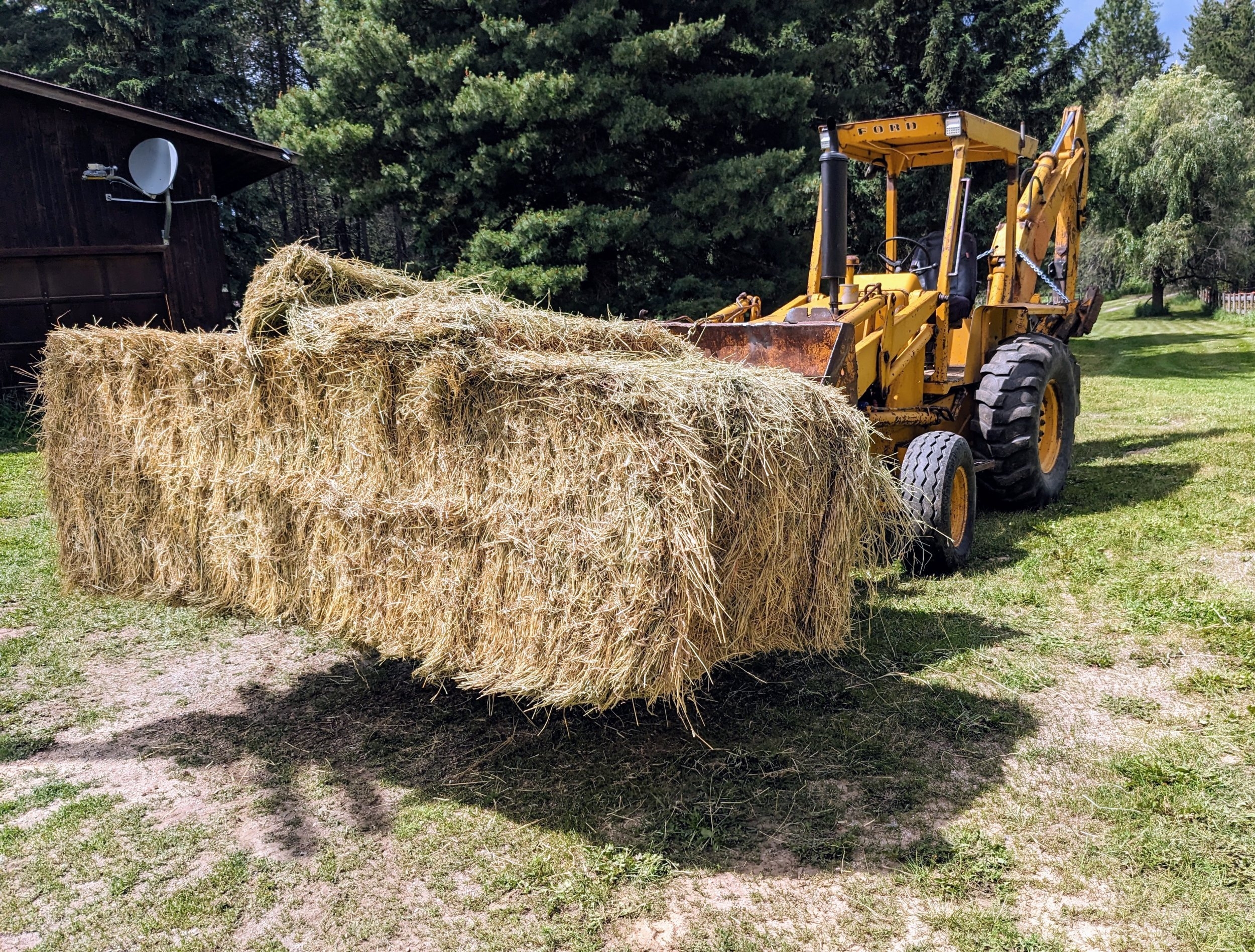

Doubt I will need to but think I could stack 4 high with this set up.
After a quick test No complaints so far-
I LIKE IT.
Also very handy that the TLB has the self leveling FEL.
Much easier than the Grapple on the Rhino to keep a bale oriented tilt wise.

Update well the hay is Home and my plan to use two tractors worked.
Transported the Rhino to the hay field and then loaded 6 bales on per load using the Grapple by removing all but 4 round tines.
Once home fired up the TLB and unloaded the trailer.
Round Robin till the final trip picking up the tractor.
This bale spear attachment works great!
For the first time I was also able to completely unload the trailer from just one side because the 550 has such a great reach with the FEL
