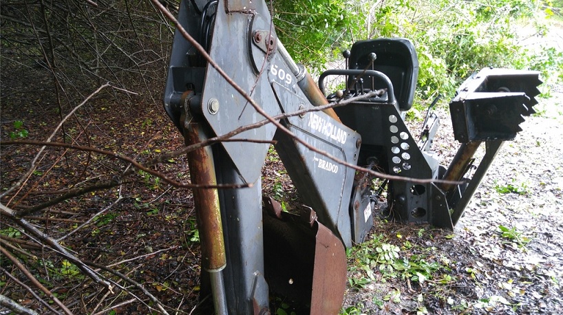

I also found a Backhoe that I'm probably going to get... It's a Bradco 609. It's been sitting out for years, and a bit rusty, but the price is very right, so even if I have to paint it and replace a few hoses, I think it's going to work. It's set up for a New Holland skidsteer, so I'll have to build it a subframe, but it'll definitely get the job done!
Great - sounds as though that military-spec guard you built is doing its job! :laughing:
You'll never regret grabbing that backhoe - do it while its still available. Hoses - especially those you got for your bucket - seem really cheap, and many are stock items anyway ... or if you're lucky, have re-usable ends. Someone with your capability can repair damage or "wear and tear" in the relevant areas. :thumbsup: I'm quite lucky my good neighbour has a good strong backhoe on a grand old David Brown 885 - I've done some work on it for him and borrow it whenever I need it. He loves using my MF135 and I'm happy for him to do likewise. A mate and I chased a MF50B Loader/BH in superb condition at an auction a few years ago ..... it went for around 2/3 of its value. :licking: I still remind him we should have bought it and had the "discussion" with the "Minister for Finance" when we each got home :rolleyes: Go for it! :drink:

Just approved the shipper on Uship. They are supposed to pick it up today. It's a little rusty from sitting in Florida for years, but the cyl's are solid, and hoses also supposed to be good. I'll just paint the rest red and it'll be fine. :) I'll have to build it a subframe, and probably have to find a narrower bucket, since it's coming with a 24" scoop! In the end, I'd have been better off with the $3k local one, but I missed it, and haven't seen much else... This one cost me $2500 delivered, so I can spend $500 on a bucket, and $50 on paint, and I'll be right there. I'll probably keep the NH skid steer mount so I can sell it if I grow tired of it. :)

I should add that I discovered yesterday that surplus center has good prices on hydraulic hose assemblies too. Would have been a tiny bit cheaper to order my loader hoses through them, and I could have retained the 3/8" factory hose size instead of bumping to 1/2" for the -6 fitting size. Oh well. I'll need more, since I'm going to re-locate the loader quick connectors to mid-tractor, and put at least one electric diverter in so I can use the loader control to run a hyd top link. Eventually...
Plus I'll be adding actual Power Beyond connections on the back for the BH. (I have the QC's already, but they're buried down on the way to the loader valve... I'll just move them to the ROPS, and add a line for the drain to "tank".)
