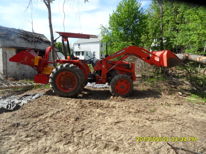

About 5 yrs ago this time of year I tried the same thing. I was looking for a 40HP plus for $15K or less. I wanted a ton of lift on the 3pt and half a ton on the FEL.
Messed up on the tractor a bit and got a well maintained 50HP Kubota M4700 for $11.5K at a Public Service auction (plus "fees"). 2 tons on the 3 pt and 1 ton on the FEL.
attachment.php
Enough money left out of my budget for a new chipper.
attachment.php
But I had looked for over 6 months.

I'm also firmly in the 'don't waste your time and money on an 8N' camp. Those suck. They were popular at the time because the next best selling tractor ate hay and pooped.
If you are trying to go cheap, get a 20 year old Japanese diesel 4wd tractor with a loader. Should be close to 10 grand, give or take. 30 hp sounds about right for what you want to do and your budget. I'd go with a 40hp unit if you can find one.
Ford 1720 or 1920. John Deere 970 or 1070. Kubota L2900, L3600, L4200. Massey 1260. Those are some of the best / heaviest / most reliable.

Not sure about the R-1 tires... I am thinking R-4s might be a better choice? If you are worried about stability, then filled rear tires would be good.
I too have watched for used implements (a smallish rough mower, 5' or 6' rear blade) and not found much worth bringing home unless you get lucky. Your interest in EA seems like a good start for that. My present L3400 was used mainly for finish mowing for years before I got it, and the seller was very happy with how it worked for that purpose. Rough cutting would either take a bigger, heavier tractor or sticking with a smaller deck- say 5', which would get old fast depending on how many acres you are cutting.
I have had no issues with buying CLEAN used tractors, since most brands will give thousands of hours (well, 2, anyway) of service providing they are simply maintained. I had a L3130 that came with 1200 hours, and for all practical purposes, it could have had 120 hours- no problems or diminished performance was detected while I had it. After I had cleaned up, epoxy primered and painted the loader bucket, the tractor could pass for a garage queen. I personally love the Grand L Kubotas, but to each their own.
Having a SSQA loader opens many doors to useful attachments, like grapples and forks, and at least one rear remote or third function is good for a lot of things.

I think youre right to favor the HST. The only thing in your requirement that would favor gear is the garden plow/disc work. A 40HP HST will do fine there, but it will slow you down a little compared to what a gear tractor would do. - Thats not so big a deal with only 2-3 acres. -- EVERYwhere else the HST will win out by its superior ability to instantly choose speed from 0 up.
I say ~40HP or a little more. AG tires for their superior traction and width adjustability.​
I think 4WD has been considered a must, altho I didnt see it mentioned.

If you buy the tractor new get a front end loader. It will be MUCH cheaper if purchased with the tractor. A FEL makes a tractor into a versatile do it all helper. My little Kioti is used much, much more than the twice as large Ford because it has the loader.
A smaller tractor is much easier to use in a garden or other cultivating jobs. There is a reason IH sold all those Cub Farmalls for tobacco and garden cultivation in the fifties and sixties. A larger tractor will be faster, etc., but you will screw up some rows using it. Been there, done that!!
Get the HST if you are going to be using the tractor in a garden or mowing around obstacles.
Get the HST if you are going to do ground engaging jobs like moving dirt or gravel. Once you start changing directions every few seconds the HST will make life much easier.
Get the HST if your wife is going to use it.
Your wife will love the HST especially on a smaller tractor. Some weeks my wife starts and stops mine many more times than I do. She moves flower pots, potting soil, bird baths, flowers she has dug up, trash bags, and anything else she can get into the bucket. Eight year old granddaughter putted around the yard all summer with the bucket full of water watering the flowers. Had to put a few back in the ground after 55-gallons dumped on them but it taught her how to handle the machinery and kept her out of trouble otherwise.
Get four wheel drive. You will never regret it.
Forget the old Ford. I have spent hours on one as a teenager and younger. They are designed for row cropping. Which means they are designed for pulling ground engaging implements in a straight line across a large field. Use them for anything else and they are lacking.
