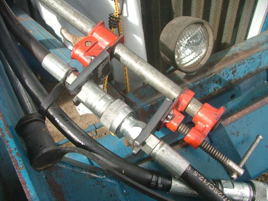

Good idea KC, the only way I could screw that up is if my QC were to bind somehow and the tool would continue to force it together.
Might mess up the retainer balls, what ya think ?

Will, I don't think that you would mess up the retainer balls if a you use common since in putting the coupler together.

John, here is the tool in place. Man, with a arm like that you sure could use a tool that would help put those couplings together.
Sorry I forgot the pictures.
/ A home made tool
#28
Here they are. The second pic I have a little squeeze on the coupling.

Eddie, the times I had to do it on my Kubota FEL, and my neighbor's hay equipment, it was always quick and easy and just almost no loss of fluid. I never loosened the hose connections, and I think I learned that little trick here on TBN, but can't remember who posted those instructions first.

Many thanks for the clamp idea. I am going to make one this weekend.
The "quick attach" (ha ha) backhoe on my JD 455 crawler has 1" quick disconnects that can be connected only after the backhoe is almost completely in position to be pinned to the crawler. So the disconnects are down in a hole and it is impossible to push on them very hard. I will need to make it a bit more compact than yours (I should not need the adjustable length) to get it in place, but I think it will work very well.
Thanks again for the idea.
