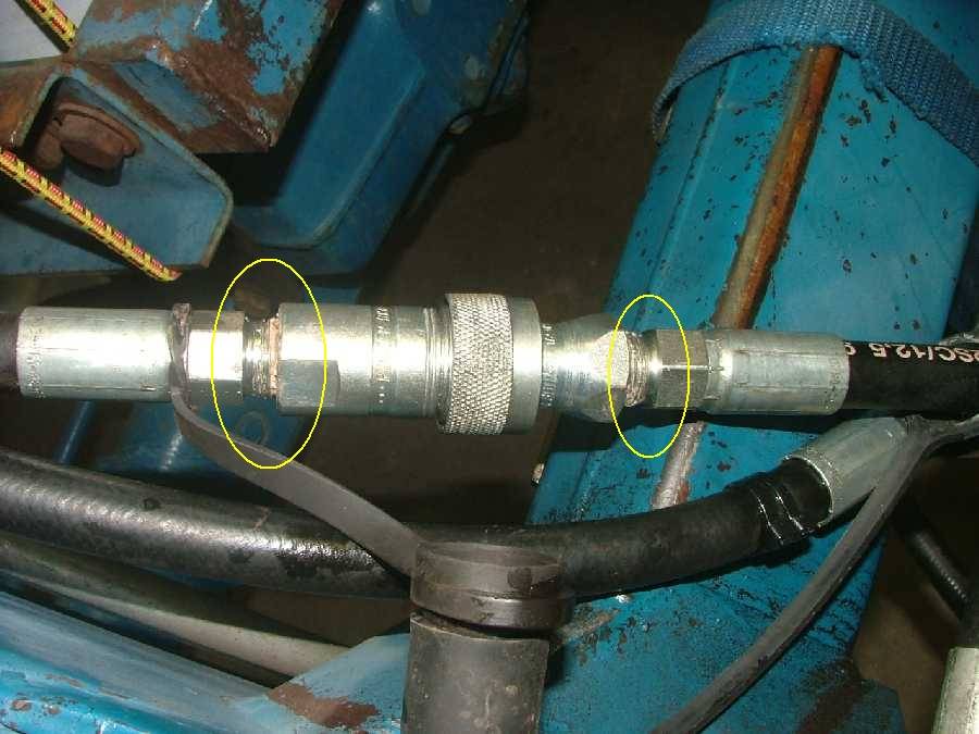

I don't post too much here but thought maybe you guys might be interested in this tool I made for my tractor hydraulics.
The other day I was trying to connect the hydraulic couplings on the tractor and I just did not have enough strength in my wrist to completely push the connector to gather.
Some where I saw a picture of a pair of pliers that had a fork on the end of the pliers. You slipped the fork over the pipe and squeezed them together and and that forced the coupling together.
While I was trying to get the coupler together I was thinking about something that I could use to make a tool to accomplish the same thing.
This is what I came up with.
The first Pic. is the hydraulic coupling. You slide the knurled part back and shove the other piece in. That is what I could not accomplish. So I thought about a fork that would slide down into the grove in the yellow circles.

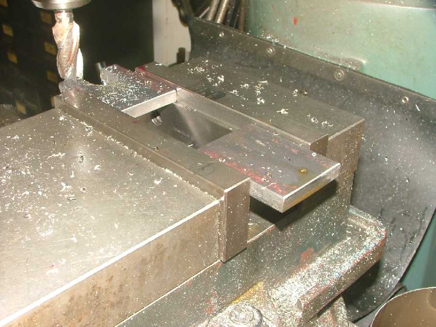

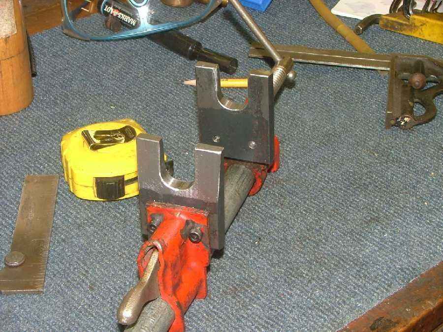

Pic 2 and 3 is machining the fork. I made several pases to get the fork cut.

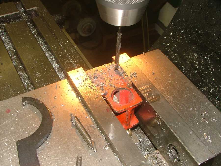

Pic 4 drilling the bolt holes in the pipe clamp pads.

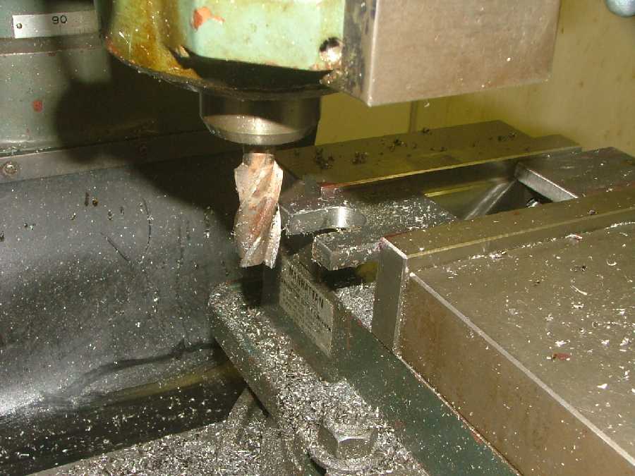

Pic 5 The tool is complete. You start the coupling together put the forks down in the groves and gently close the pipe clamp shoving the coupling together.
You've made an interesting tool, but the only reason I know of that makes the couplers hard to push together is pressure in one or both of the lines. So it's relatively easy to relieve that pressure. If it's the male coupler, just put a rag over the end and hit it once with a mallet. You won't lose much fluid. If it's the female coupler, put a rag over it and insert a drift pin and tap it once. That's much quicker than using your new tool.
/ A home made tool #4
I agree with you on relieving the hydo pressure and it being easier and quicker. However if you have a set of arthiritic wrists, elbows, shoulders and all the involved muscles, relieving all the pressure you want still will not make it easy enough to push these couplers together. Great tool.
/ A home made tool #5
Yes, it can certainly be a handy tool. I just don't know the original poster well enough to know whether he was aware of how to relieve the hydraulic pressure or not. If so, and he still has a problem connecting the couplers, then his tool is going to be very handy.

Thanks Bird for the comment. I have been around hydraulics in one form or anthor most of my life so I was aware of that method. Or in the case of my old 73 ford 4000 I can just shut off the engine and operate the control valves.
My reason on making this tool is more like Lfgengler said, the dang arthritis or something has gotten into my left wrist.
Matt, to answer your question, Yes and No. when I first started this project I hooked the edge of the pipe clamp pads in the slots and pressed the two parts together. This gave me the idea for the forks so I machined up what you see in the picture and bolted them to the pipe clamp.
One thing I did not mention was I also machined a 5* wedge on the fork. Not all of the slots like are marked in the yellow circle will be the same,depending how hard they were threaded together. The fork being tapered should fit most any slot.

Great idea using those furniture clamps like that.
I've had need for a tool just like that many times. Thought of making something like that but never really got around to it. I like the sliding furniture clamp idea ... it's universal fit.
