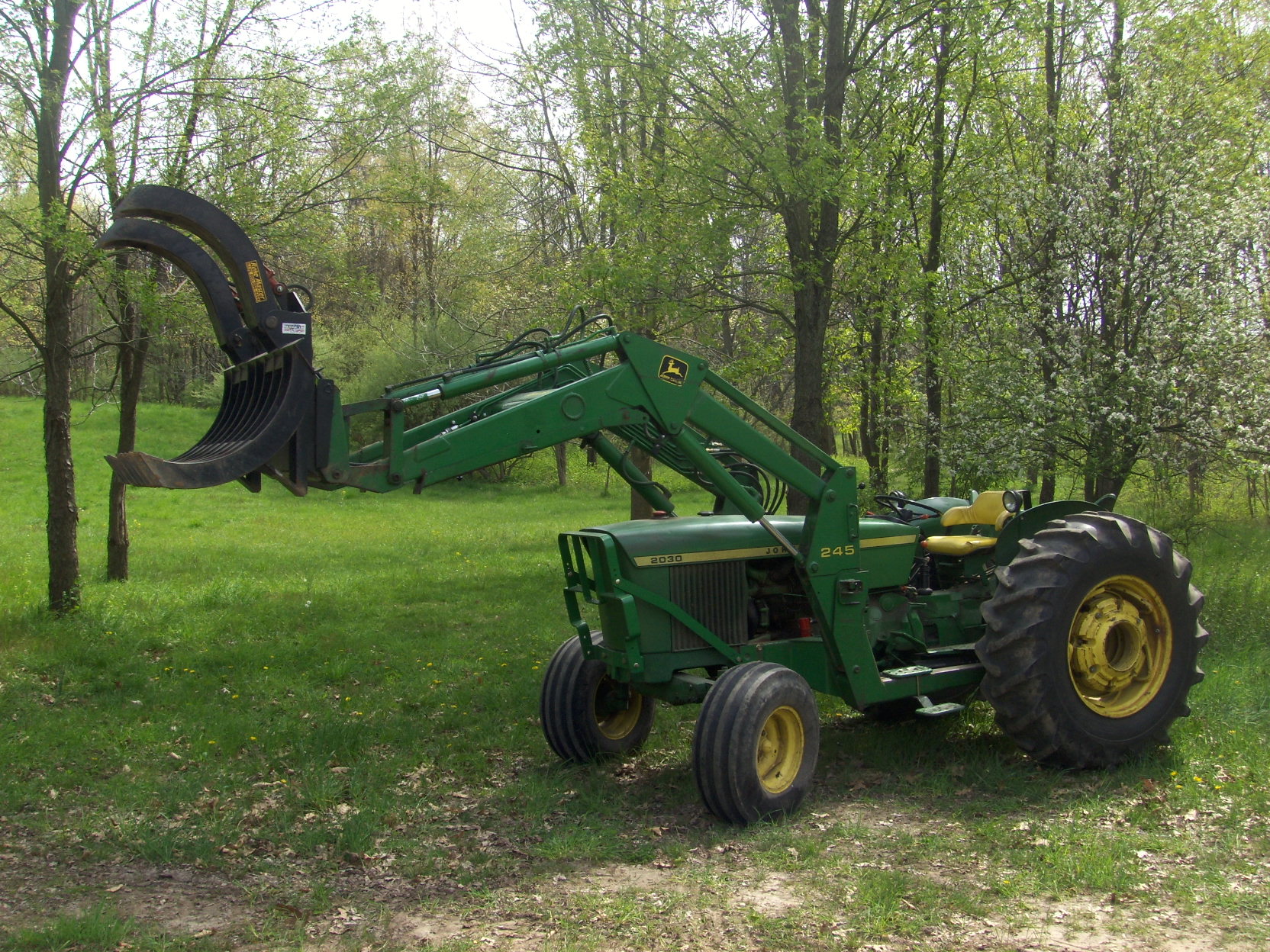

I also have a Rake Master! Glad to hear they are still in business. I bought mine used. It came with skid steer mounting plate that I modifiied to work with my JD 245 loader quick attach. Mine is very heavy duty. I plan to redo the mounts so I can use it on my JD 6415's JD 640 loader. (Did not have the JD6415 when I bought the grapple)

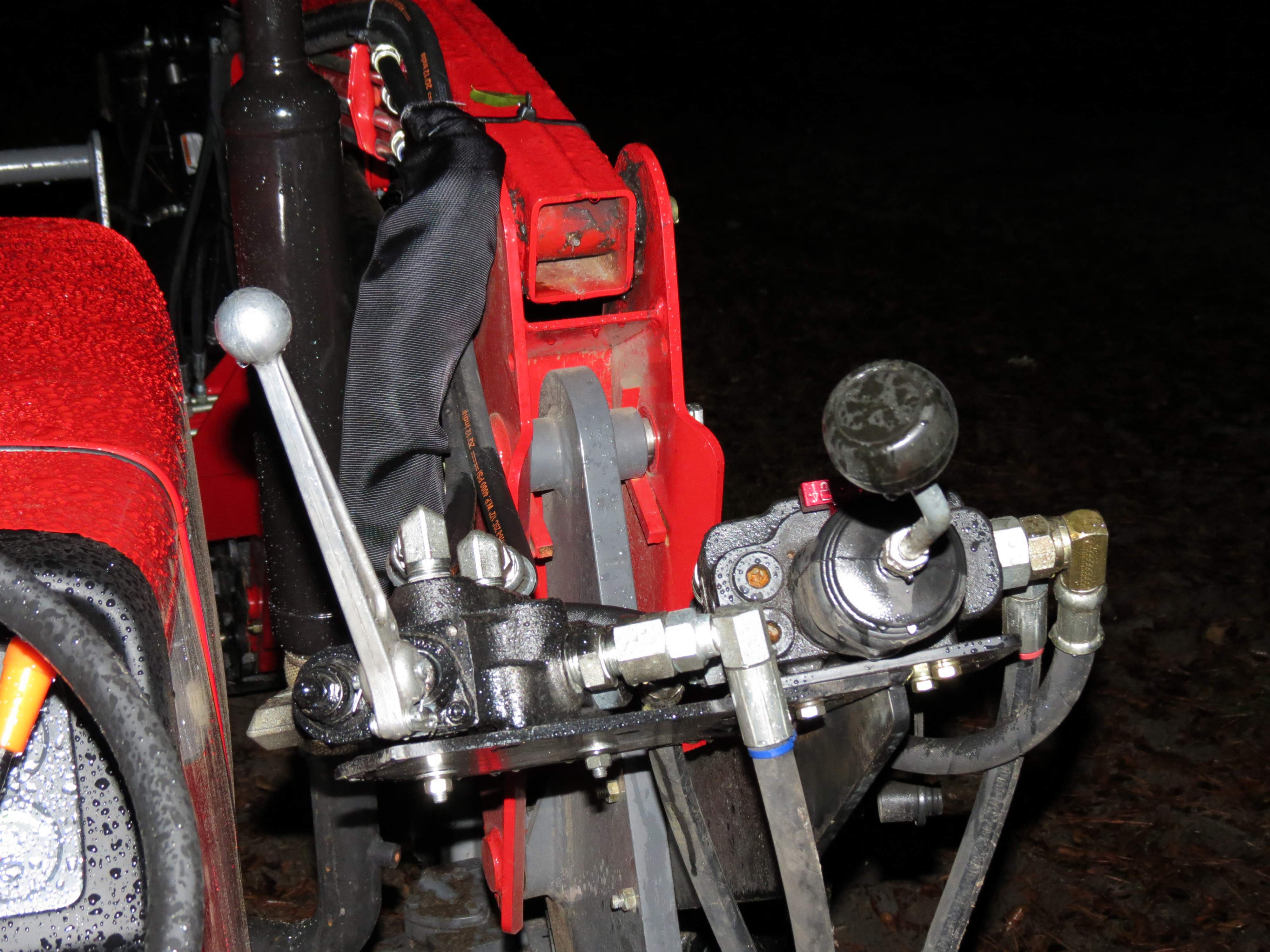

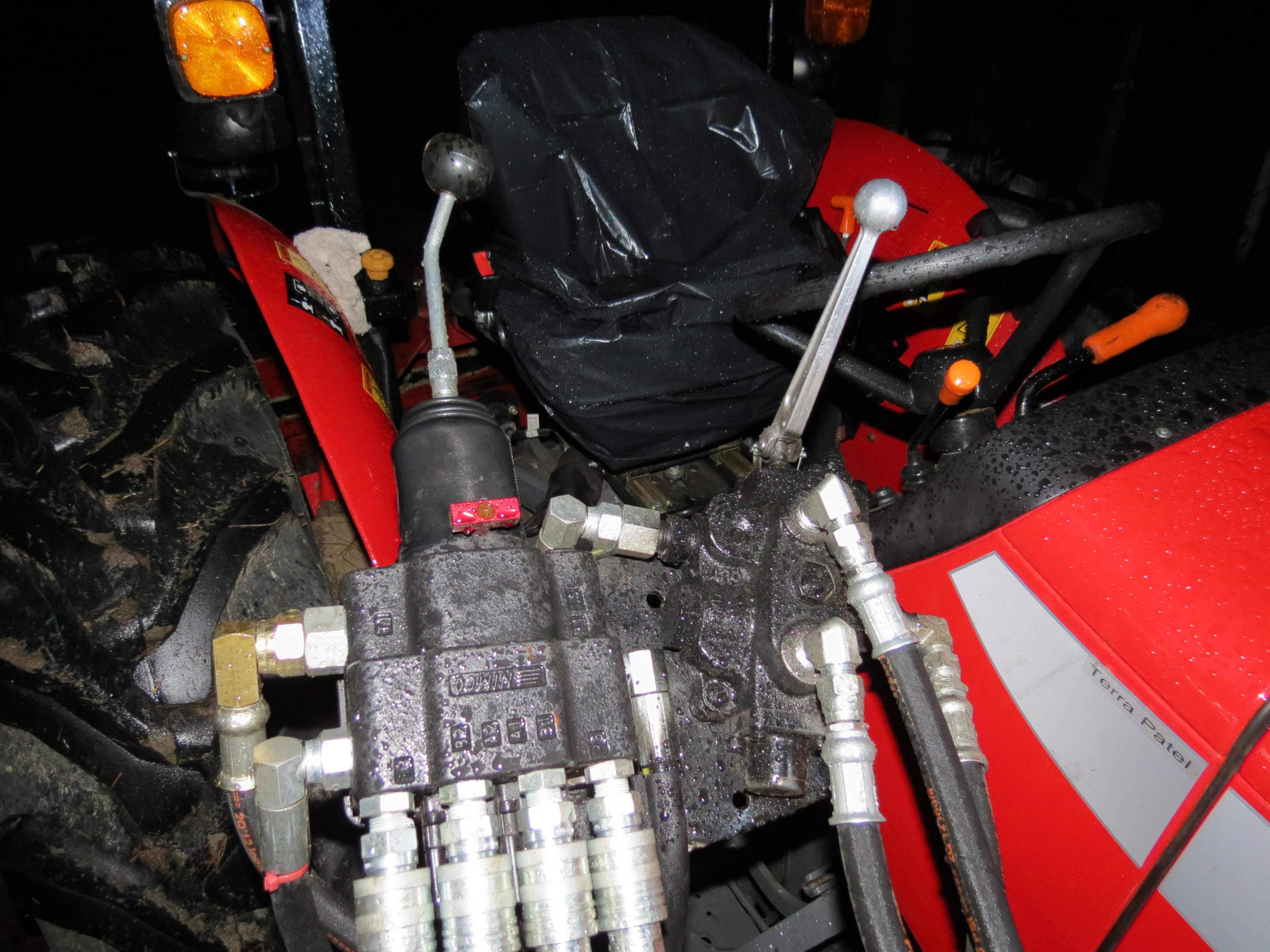

I purchased through my local Massey dealer got the grapple and 3rd function kit installed for $2900 otd. For the third function we are just using a single remote valve mounted next to the loader joystick. No electrical required and simple like i like it. I have had electric diverters before, they only last so long and are not cheap.
