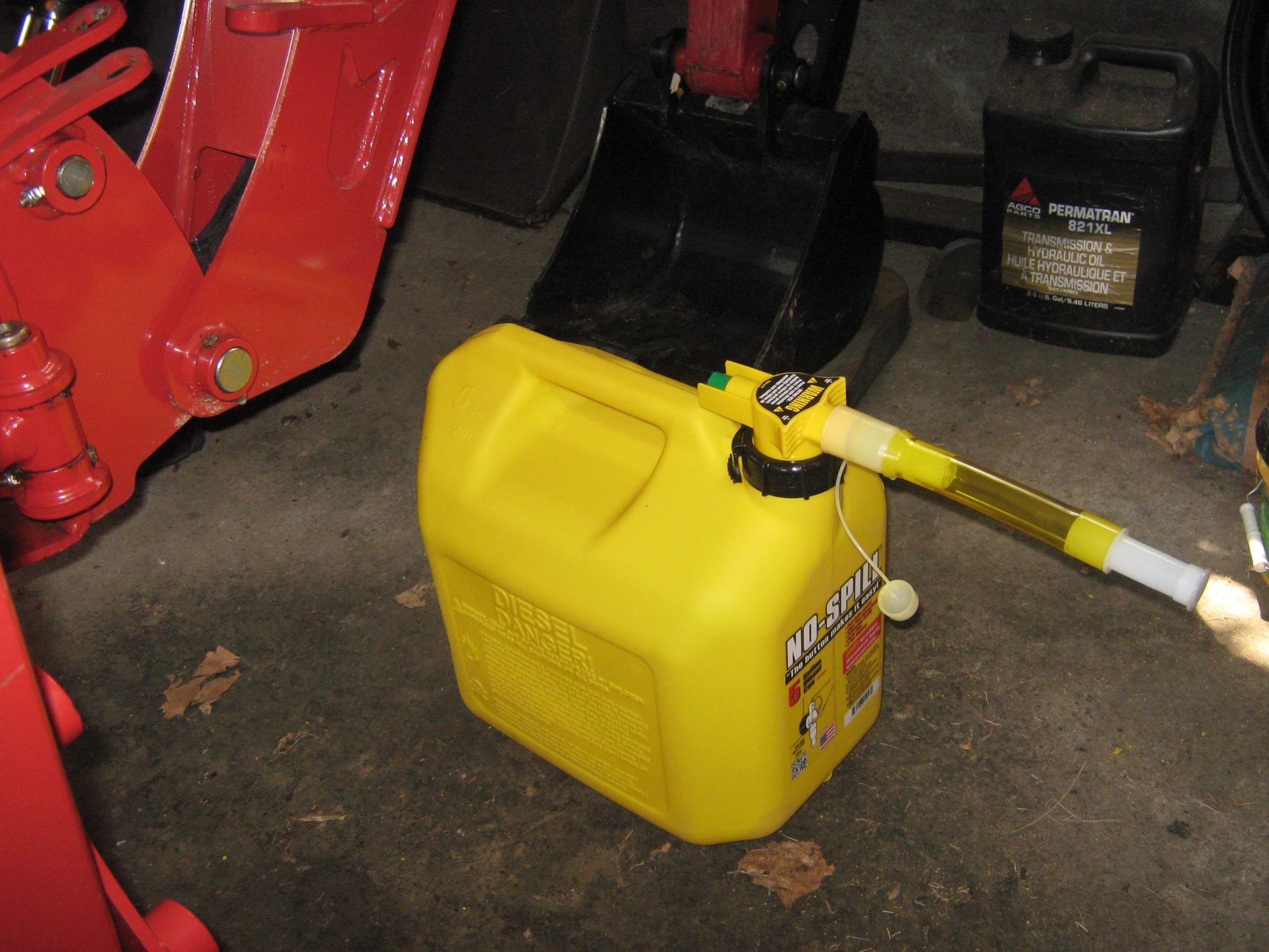

I have a 5 gallon no spill container. Just push the button. Also got a 6 inch tube for it. IMG_1310.jpg
   / A few questions from new BX25D owner #14
I have a 5 gallon no spill container. Just push the button. Also got a 6 inch tube for it.View attachment 439803
I use the same for my diesel fill can. My only complaint is my thumb gets tired holding it down for a long fill.

There are almost as many Youtube videos about adding a vent to EPA fuel cans as cat videos. I found that the tire stem and cap works great and is free from almost any tire shop. In my opinion, the EPA cans have caused more fuel to be spilled thru frustration and difficulty than would have been vented otherwise with the old, regular and useful cans.

Fully agree re the vent in the fuel can, the reason I got fuel all over the seat was the surging/glugging from the air lock - I eventually figured out pouring on it's side was better, but adding the vent is a good idea I think, will look into that - hadn't heard of the tyre stem trick and get a spout for it, if that doesn't work for me will try one of these fancy cans or the siphon pump....
