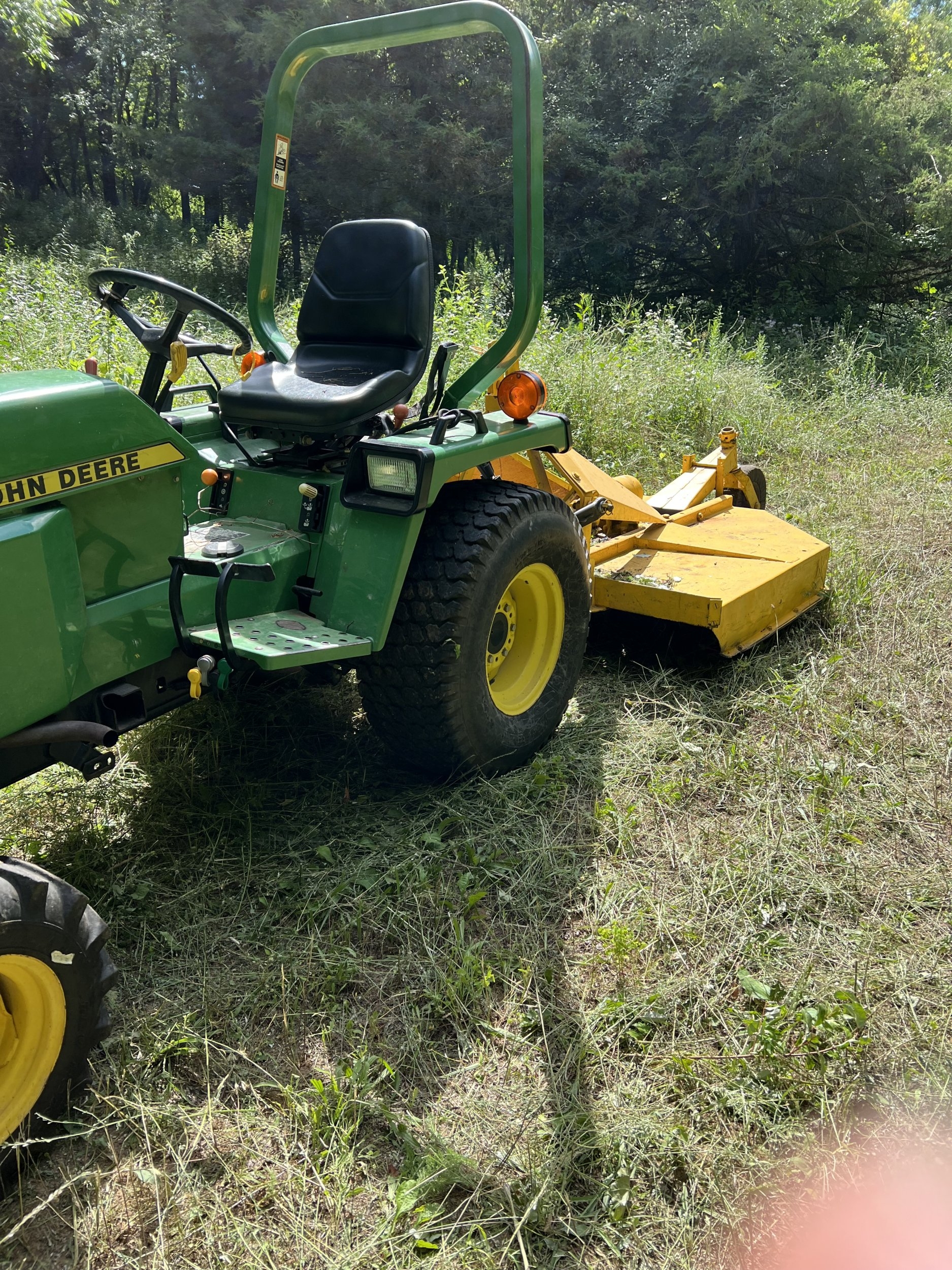

My brother gave me a older brushcutter and i was wondering about the best method to sharpen the blades,they seem impossible to remove.I have it on a 855 jd and have always questioned whether it is too big for it

Often it is possible to tip the mower up on it's side and use a 4 1/3" grinder to sharpen the blade if desired. Personally I have never sharpened a set on mine, I prefer a dull blade as it does not slice off the brush stubs leaving a sharp spear point on it it does tend to break and shatter the ends.
