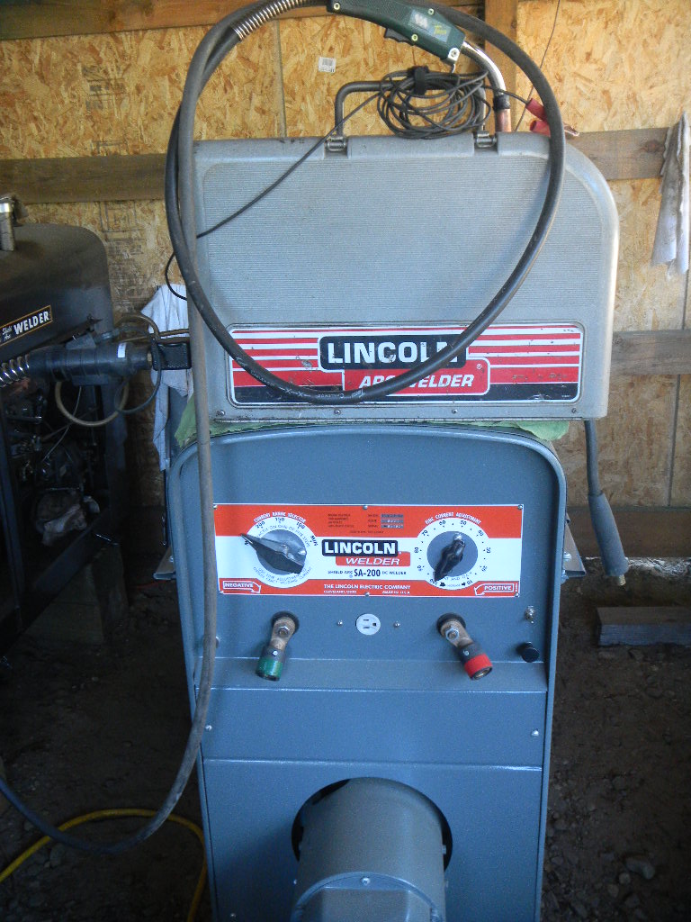

FarmDad before CV engine drives came out in the early 1980s we ran self shielded flux core on CC engine drives. Before the Northridge earthquake in California we ran mostly T-11 wire. Now a days it's pretty much all T-8 wire here on the west coast which requires CV.
Here is some 1/16-inch Hobart Fabshield 21-B ran with a 1966 engine drive, and an LN-25. If you ever get to the point where you need to do a lot of welding fast, there is a whole world of self shielded T-11 wire out there that can be run outside.;)

Shield , I realize this and if i run across a CC suitcase setup cheap enough i will nab it just to have if no other reason . My old AEAD miller would be a fine power supply for one and at times it could be nice just to squirt weld , but not often enough to justify the $$ i have seen them sell for so far around here .
Besides , i have reached the stage in life that the only things fast are the ones you would prefer to last for a while . Changing rod and chipping slag really dont hurt me none and i got a lot more time than sense anyway LOL .
