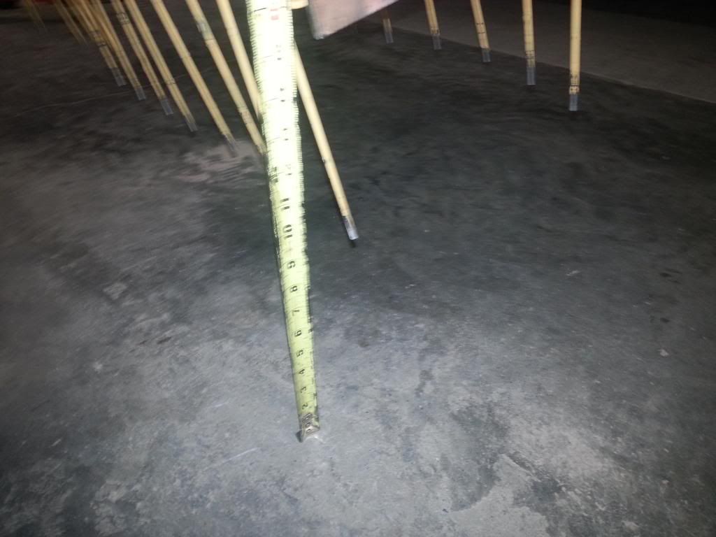

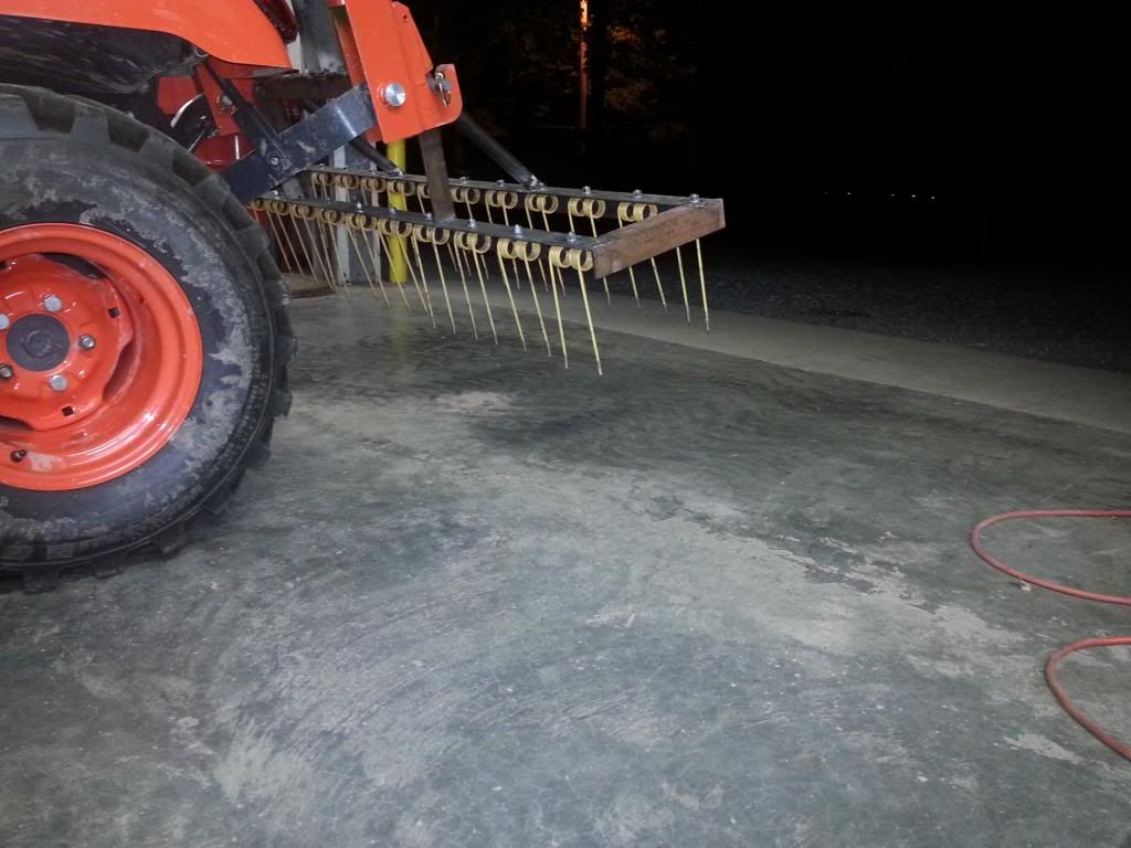

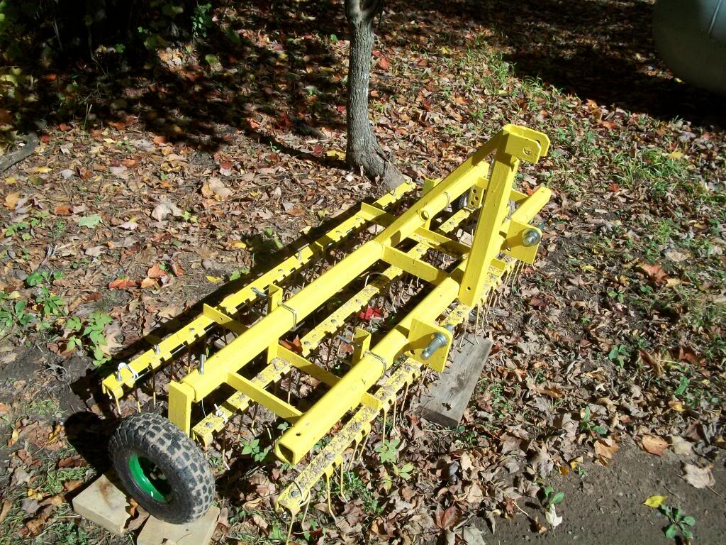

Here it is raised completely.
About 9''
This picture shows the 3PH all the way down, so I have about 6'' before the 3PH bottoms.

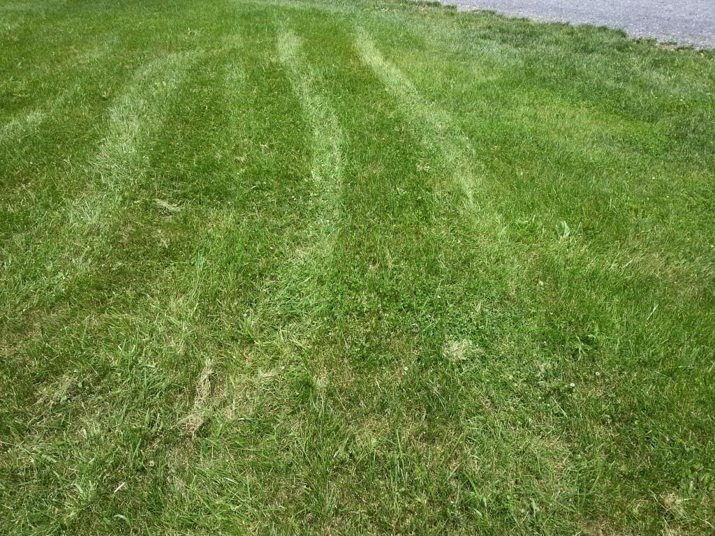

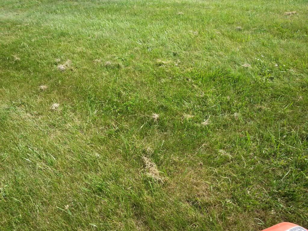

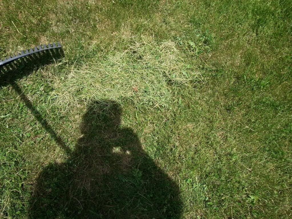

I don't have a lot of thatch on my yard. Here is a picture of a poorer spot were I first tested it Friday.
Here is spot tested it on today.
After a very light raking of one width of the detatcher and 10' or 12' long.
The grass was tall and I mowed after this. I think with no more thatch than I have I can probably mow the grass low and dethatch at the same time then mow it again running 90* opposite of what I previously mowed.

Neat......
I built kinda/sorta the same thing.... Mine is 5' wide and attaches to one of my somewhat universal 3pt tool bars...
When I get my front 3pt lift built for my tractor, I can reverse the rake on the tool bar, and run it out in front of my MMM deck...
Good luck

Yours is cool too. I almost made mine attach to my trailer mover. I thought about making a front mount instead of a 3PH but with the weight bracket and grill guard it would be a pain to attach. Did your tines come bent or did you bend them? I bent a few extras I had. I think it may have worked better but I don't have that much thatch to do a good test on. I think I am going to add gauge wheels next. I think the weight of the 3PH, QH, and dethatcher is too much for the tines and it bends them too far back.

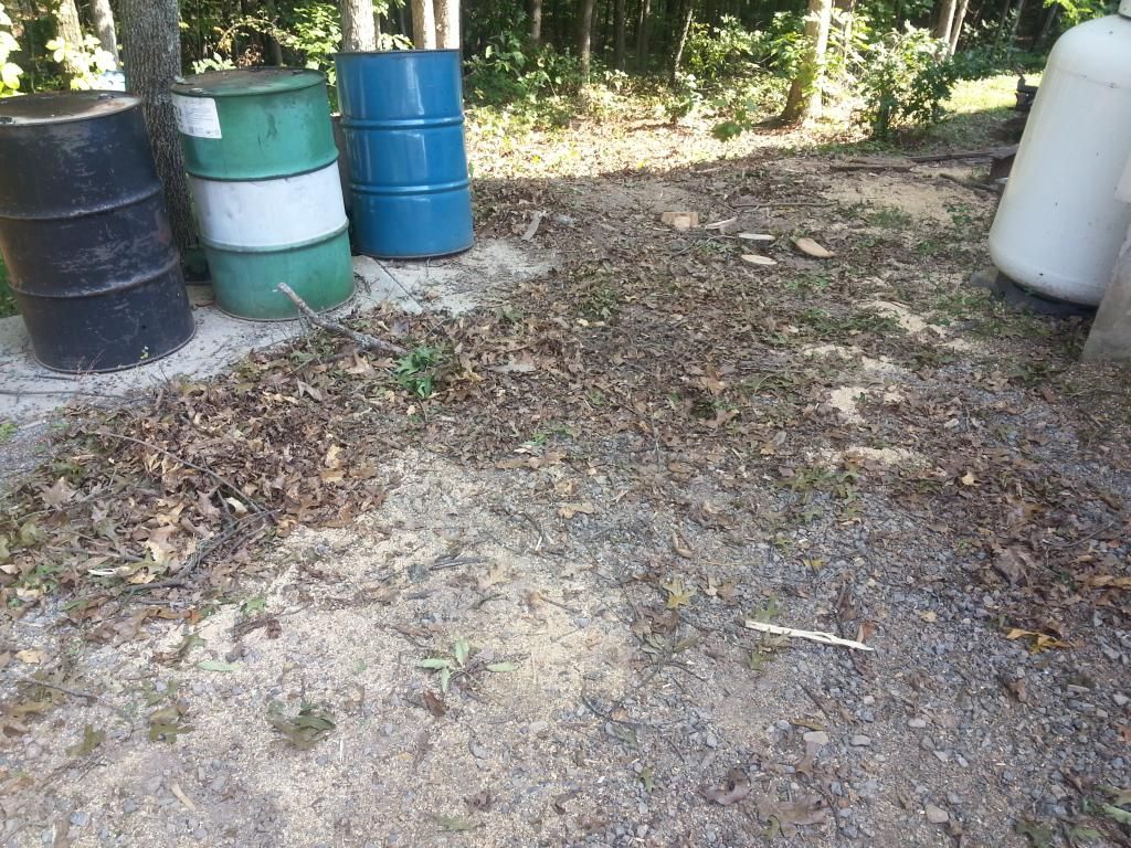

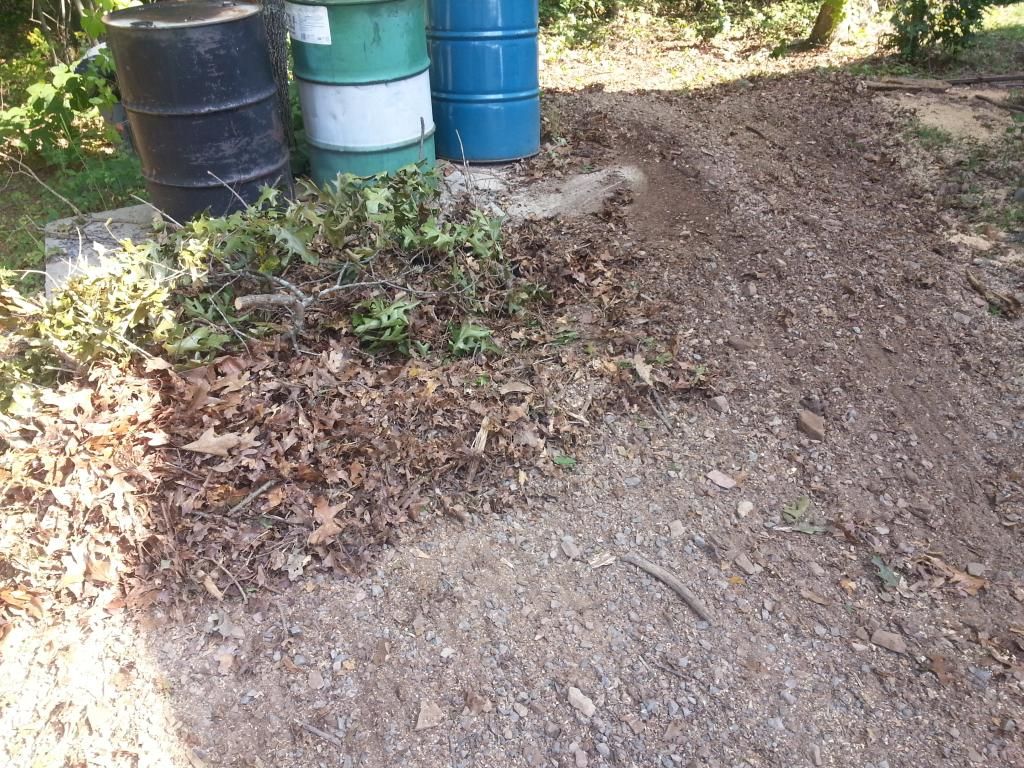

Update:
I have a set of casters I am going to use as gauge wheels. I am also going to replace the upright pieces for the toplink with box tubing. I think it will look better. I might add park stands too.
I can also hook up to the dethatcher backwards so I can push stuff into a big pile If I want.
I tried it some more on cleaning up leaves and brush. It works really good.

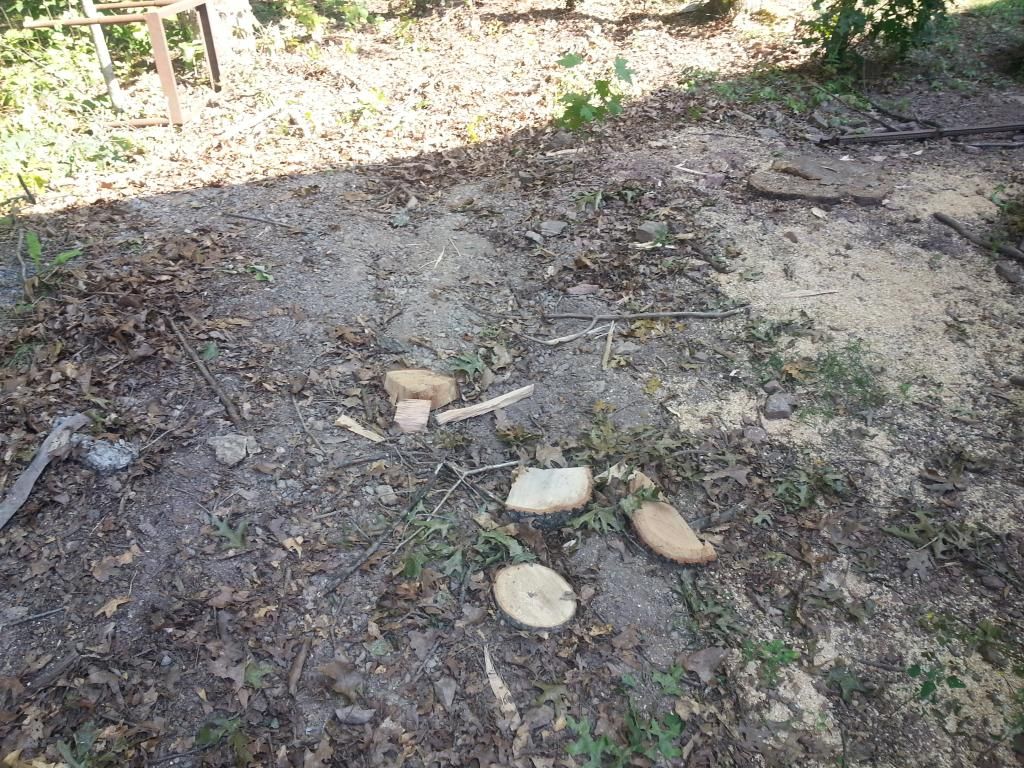

The soil here is very poor. I got a nice new broadcast spreader in the spring. My old spreader did not work good, it did not apply the fertilizer evenly. Since I got the aerator I have been using it every spring and fall. I think it has helped a lot. It has also smoothed things up. I have read that aerators help with thatch so maybe that is why I don't have much of a thatch problem. Every 3 weeks I change the direction I mow. The grass has improved over the past couple of years. What I really need is a weed killer put on it. I think I need to get a sprayer now. It probably needs lime too. I want to get a soil analysis done so I know how much to put on the yard. I have also been working on drainage issue so I have had to tear up parts of the yard. This year I took down several trees from the yard. I think I am finally ready to rent a stump grinder. Once they are gone I can focus on getting things graded up and getting some good grass growing.
