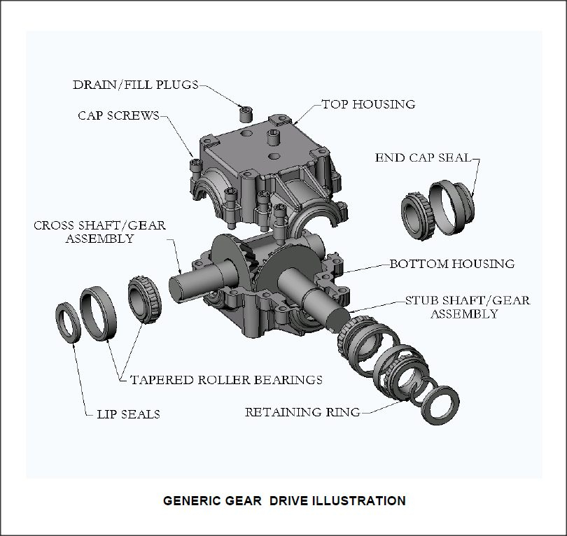

I know you had said,
"All four bearings in my Superior 211ADF 189 6 Gearbox are just regular conical roller bearings like Timken Set 14 (L44643 / L44610).
It's a common trailer wheel bearing size. The oil seals are TC 1.00 x 1.5 x 0.25 Inch"
Were you able to locate the shafts and gears? I'd like to completely rebuild my old gearbox. The input shaft has wear on it from where the yolk was flopping around. And I'd like to key that shaft instead of slipping the bolt through.
   / 90 Degree Bevel Gearbox on Kubota F3060 - 72" Rear Discharge Deck
#37
1. The gears looked like new in my 3600 hour OEM gearbox.
2. I was able to buy new input shaft for my (Superior 211ADF 189 6) from Messick's but that was all they had for it!
On inspection I realized the input shaft is just a straight 3/4" shaft with two snap ring grooves and two key-ways so it would be a easy to make another one if ever needed, but I am missing a milling machine - no problem there are many local shops able to cut a simple key-way.

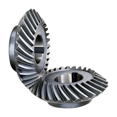

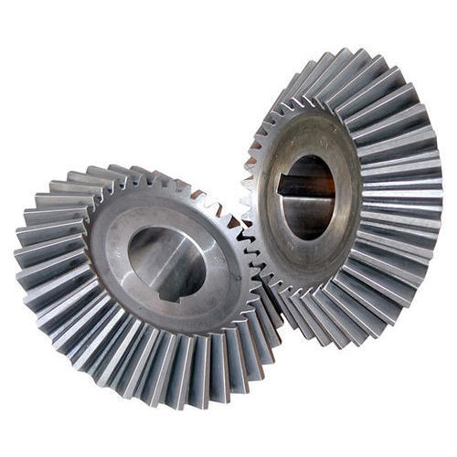

There is a difference in the gears in-between the two gearboxes which is why I eventually will re-install the old Superior gearbox, and you may already know all about it but for the benefit of others:
"The advantage of the spiral tooth over the straight tooth is that they engage more gradually. The contact between the teeth starts at one end of the gear and then spreads across the whole tooth. This results in a less abrupt transfer of force when a new pair of teeth come in to play."
Superior gears:
Spinco "straight tooth" gears:
I think either will be fine for a while, but just as a principle I want to go back to the OEM sometime this winter or later.

I would not be too concerned about slight slack in the spiral gears at all and in fact any wear (slack) in the conical roller bearings will increase the axial play in the shafts & slack in gears.
Subject to inspecting the gears, hopefully new bearings & seals should be all it needs.
I have not tried to find new gears since they are fine - gear oil change every couple of years should keep them in good shape.
Please keep us posted of what you find out later regarding this?
