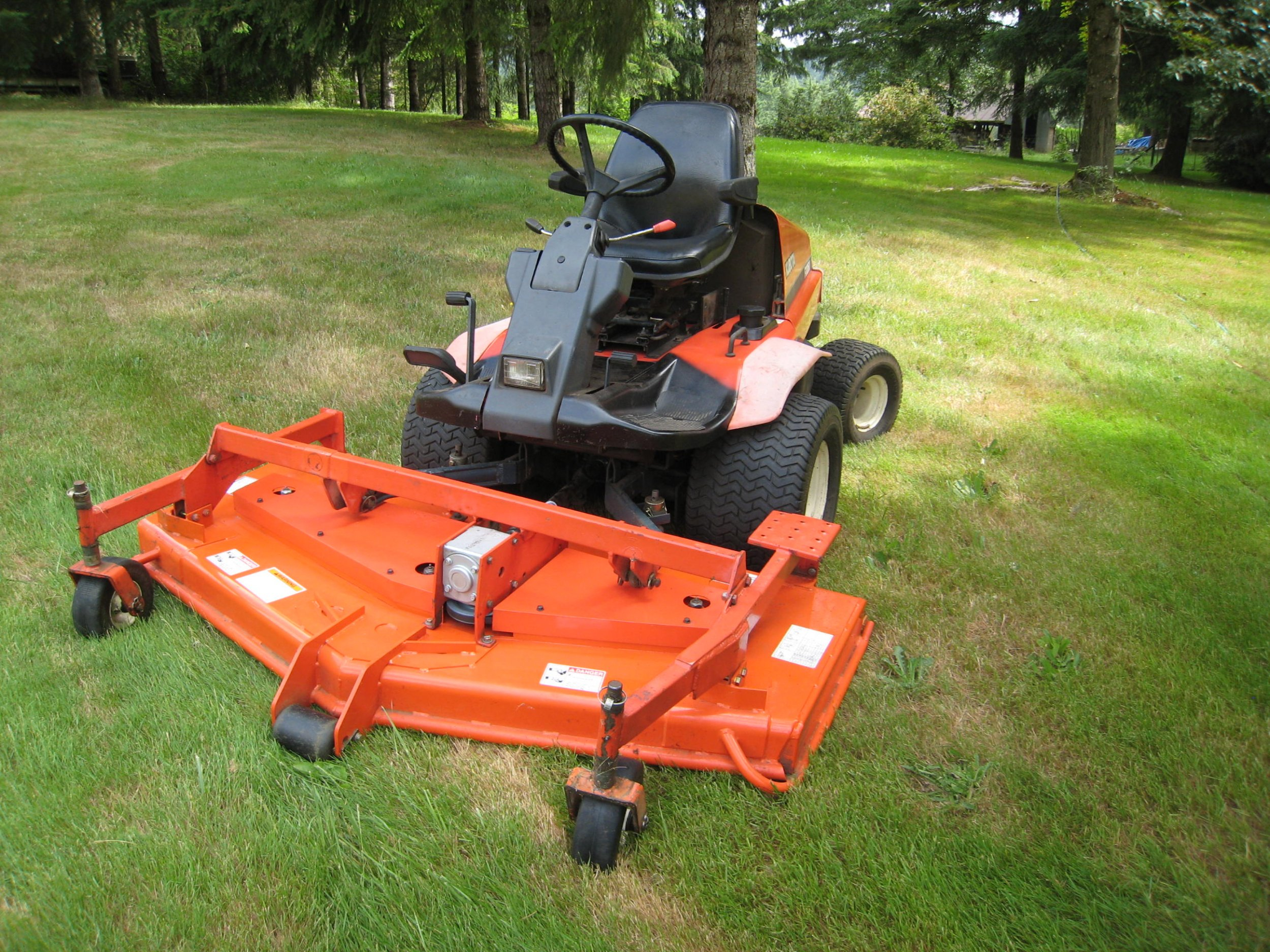

My 1997 F3060 has what I think is somewhat rare RC72R-F30 Rear Discharge Deck and was just recently told by a dealer that Kubota is no longer selling replacement gearbox!
I was just looking to buy a spare gearbox but was unable to find anything offered online by the gearbox supplier either (Superior Gearbox Company, Stockton, MO) - in all fairness I never phoned them since I decided to look for alternatives first since the last Kubota list price for replacment was $631.39 (when it supposedly was still available)!

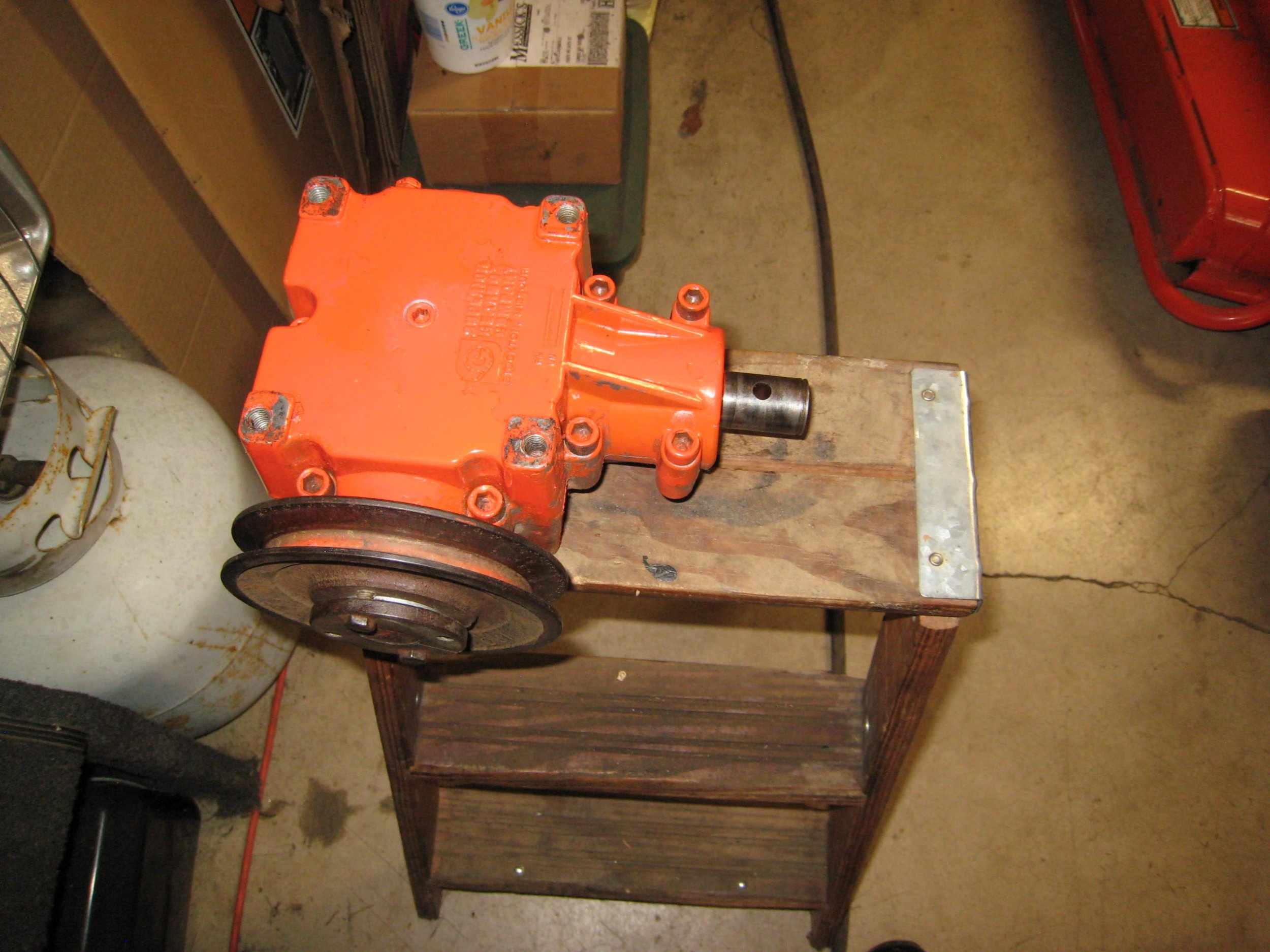

1. Superior 211ADF 189 6 Gearbox:

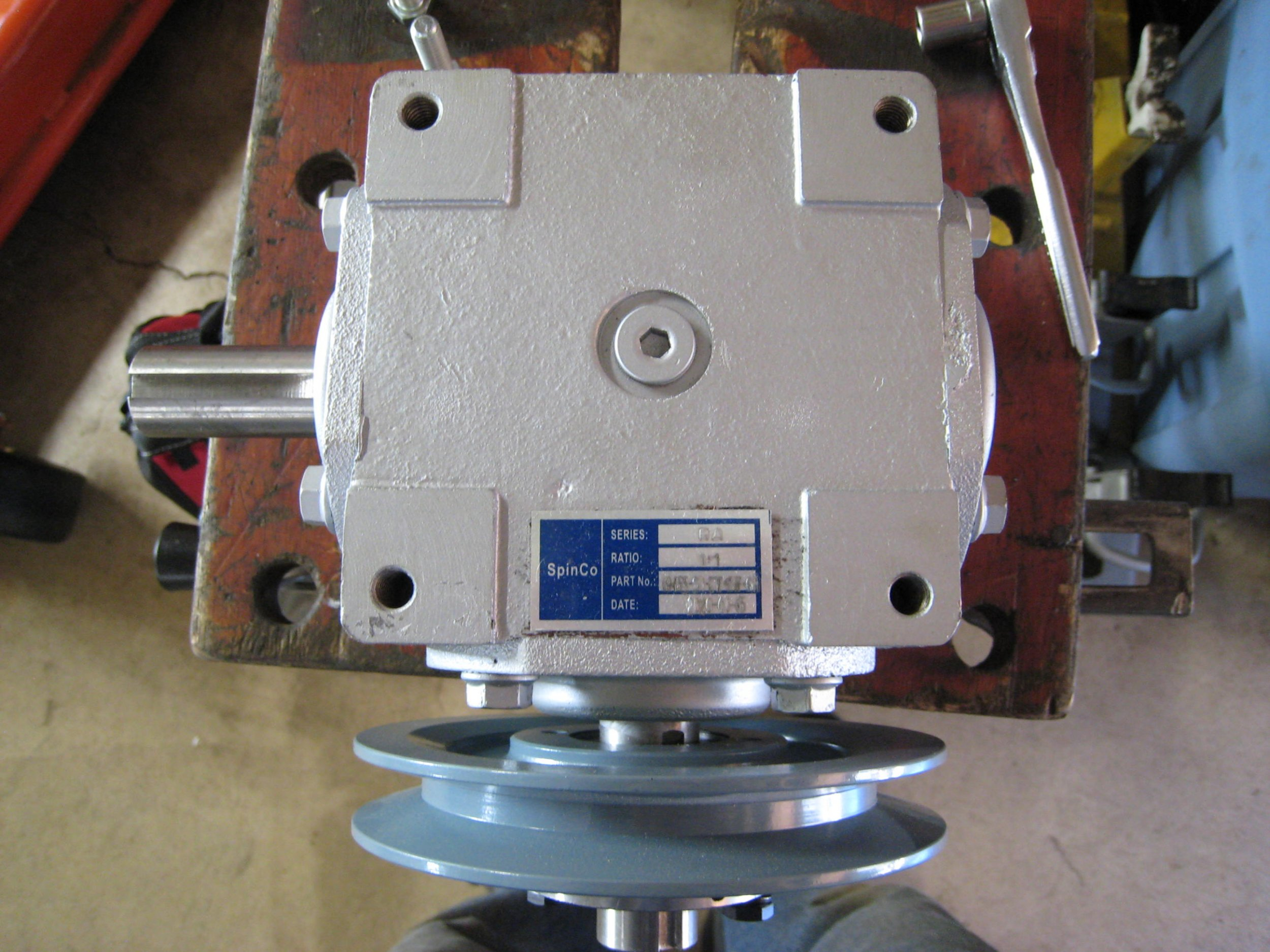

2. It was easy to find a Chinese made replacement gearbox on the eBay for $135
It is rated for 40 hp at 1500 rpm - the mower PTO runs at 2500+ rpm normally.
We will put some hours on it and update on longevity later - so far only about 3 hours of use.

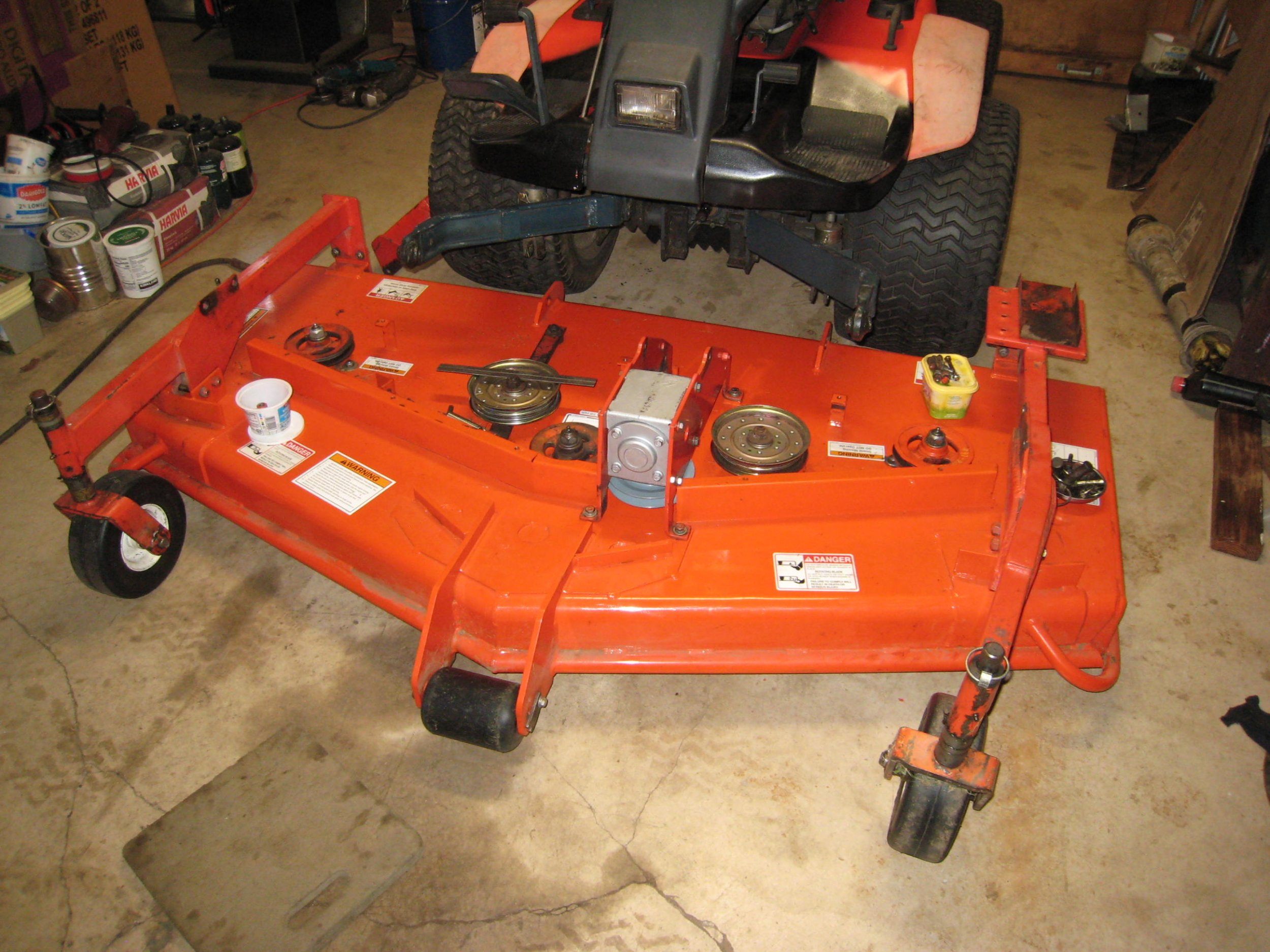

3. The fit was perfect:
4. Shields etc. in place:
Like was said above this is just a spare gearbox, but I also want to modify the OEM gearbox input shaft and will machine 1/4" key-way & eliminate the shear bolt altogether.
The shear bolt only arraingment is causing a loose / sloppy fit in-between the driveshaft yoke and the gearbox input shaft.

Hey, ya gotta do what ya gotta do, right!? I pro would have done the same thing.
Would Superior sell you one directly? At what price?
Im a little skeptical the 1500rpm limited Chinese box will hold a sustained 2500rpm, but you aren’t out a lot if it grenades, either.

Yes I share the longevity concern but only one way to find out!
It is just a simple bevel gearbox so maybe running it at 2500 rpm when it's rated for 1500 rpm may or may not be a big deal?

I would say they are just covering their rear ends due to using some cheap bearings. I won't be surprised if the first thing to fail will be the bearings, which is actually good as you could replace them with some good quality bearings.
Anyway, it's not that the gearbox will be under constant load with 40HP pushing it the entire time, so it will probably be fine.
