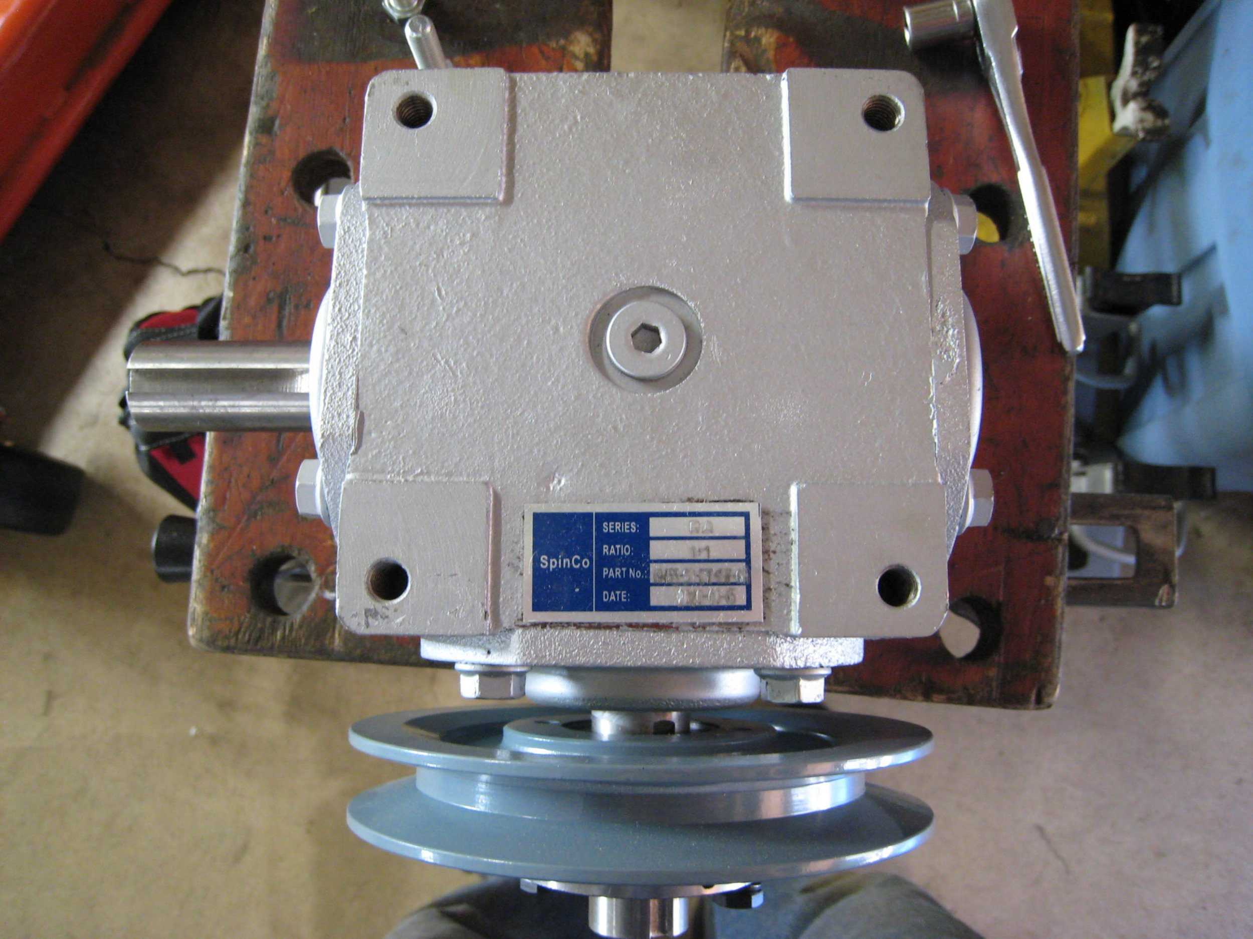

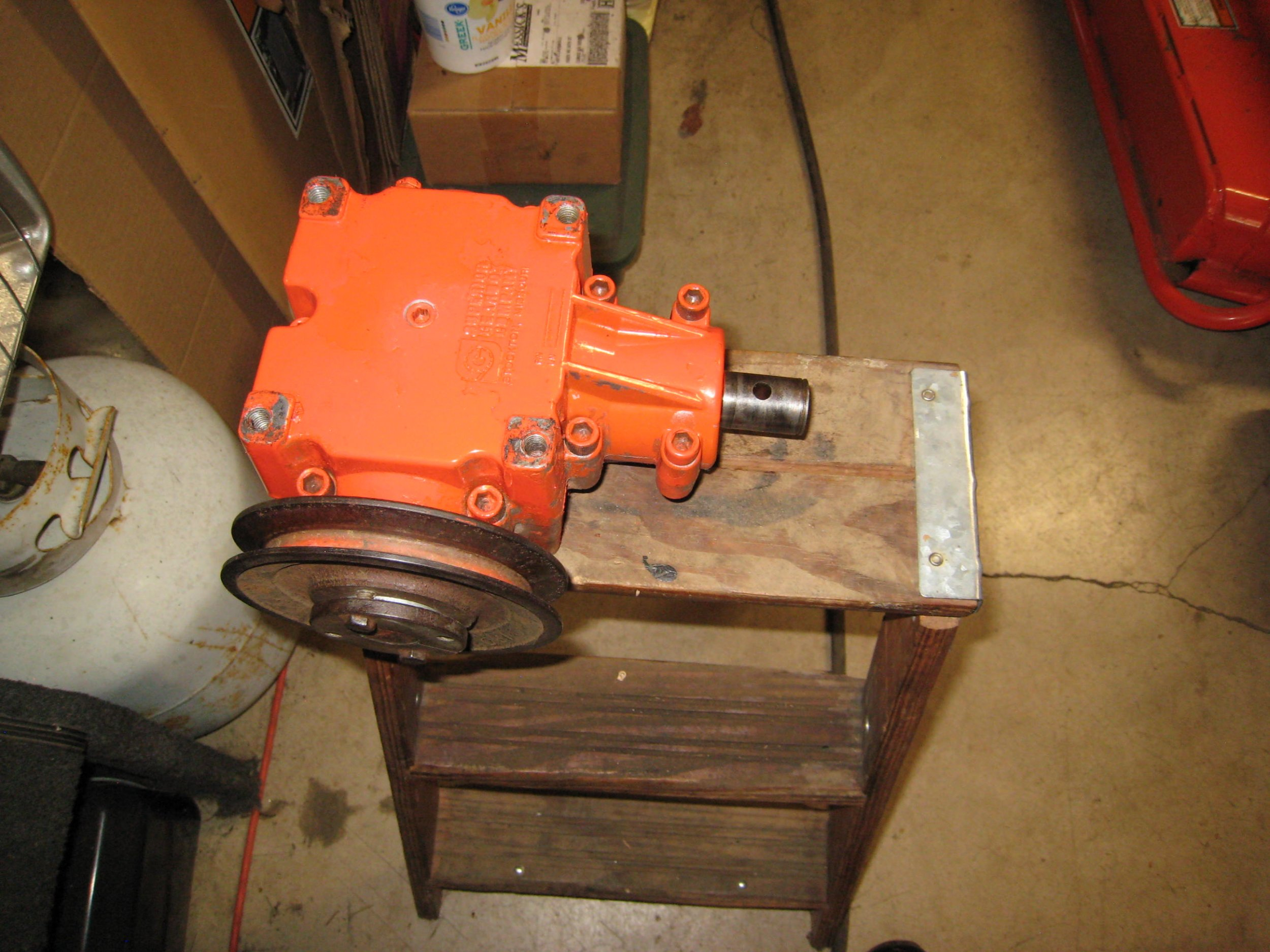

My 1997 F3060 has what I think is somewhat rare RC72R-F30 Rear Discharge Deck and was just recently told by a dealer that Kubota is no longer selling replacement gearbox!
I was just looking to buy a spare gearbox but was unable to find anything offered online by the gearbox supplier either (Superior Gearbox Company, Stockton, MO) - in all fairness I never phoned them since I decided to look for alternatives first since the last Kubota list price for replacment was $631.39 (when it supposedly was still available)!
1. Superior 211ADF 189 6 Gearbox:
2. It was easy to find a Chinese made replacement gearbox on the eBay for $135
It is rated for 40 hp at 1500 rpm - the mower PTO runs at 2500+ rpm normally.
We will put some hours on it and update on longevity later - so far only about 3 hours of use.
3. The fit was perfect:
4. Shields etc. in place:
Like was said above this is just a spare gearbox, but I also want to modify the OEM gearbox input shaft and will machine 1/4" key-way & eliminate the shear bolt altogether.
The shear bolt only arraingment is causing a loose / sloppy fit in-between the driveshaft yoke and the gearbox input shaft.
I don't like buying Chinese stuff but unfortunately was not left with many other choices I could find and would have paid the OEM list price if it had been available!
Good to have alternatives & some competition!

OK, All my parts are in. I didn't think my old gear box was very loose but by comparison it's quite loose! Do you know off hand what thread size that is for the JD Vent? I assume it's an NPT thread?
Also, is there any reason why the gearbox can't or shouldn't be mounted so the round plate is on top?
Mounting that way would allow for drilling and tapping that plate while off of the gearbox. No need to completely disassemble the gearbox. The bolt pattern, unless I missed something is 4.25" in all directions.

It's 1/8" NPT-27, so 21/64" drill bit will work.
I mounted it so the round plate is on the side for three reasons:
1. I can check the oil level by using a screwdriver as a dipstick.
2. I can evacuate all of the used oil with a vacuum oil extractor.
3. The oil evacuator tube can be easily pushed all the way to the bottom of the gearbox housing where any fine wear debris (steel) should be.
If you dismantle the gearbox you will see why none the above will work if it's mounted the other way as you suggested.

Yes the Superior has 1:1 ratio also.
