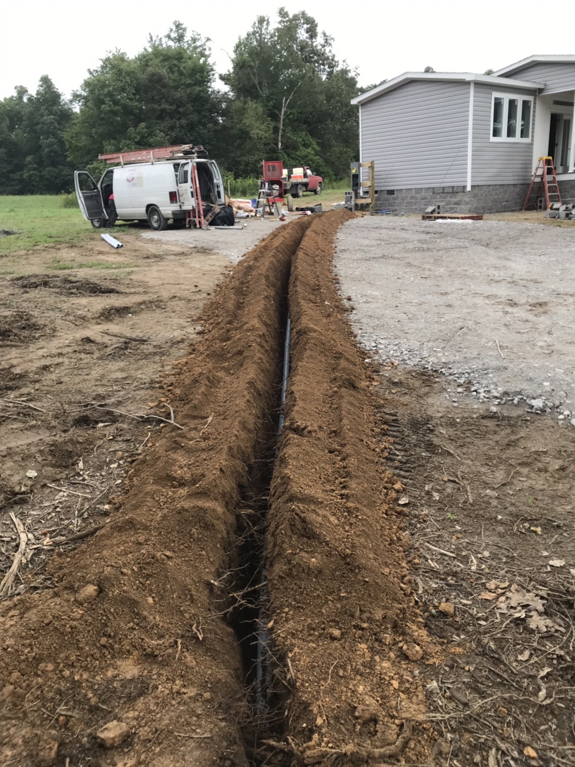

I’d just use the 12” the smallest bucket I have is a 16” and half the time I use the 24” to dig a ditch. If you want a narrow and clean ditch you can’t beat a ditch witch. And when you’re done with that the angle blade is as good as it gets for covering a ditch. IMG_9045.JPG

Digging with a 12” vs 24” really isn’t that much difference in cleanup. And I’ve found that you have less settling with a wide ditch. You can roll the 24” ditch back in pretty good where you can’t a narrow one. But if I cared that much I’d use a ditch witch. There’s really no comparison between the neatness between it and a backhoe.

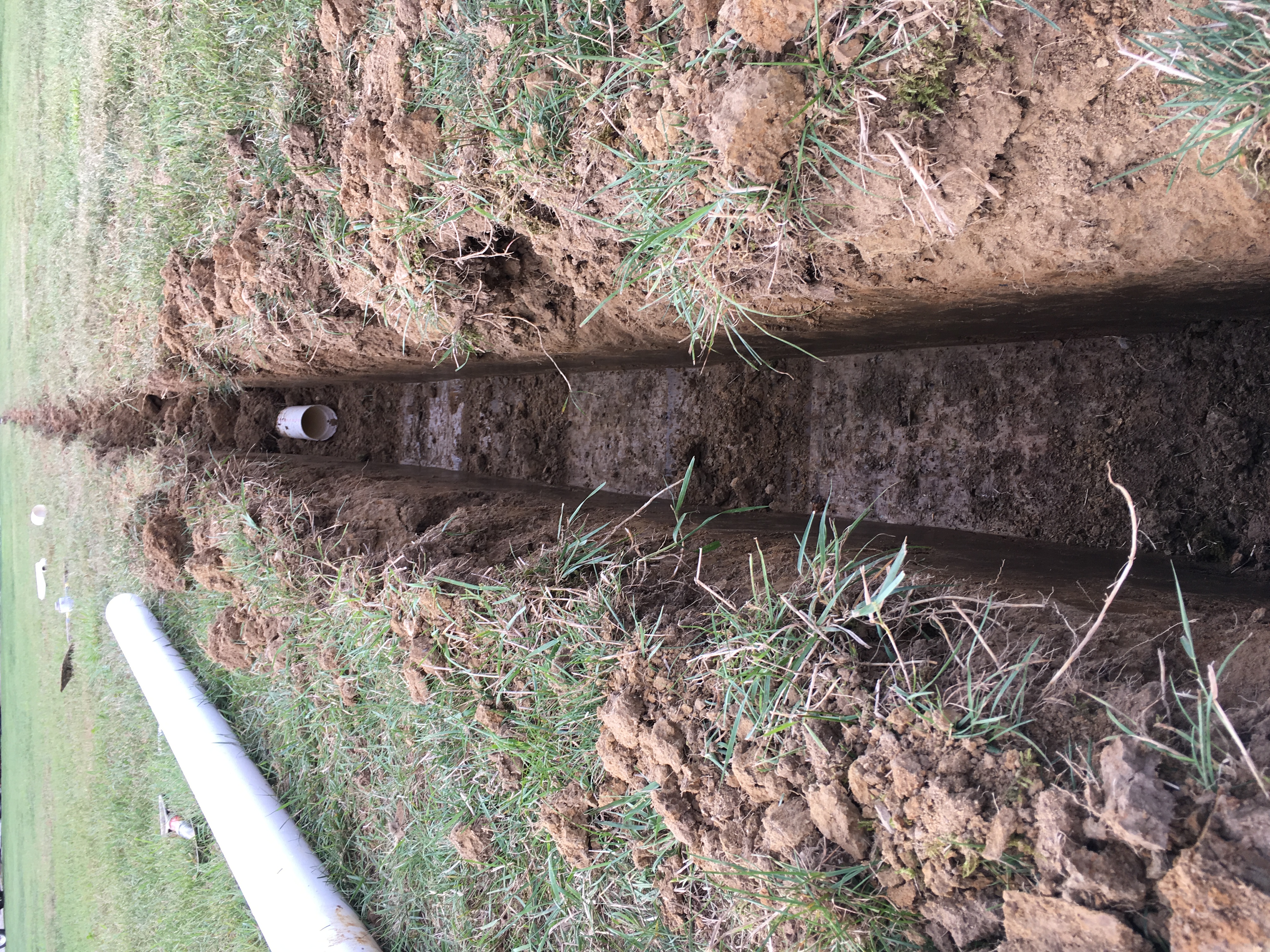

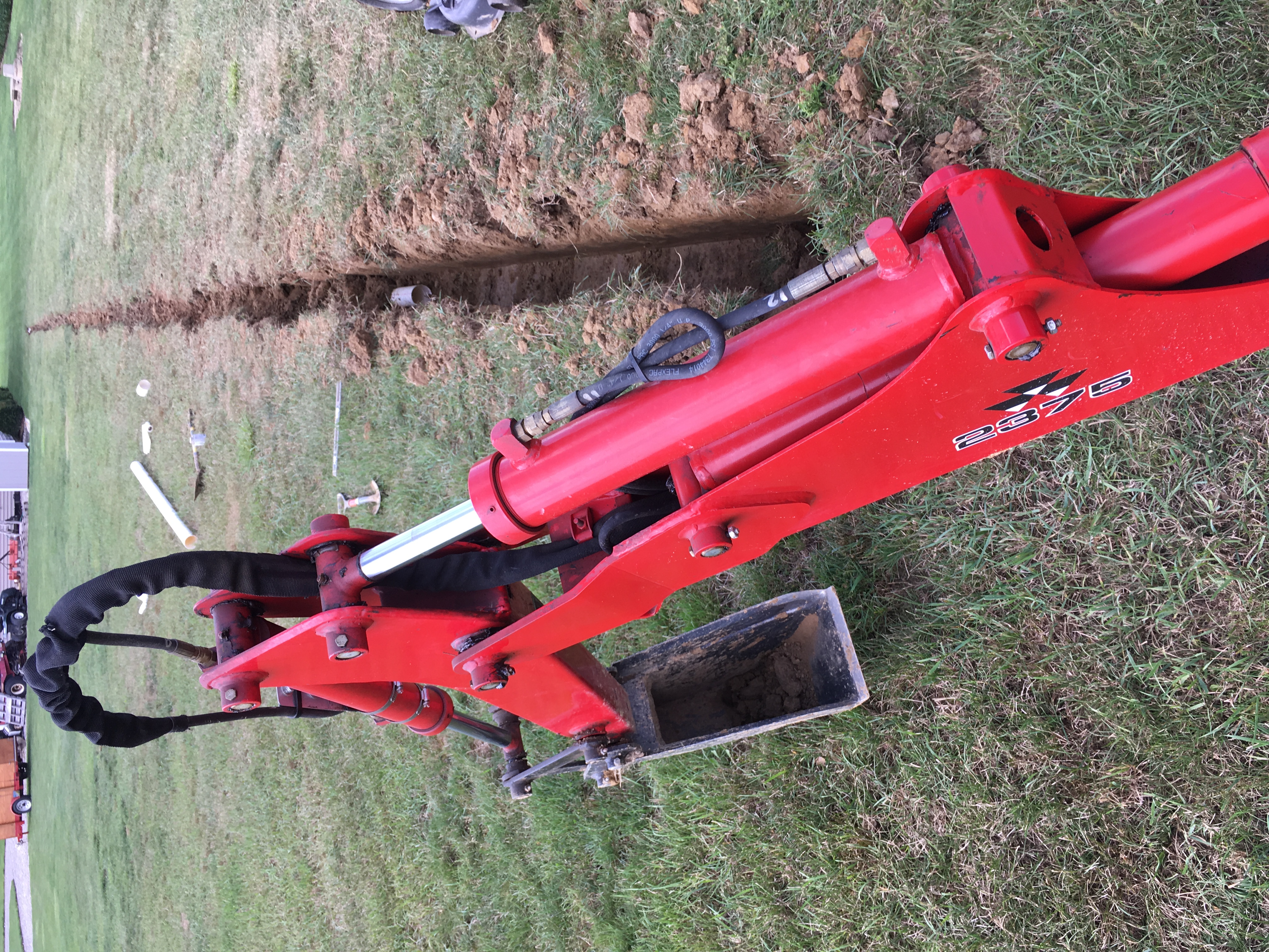

I'm not talking 12" vs. 24". I'm talking 6" vs. 24" or 27".
Your last line made my point.
I can dig a hole nearly as neat and tidy, as a trencher with my 6" bucket. And, if I need to, without a huge effort, I can hydro in the fill dirt with almost no settling. Then, I'm only planting a narrow strip of grass.
As I said, I've tried both ways.
Years later when you have a drought, and that 30" wide trench shrinks and settles, you have three times the area again, to redo.
I would use a 12", if I had to. But, that's only going to happen, when I have no other choice.

What did you do with the dirt from that ditch? I couldn’t even use a 6” on my M59. A 12” is about the least that would clear the thumb.
