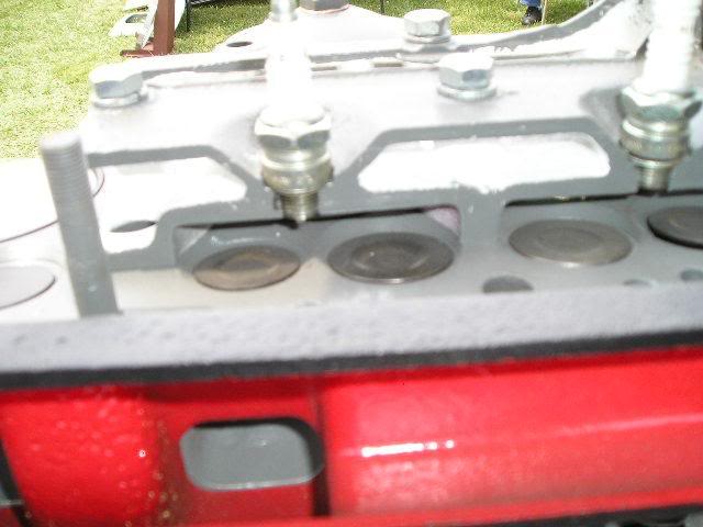

Ummmm..., am I the only one that caught this..??
**From the picture that GPintheMitten has posted the #1 wire goes to the from of the motor just behind the radiator, #2 wire goes behind that one, then the #3 wire goes all the way to the back of the engine on the last cylinder, and the last one #4 is located on the 3rd cylinder back for the radiator. That is where the wires have been since the second day of this thread.**
I do believe you have #3 & #4 wires crossed on the spark plugs. As mentioned in a past post, cylinders are numbered 1-2-3-4, from front to back. Firing order is 1-2-4-3. So, number on cap, to respective cylinder.
Not that you shouldn't at least get a pop from #1 & #2, if other items are properly installed and set to spec., but you're liable to freak out, if it would happen to half run, and sound like an old putsy-putsy John Deere, adding more confusion.
Hang in there, you'll get it..!!

he just explained 1-2-4-3
wire 1 to cyl 1
wire 2 to cyl 2
wire 3 to cyl 4
wire 4 to cyl 3
since the dizzy turns CCW looking at it.. the rotor passes 1, then 2, then 3 ( fireing cyl 4 ) then 4 ( fireing cyl 3 ) thus 1-2-4-3 fire order.
that's why he says the wire 3 goes to the back of the engine.
remember.. many oe caps have the cyl number onthem and will thus be numbered fire order.
many caps DO NOT have the wire / cyl on them.
sequential post #3 on the dizzy goes to CYL 4.
sequential post #4 on the dizzy goes to CYL 3.
refer to the picture that has black magic marker denoting rotation on the front of the dizzy cap.
