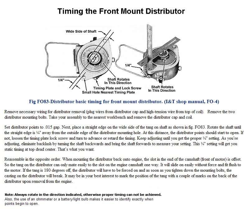

So how do you determine TDC on an 8N?
/ 8n will fire but not start?? #47
Flathead = plug wrench and something long that fit's in the plug hole.:D
/ 8n will fire but not start?? #48
Easier said than done on an 8N. The spark plug hole in the head doesn't line up with the piston. There is also very little room between the head and the gas tank. I successfully statically timed my front mount 8N the first time I tried it using the I&T manual. Its really easier than it looks. I copied these photos off Yesterday's Tractor site. Its the best source of info on old tractors. I suggest Pete also search there for help.

Ahh.. so you are saying that you know MORE than the engineers that designed and built the N... as they are the ones that devised the way to static time it.
I'm happy to meet someone that knows more than the people that designed the machine did.

I'd time the 8n per the book, but if someone wanted to probe a cylinder, I have found that the long pull ties to be a bendable object unlikely to scratch anything.

hard to beat, using the RTFm method. that's how the ford engineers designed it.... must be something to it... :)

I gotta say.. this is the most discussion I have ever seen on timing a front mount.. that 1 pafge out of the manual says it all.. all ya need is a straight edge and to be able to measure 1/4" :)

i wasn't even really singling you out.. just the entire thread amuses me. there's no reason to fabricate elaborate ways to time a front mount when 1 page out of the 1939 service catalog shous how to do it with a ruler.. ;)
