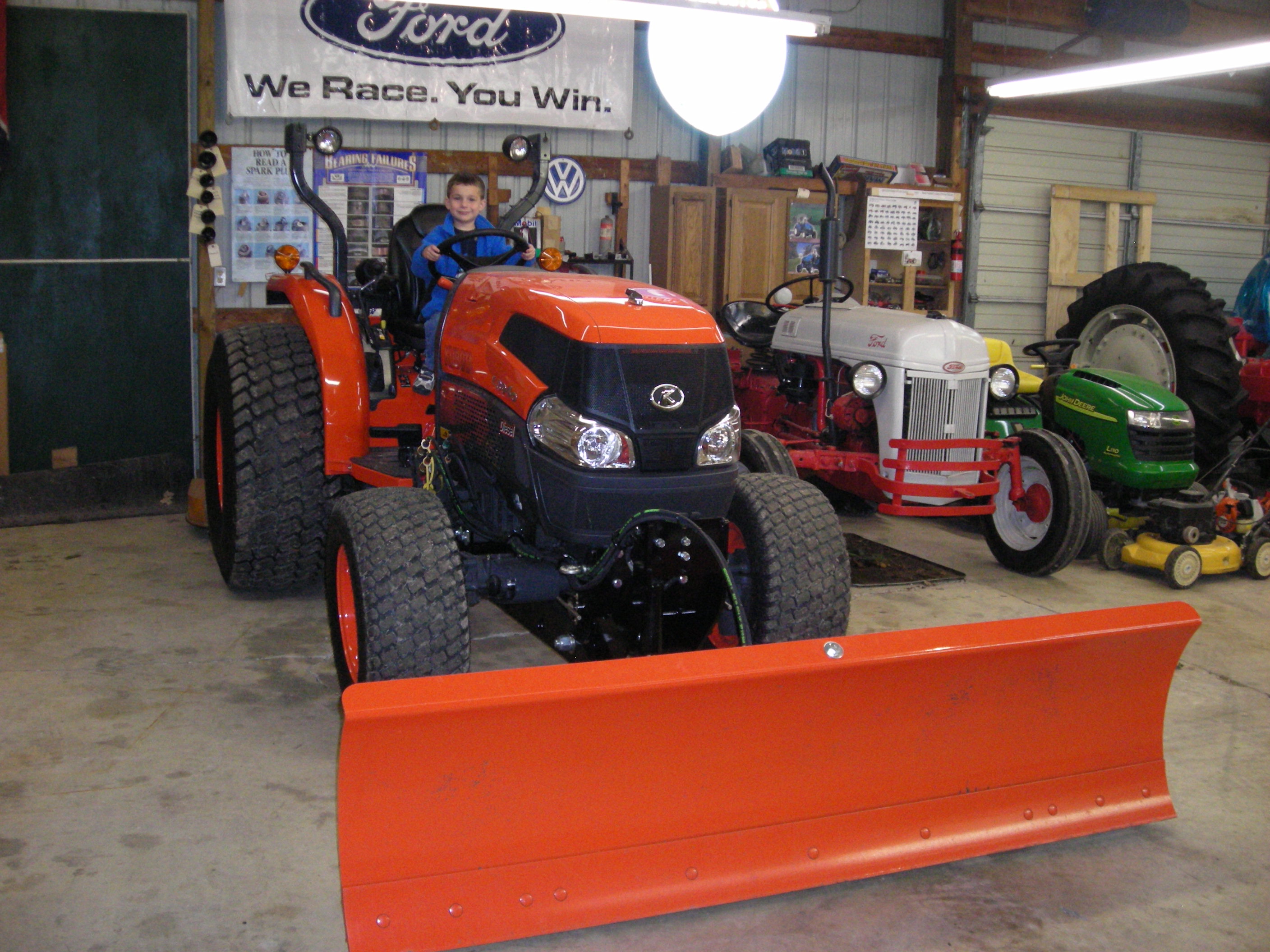

I retired my 1950 8N with a 2009 Kubota GL3940HST. Both operate a 72" rear discharge finish mower, but now I can run a 6' bush hog off of the Kubota. Philip.
