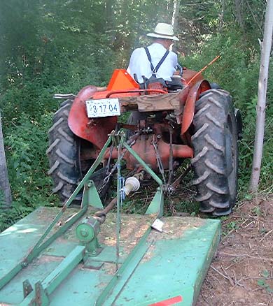

I don't know if this will help or not.

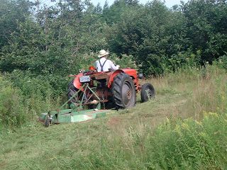

...or this

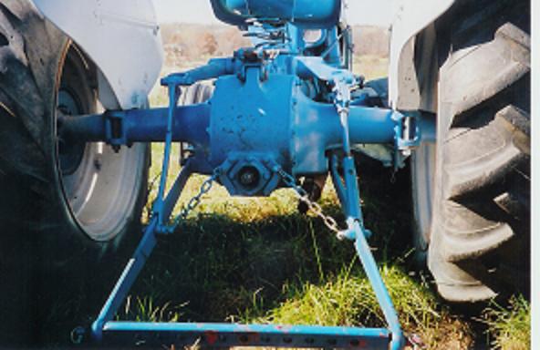

Here is a picture of my tractor.
Does it look like I have all the needed links?? Notice there is a place to at a link near the back right wheel, but not on the left??

</font><font color="blue" class="small">( Here is a picture of my tractor.
Does it look like I have all the needed links?? Notice there is a place to at a link near the back right wheel, but not on the left?? )</font>
Those links under the axle are for stablizer bars. Would be nice to have, but you can just use the limiter chains you have in the middle there as is.
You will remove the 3pt drawbar on the lower 2 arms, and hook up the brush hog there. Then on top behind the seat goes the top link. That _should_ come with your brush hog. If not, you will need to get one.
Then hook thepto up to the Over Running Clutch you are going to buy & put on your tractor. (That is important, or you will run into something without it. Seriously.) You likely will need to shorten the pto shaft to make it fit. As you raise the 3pt, the shaft will compress, and if it bottoms out it will wreck something. You will need to pull the pto shaft apart, and cut a littl eof each end, plus a little off each shield. Then slip it back together. Likely the shaft only slips together one way - if it is square & fits any which way, you need to make sure the knuckles on each end are out of phase from each other or the shaft will knock & hammer like heck when in use.
