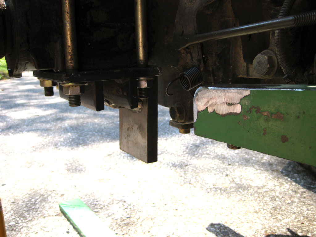

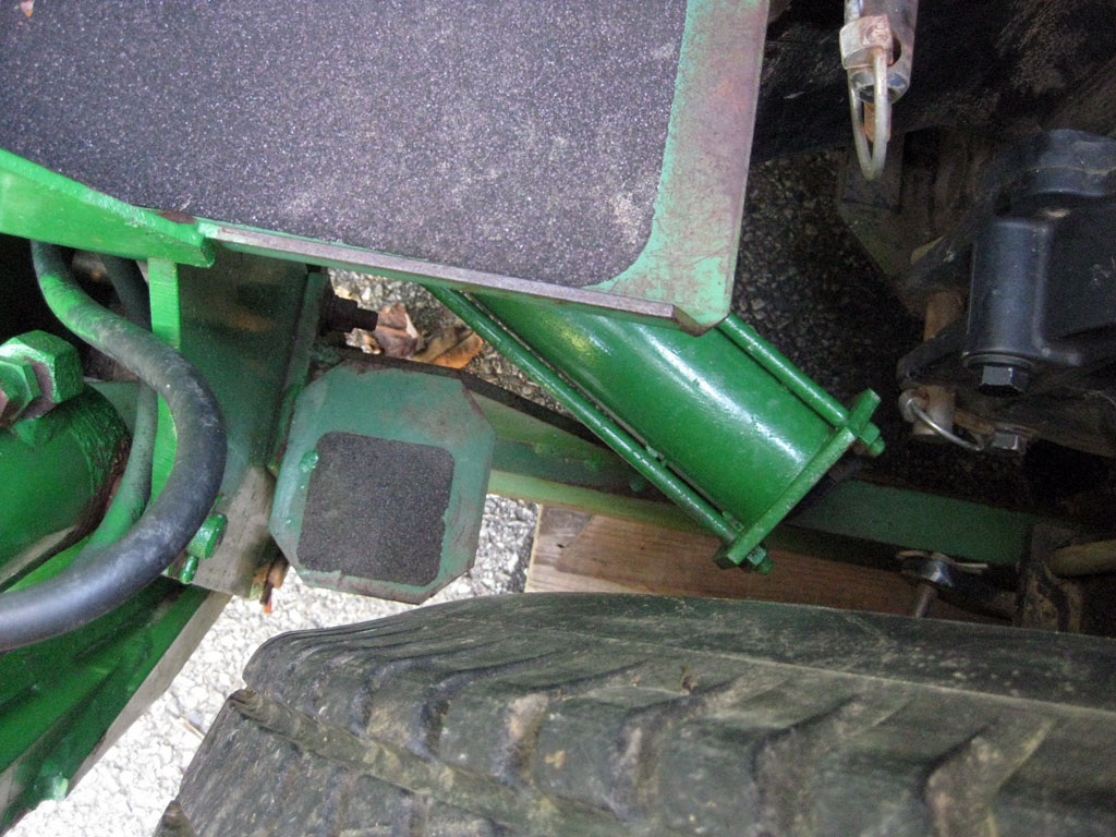

...I was surprised how close the hoe came in. I could take off the bottom corner of the PTO shield and the hoe's lower steps and come in another 1-2 inches. But then the stabilizers would 1/2" or less from touching the tires. Thats probably too close, yes?
I tried to keep my closest clearances to the tires at no less than 3/4".
One inch is better. Remember, you may buy new tires at some point,
and you should allow for more tread or manufacturer variation. I get some
slight flex on the outriggers, too. My hoe is very forceful.
I trimmed my lower hoe steps in half on my Kioti, and eliminated them
completely on my 4300. I tossed the PTO shield....what a PITA that is.
If either of those is your limiting factor, customize it.

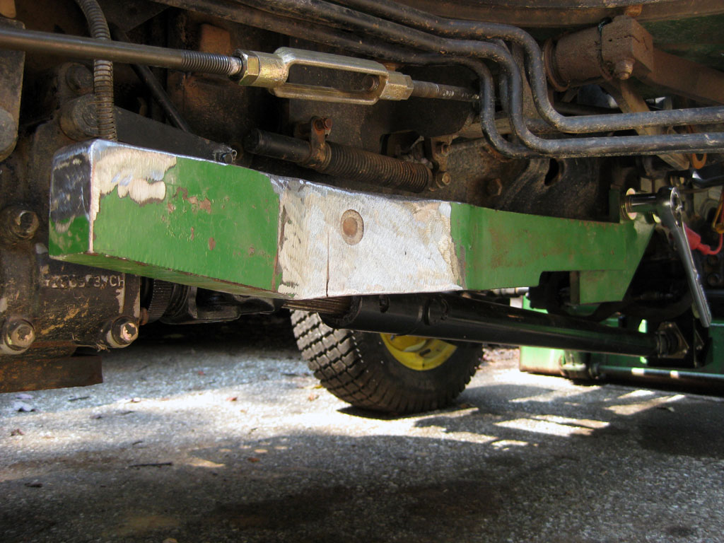

What do you think of adding a cross brace at the front of the frame that gets screwed to the bottom of the tunnel? There are two tapped holes there too. My initial concern is that it will be near impossible to remove this thing but my major concern is weight distribution.
A cross brace at the furthest point forward does not do much, since that
is where the forces are smallest. Also, since there are bolted connections
on both sides, it will have to be fabbed very exactly for width. Doable,
can't hurt, but more work. If you want to add more "rungs" to your
"ladder", add them in the middle. Your steel looks VERY thick there, so I
am not worried about twisting.

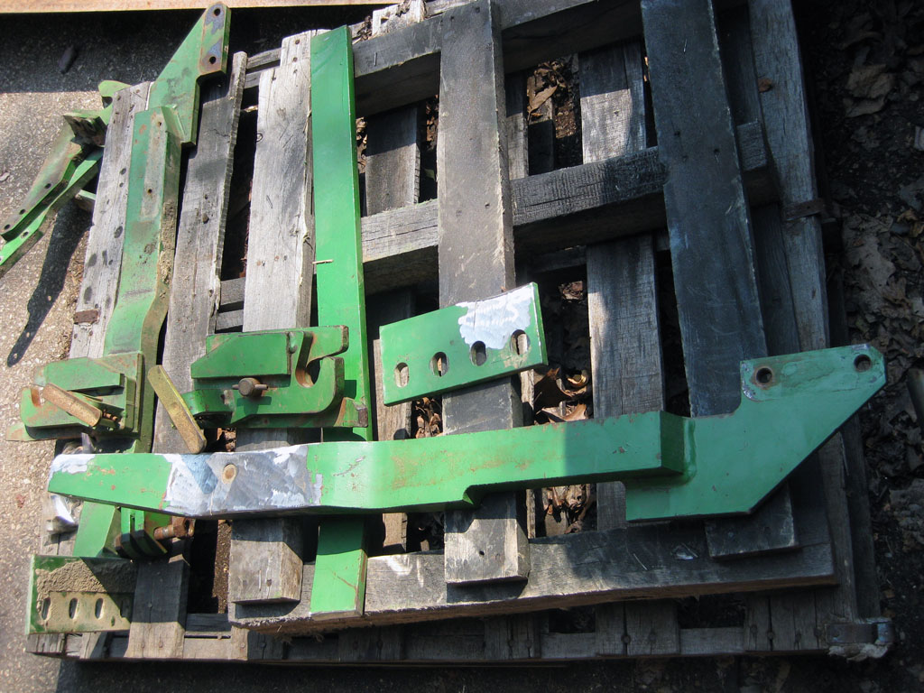

Nice work arrabil. Even though dfkrug makes this stuff look routine, it's still a pretty gutsy project to get a backhoe then make a subrame.

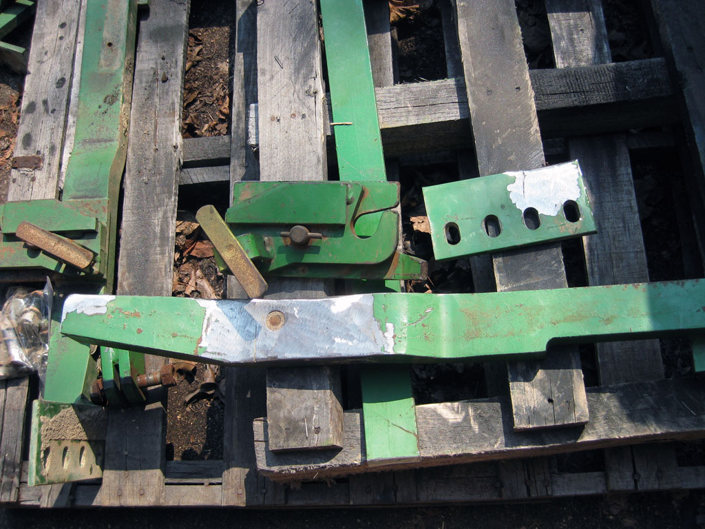

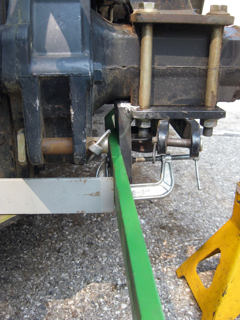

The first side is built and it was a perfect fit. The front bolts screwed in by hand after the rears were tightened. :D No pictures though. It was too hot to do anything today so I'll start the second side tomorrow. The two bolts I need for the second side are on special order at TrueValue anyway. They only had two in stock yesterday.
Seems I'm getting lucky all over the place. The estimated distance between my rear extensions is 20 15/16". The distance over the old subframe is also 20 15/16". Watch it not turn out that way when I get both sides installed!
Your steel looks VERY thick there, so I am not worried about twisting.
Since the 970 doesn't have a frame I guess they compensated for it with those brackets. Welding that stuff is a serious PITA. I have little weld burns all over my arm. The spray of BB sized weld beads that bounces off it before it gets hot enough to take the bead is like 4th of July Sparklers. I guess this is why TIG is so cool. Doubt I have enough dexterity to control three feeds at once though.

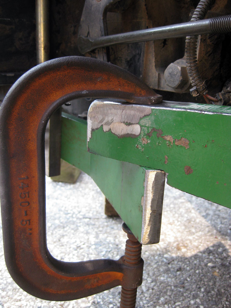

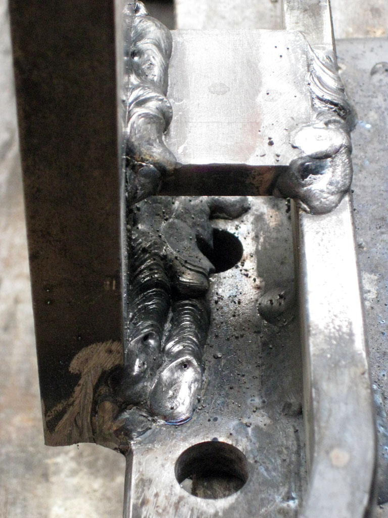

That's why welders wear leather jackets or sleeves, Arrabil!
TIG is neat, but it would take multiple passes on steel as thick as you're welding. OK for short repair welds, but not much fun for longer passes.
If you beveled the areas you need to weld, the steel will puddle faster and you'll get better penetration. Preheating would help too, but that requires an oxy-acetylene rig with a rosebud.

I got a welder's blanket that I cover up with but it slides off my arms as I move around sometimes. A whole welding suit is an expenditure I've yet to decide to make. Its frickin hot out there too!
I am beveling, btw. I wouldn't trust the strength of it without multiple passes here too. No ability to preheat though.

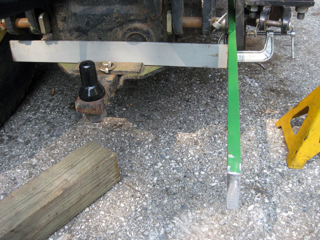

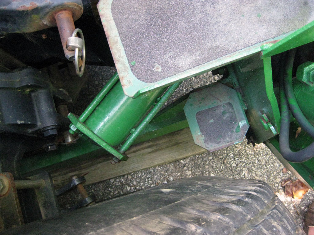

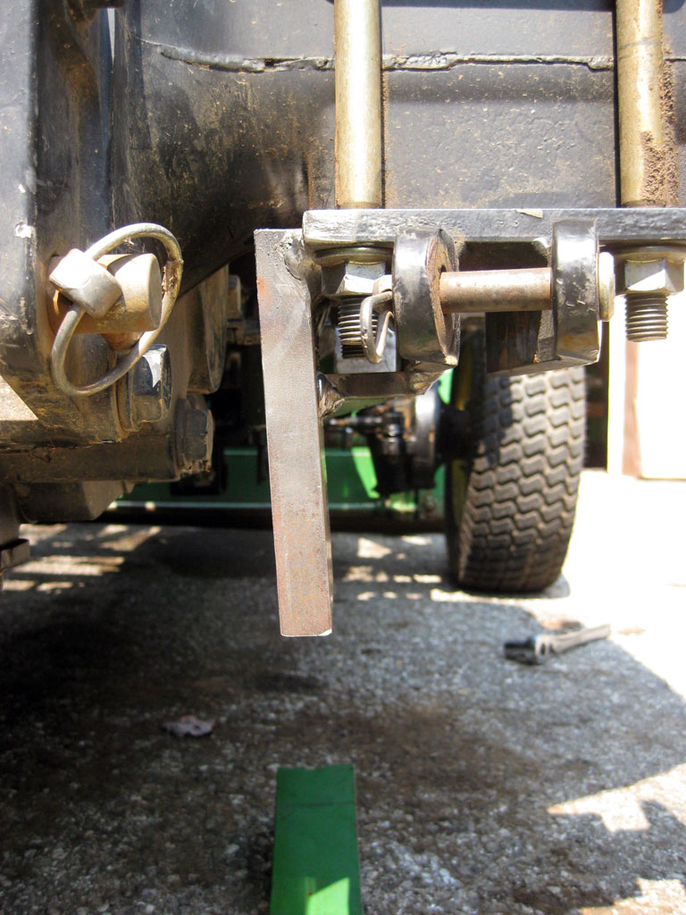

With the tractor only 3.5 inches off the ground the seat already clears. Thats great news as it means one less thing to worry about.
And although I didn't get exactly centered during my trial fit, you can see the tires and PTO cover clearances. The 8B has the pivot cylinders sticking out behind the operator platform. Probably because its so far away from the 970 anyway. But I can get it really close to the back of the 4200. More great news.
I have a question here. On the 8B, do the ram housings pivot as the boom swings or are they fixed? If they pivot, you might have clearance issues with the tires when you swing the boom. Hopefully they're fixed and it won't be an issue.
/ 8B Backhoe On A 4200?
#28
They're fixed. They pull a chain back and forth to swing the boom. I've heard the chain was a week link on the 8A but that it was fixed on the 8B. Hopefully thats actually true.

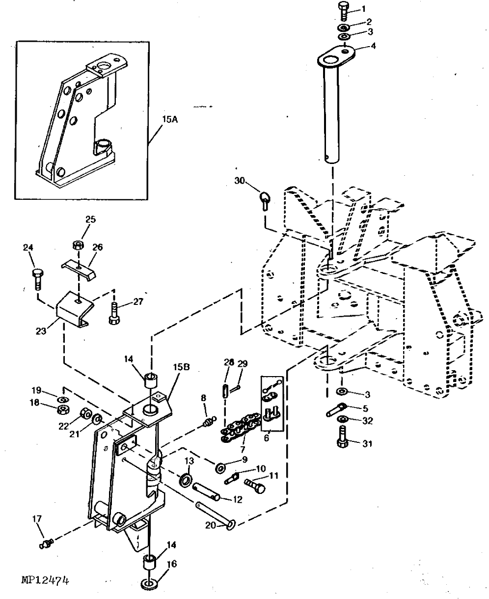

I attached the chain parts breakdown. Makes a lot of sense. Just never seen it anywhere else either.

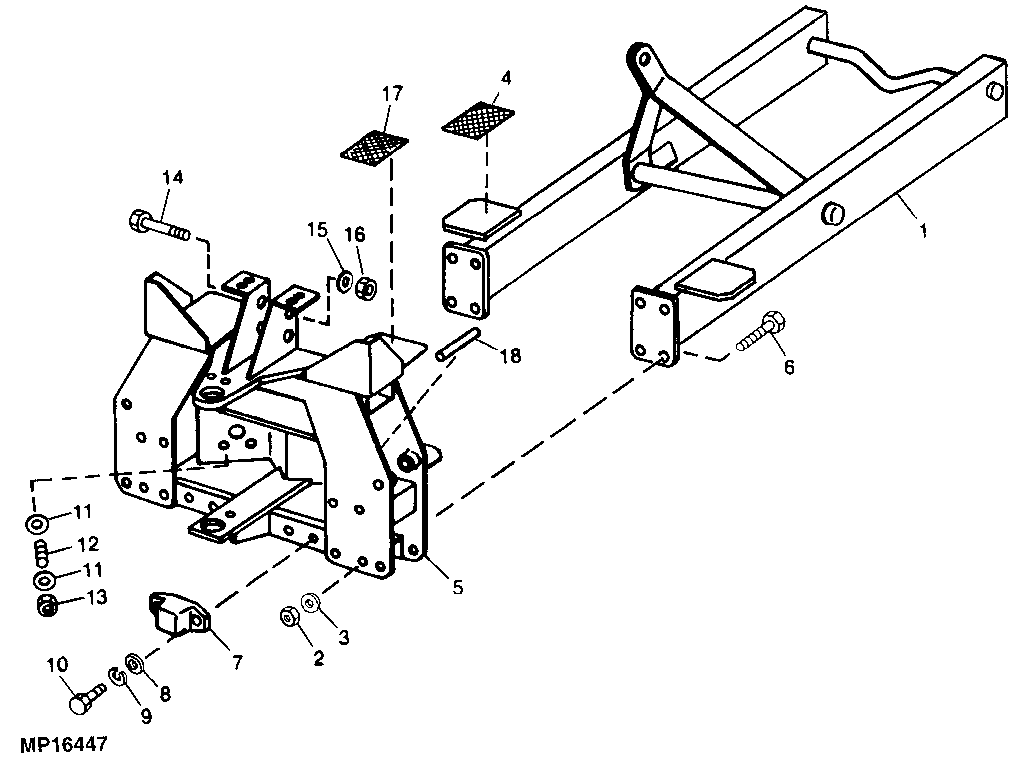

So heres a questions for you guys.... check out the attachment....
See bolt, nut, and washer, #2, 3, and 6? Mine are installed in the other direction. Which has been bothering me because its a lot harder to line up the way I have it. Which do you think is more likely: the picture is wrong or the original installer put them in backwards?
I wish I had a manual for this thing. Can't even find one on eBay.
I suggest you go with how it's shown in the illustration. That backhoe has been around for at least ten years and it's no telling how many times someone's been in there tinkering.
I'm with Roy. I'm not sure that it would matter, but then I'm not an engineer either. I would trust the book before I would trust the way some unknown person did it.
Hmm. I'm gonna have to look at it some more. I need to weld that side to the frame. I think it has to be the nut because I'm pretty sure the bolts hold the cylinders in the frame. I guess I'll get to that towards the end of the week.
I might be missing something, but it looks like 11, 12, & 13 hold the cylinders to the frame.

#38
So, no, those bolts don't hold the cylinders. It just looks like that before you look closer. I think I have to keep mine installed backwards actually. The bolts hold these tubes in place and I need them to stay put while attaching the hoe to the subframe. I'll figure it out shortly....
Some new pics follow in a minute.

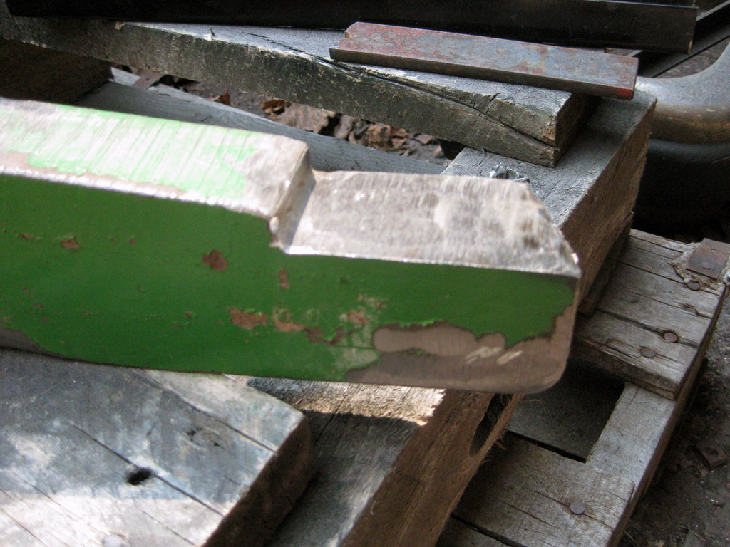

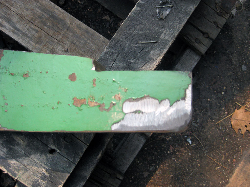

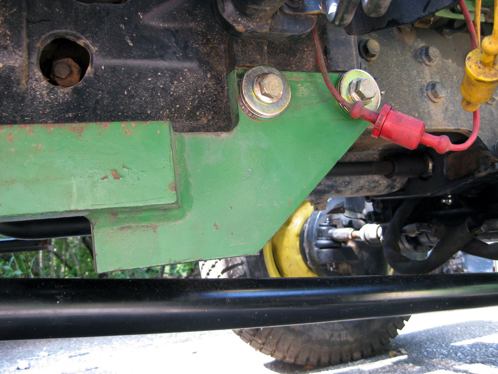

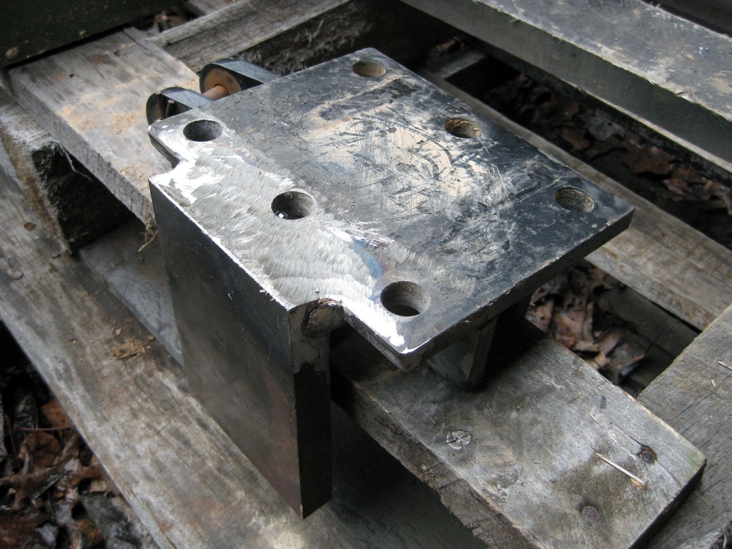

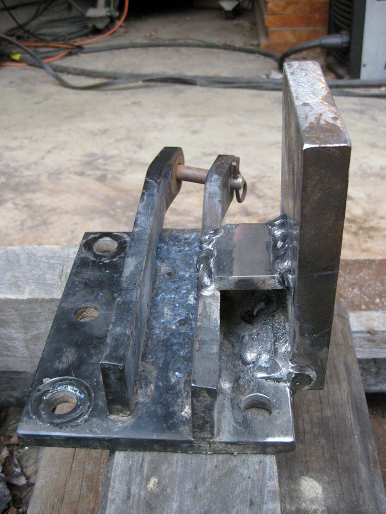

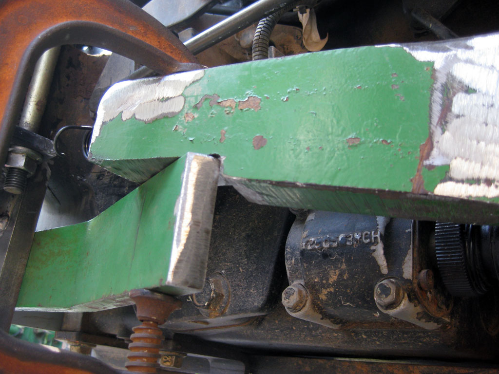

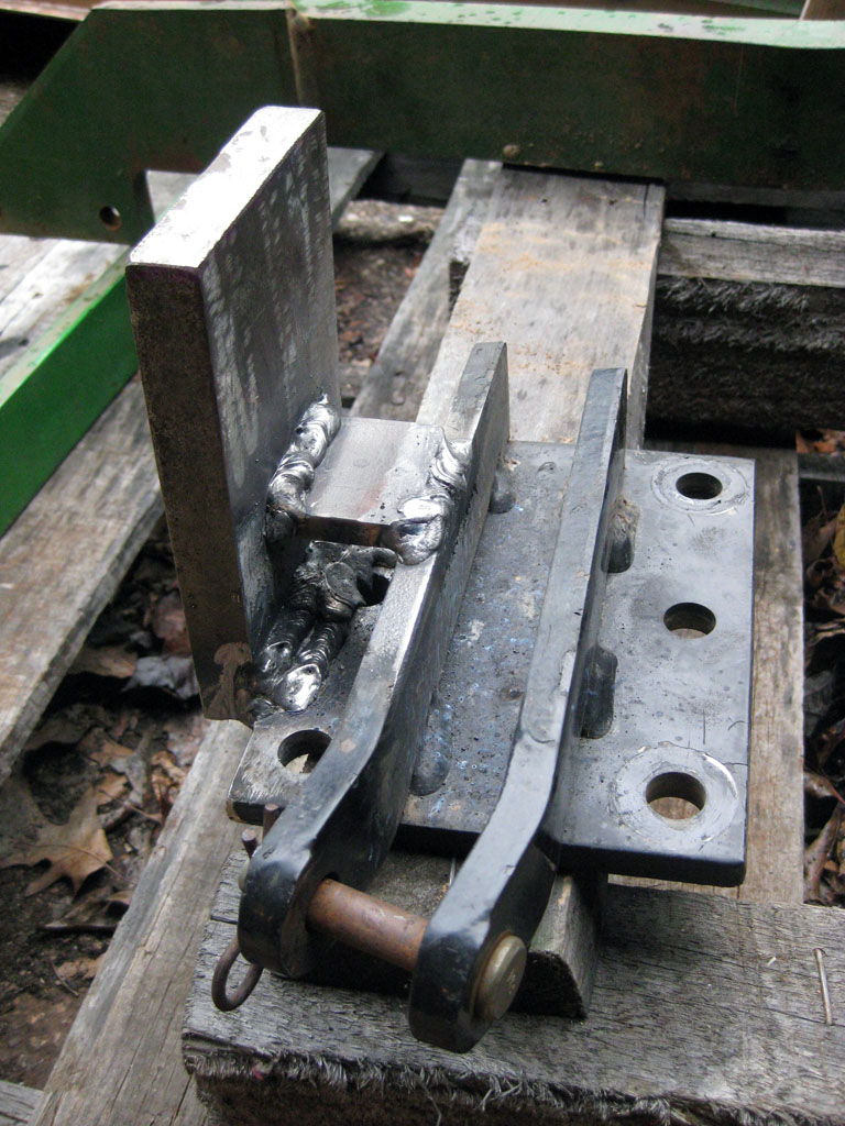

I added the second ROPS bracket extension and took more pics of it than the first one. This one didn't come out nearly as crooked. Still not perfect but it doesn't really matter. You can make fun of my ugly welds this time.
I got the horizontal extension cleaned up too. It looks like its welded together lower than the first side. I'm gonna have to take both sides and line them up and make sure of that. Pics of that as soon as its not raining for the whole day!
