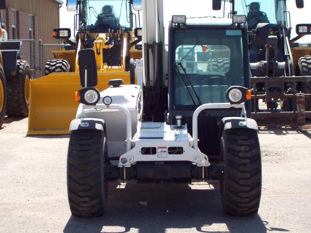

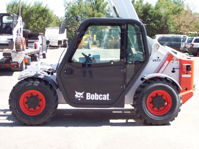

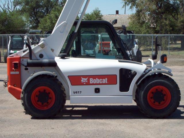

My Bobcat V417 Versahandler uses motor oil, like dirt ditch ​listed.
