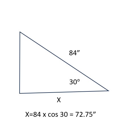

Would a 84” ssqa snow blade turned 30 degrees be as wide or wider than a tractor that has a 72” wide tire track?
   / 84” ssqa snow blade on 72” wide tractor #2
Barely but yes
Thanks!
I figured there was a formula. I probably was taught it in school but it obviously wasn’t retained.

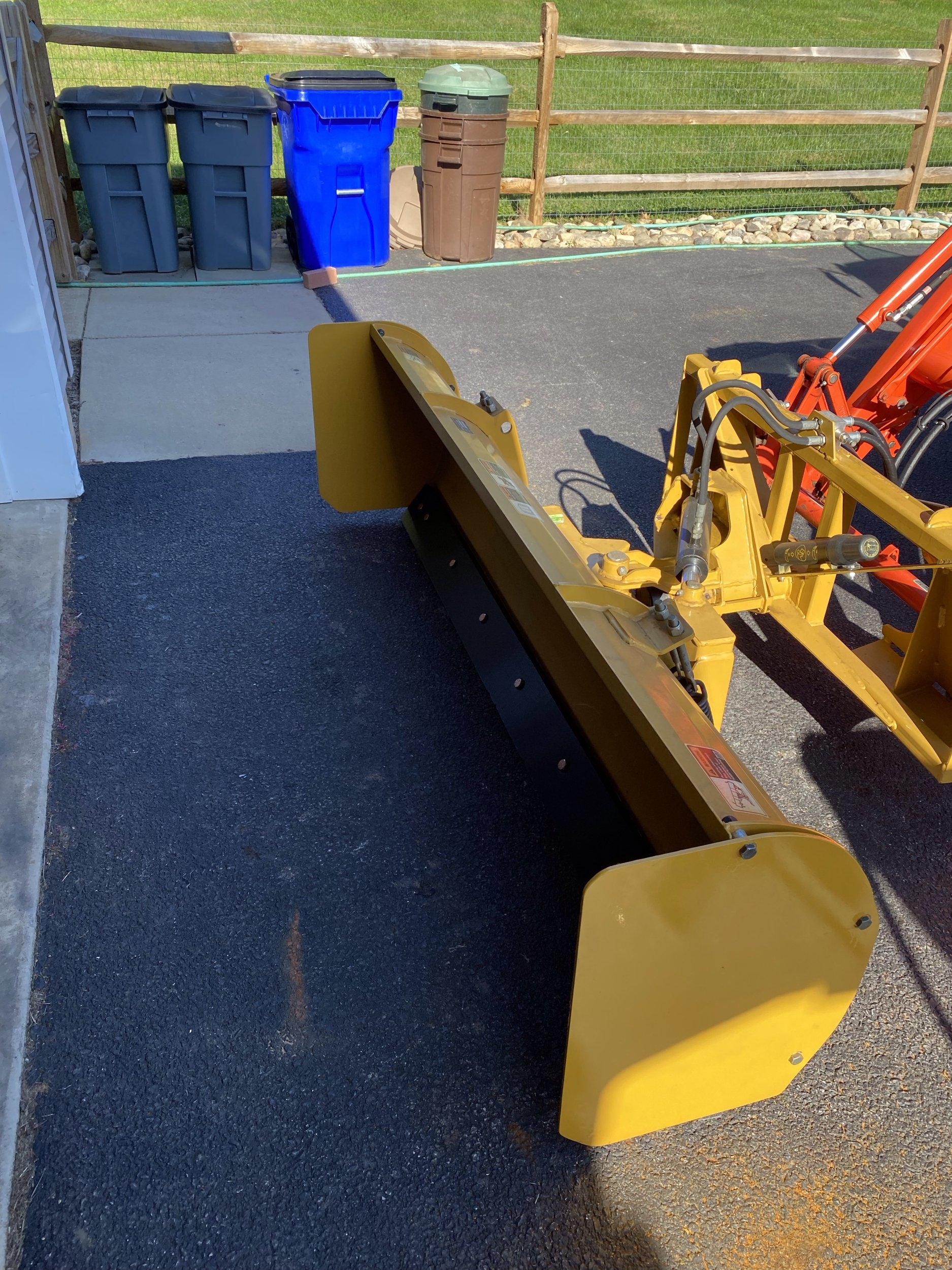

I run a 7' ssqa plow on my 72" wide tractor. I rarely angle it at 30 degrees because wet snow starts to push the front end around, and it rolls snow fine at a much less angle.
I recently added side plates on the plow, so this season I don't angle it at all except around turns and to square up to a pile.

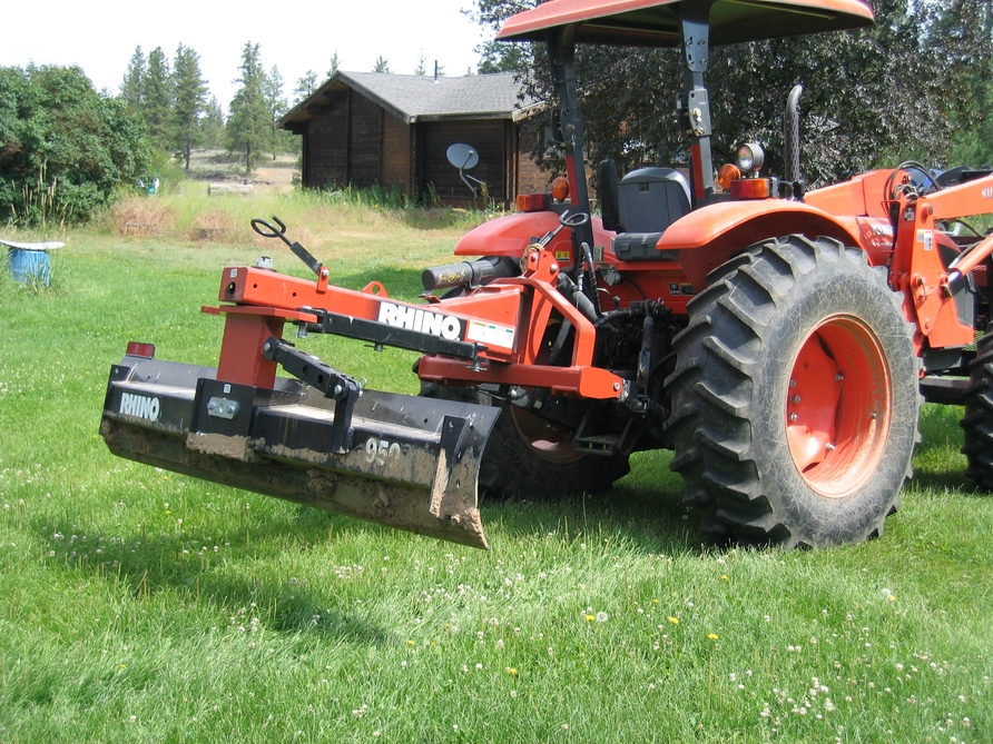

   / 84” ssqa snow blade on 72” wide tractor #5

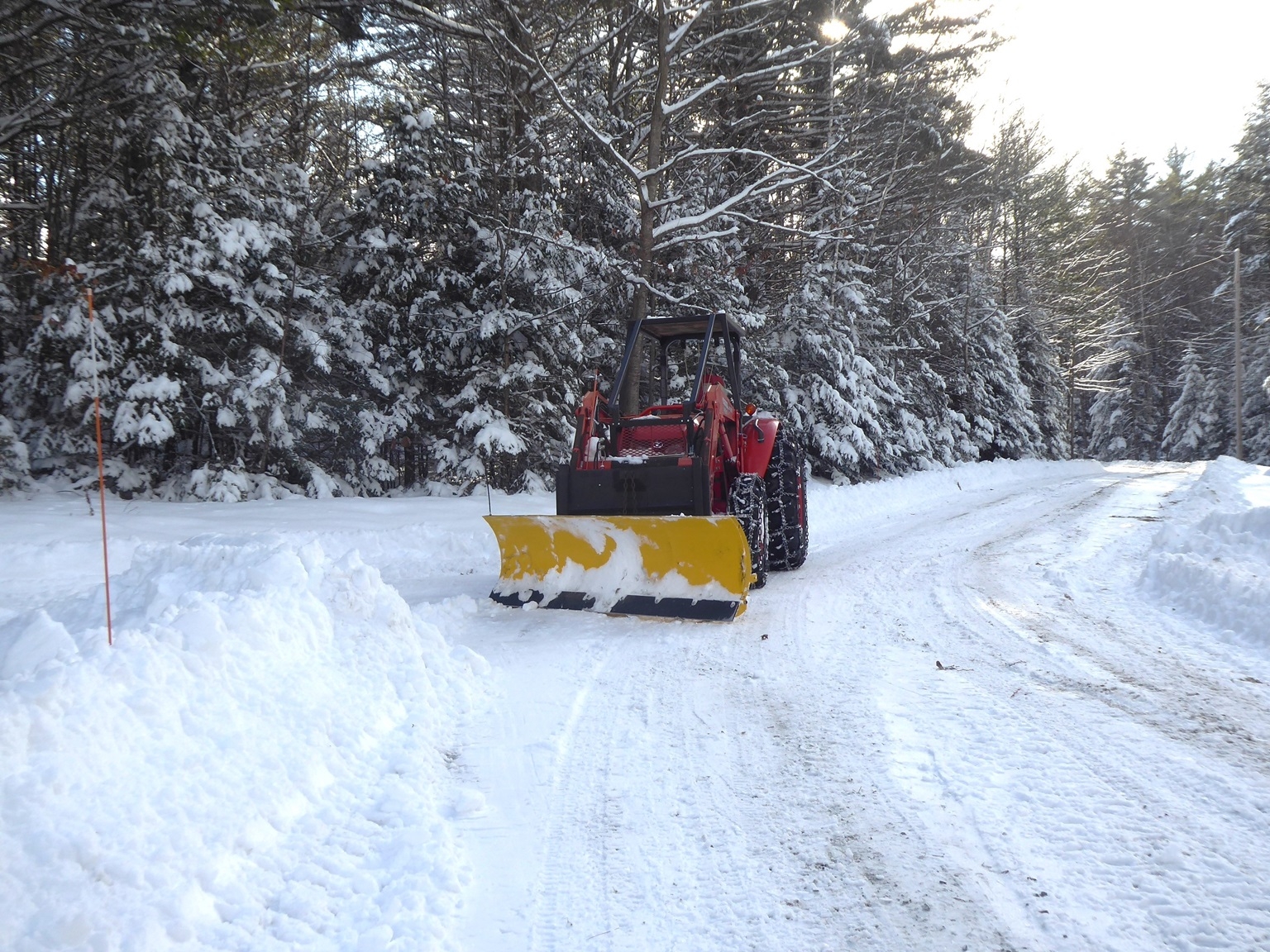

This is my 96" HD Rhino rear blade. I offset and angle when blading snow. Offset because there are a couple drop-offs on my driveway. Offset keeps the tractor a little further away from the very edge. When angled my blade will cut a 76" to 78" swath for light, fluffy snow. Less for wet, heavy snow when I have to angle more.

So you basically turned it into a snowpusher?
   / 84” ssqa snow blade on 72” wide tractor #7
I suspect You will be running over snow when angled since some snow seems to always roll back from the windrow.
   / 84” ssqa snow blade on 72” wide tractor #8
A smaller capacity, but yes. I have since added UHMW Polyethylene closing the gaps on the side plates. I plan to remove the side plates for larger snows, as I have several very long drives I plow. 6 bolts and they're off.
