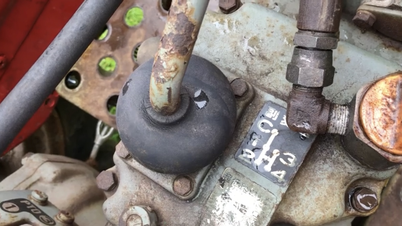

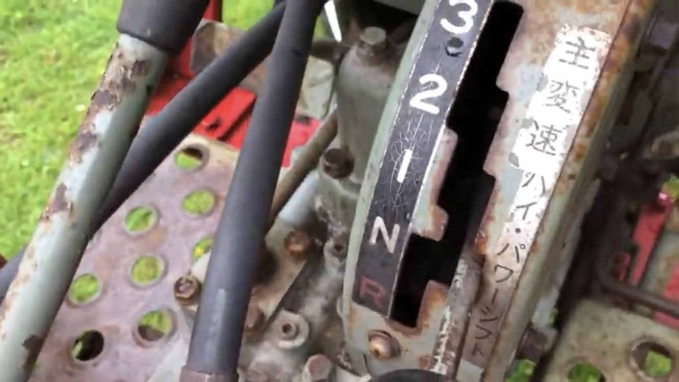

Your 2610D is a power shift tranny this is indicated by the xx10. IMG_6808.JPG
This is the power shift lever providing 1 reverse and 3 forward gears.
This is a range selection lever you have 5 options here. C=crawl you may never use this range then 1-4. The first picture you have 3 forward and 1 reverse in each of the 5 ranges.

The lever with the 3-2-1-N-R. Move this to N. This is the Power-Shift.
The stick to the left selects the gear range. You need to depress the clutch all the way to put this in a gear. Try the one marked 2.
You can then lift up the clutch all the way. Let the engine RPMs be at 1,200-ish.
If nothing is in front of the tractor, move the Power-Shift from N to 1. In a few seconds move to 2. The again to 3.
You are moving along in gear range selection 2.
To brake fast or stop, slide the Power-Shift to N and use the pedals on the right foot. OR Left foot clutch and right foot brake.

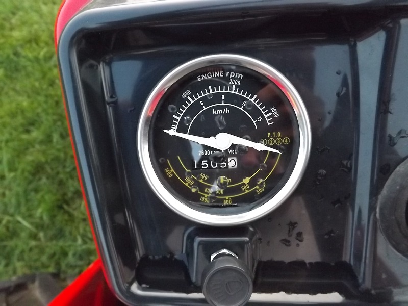

Now for the PTO. This tractor has 4 PTO ranges. You can see the selector to the left side when sitting in the seat.
Yanmar PTO selection speeds are as follows for the engine at 2200 RPM.
1=542
2=685
3=1005
4=1268
HOWEVER, you can manipulate the engine RPM and the PTO selection choice to arrive at different PTO output speeds. Making it all variable. BUT, it's EZ to understand the knack about it.
Put the tractor in neutral and we'll check this out. increase the engine speed to 2200 rpms. Then with the clutch, put the PTO selection to 1. let out the clutch. turning to the back, the PTO is spinning at 540rpms. The TACH image below (I had just washed the tractor), shows the needle with the tractor off. When the engine starts, the left top swings right. When it swings right to 2200rpms, the bottom of the need points to 540 (500+). Slow the engine speed down to 1800rpms, use the clutch and pick PTO 2. Guess what, you are back spinning the PTO at 540 (500+) once again. Likewise PTO selector 3 at 1400 rpms and PTO selector 4 at 1200rpms.
Why in the world would anyone want to do this??? Well, if the tractor is running a wood chipper or a PTO 5KW generator for power, it makes all the sense to run in PTO 3 or 4 to arrive at the 540 (500+) speed and SAVE ON FUEL.
I run the brush mower on PTO 2 and engine speed 1600 while the Gear selector is in 3 and the Power-Shift is in 3-1 or 3-2. Not only does this save on fuel, the mower runs at it's comfortable speed and the engine isn't working sooooo hard. Plus the hour meter isn't spinning up a storm. All is peaceful when mowing. Plus you will not drop your sweet tea while mowing the back 40.

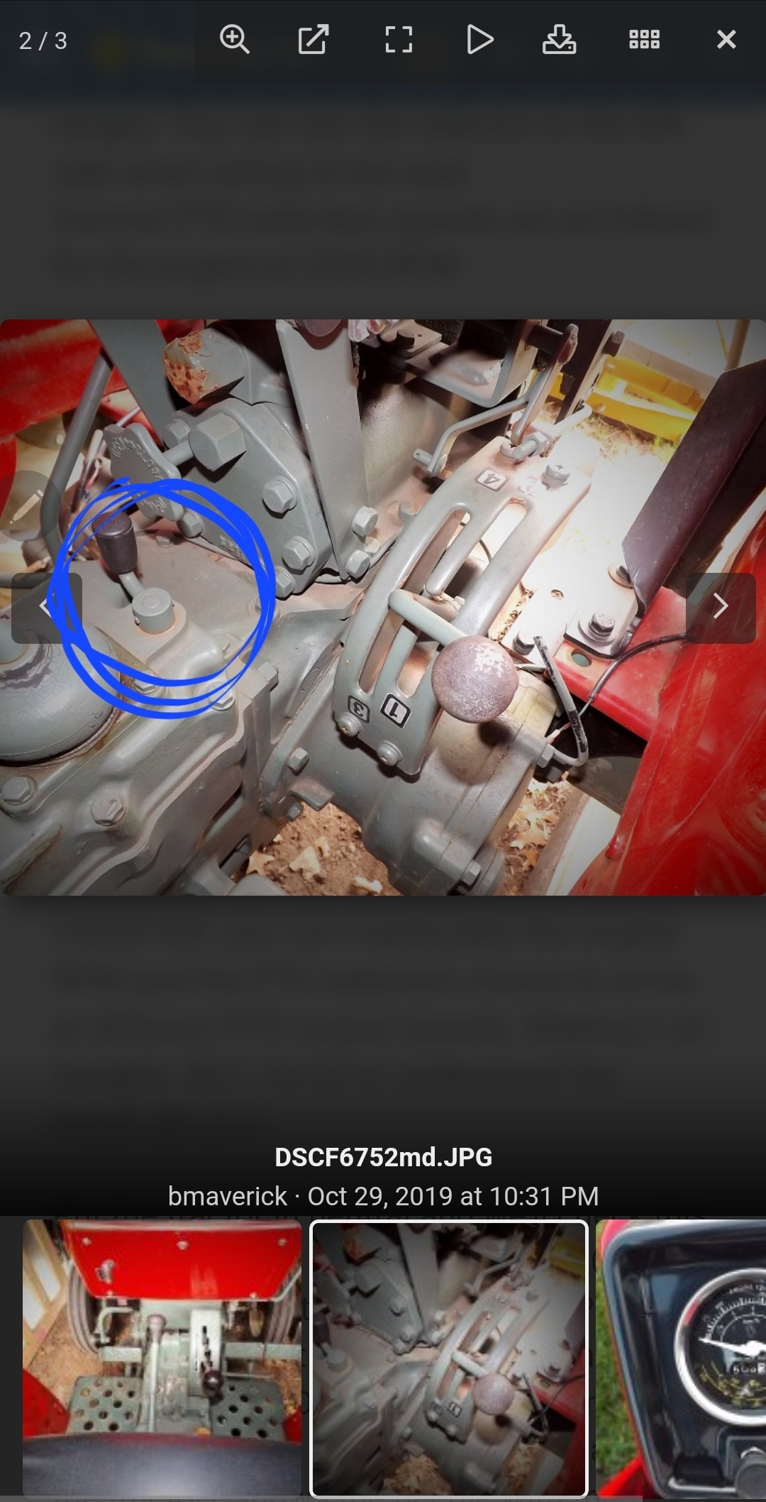

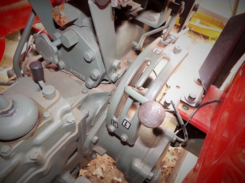

Good morning, I would like to know what is that little lever.
Also, my gear selector is not going to 3rd or 4th.
Thank you

I do not own a ym2610, although a friend did. I believe your tractor has a 3 forward speed with 1 speed reverse in 4 ranges.
If this us correct you are not getting into 3rd and 4th ranges.
A couple of things—be sure you are completely stopped and clutch is completely depressed. While your speed gears are able ti be shifted without a fully depressed clutch or full stop, I don’t believe your ranges will.
If this does not correct it, check for bent linkages or linkages that are not free to move external to the transmission/differential. If these are not moved regularly, they can “freeze” due to rust/corrosion. Often a decent penetrating oil and light tapping with a hammer while working the linkage will free them. Worse case is you have to take them apart to clean up good. As with any moving part these need to be lube on occasion.
Sorry I have no ideal about the lever.
/ 82 yanmar 2610d #11
The lever -might- be to unlock access to use the creep, ultra low, range. But that's mostly a guess based on reading stuff here.
ding ding ding, you are 100% correct. It is the Creeper gear.
How to activate it.
- Place the PowerShift into neutral
- push in the clutch
- push the gear selector into 1st
- now flip the creeper lever and push-wiggle the gear selector further forwards in 1st
- The YM2610 is now in creeper mode
You can now operate the machine via the PowerShift. Howbeit very slow moving!
Why use creeper gear? It is PERFECT for pulling fences tight! It goes very slow, enough to control the loose to full tension needed on a fence.
