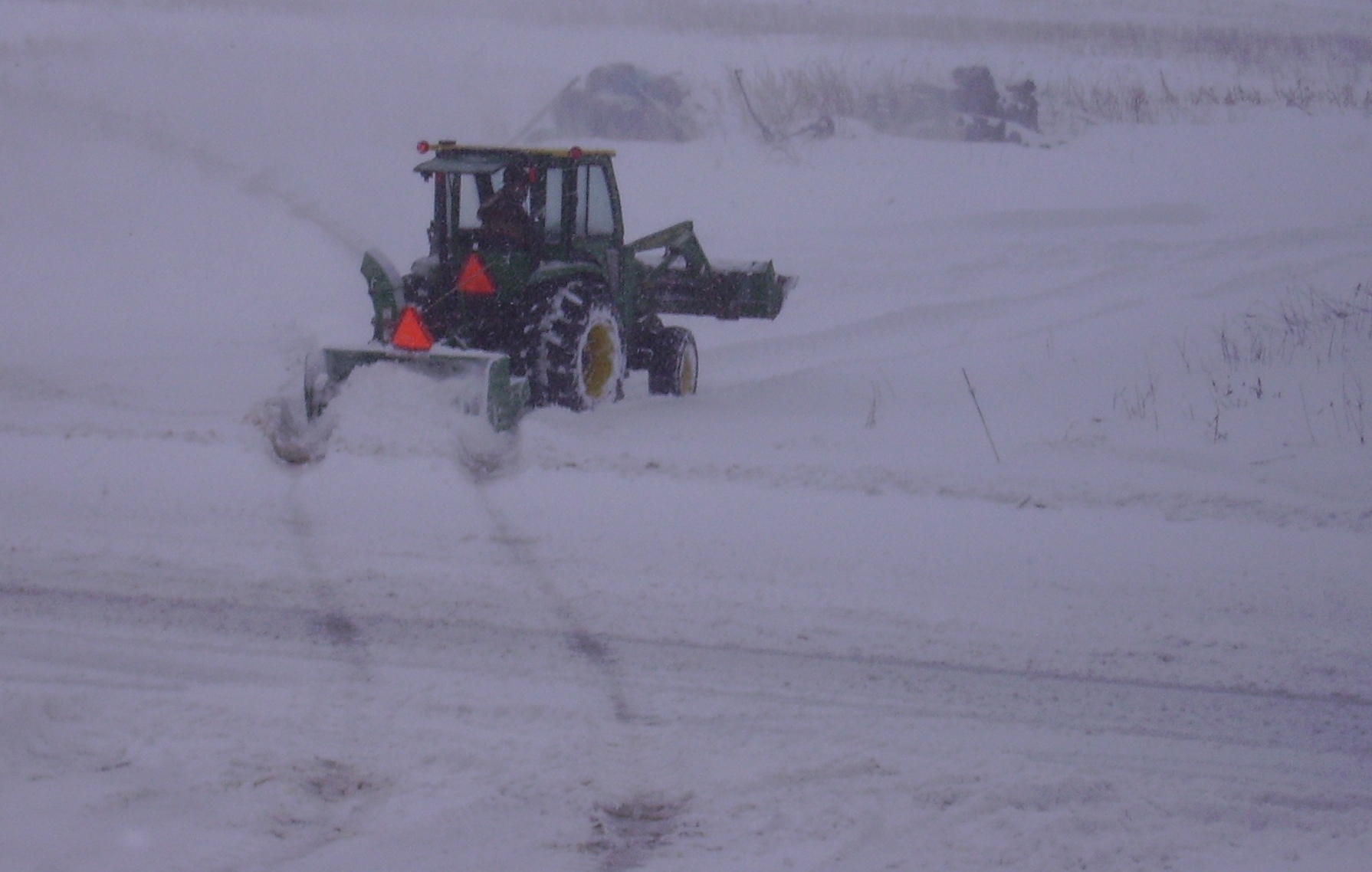

I live in Pompey, NY, in the hills southeast of Syracuse. We don't usually get Tug Hill snow amounts, but we have our moments. Coastal storms, like the Blizzard of '93 (The "Storm of the Century") tend to hit us harder than they do Tug Hill.
The JD 4600 and the 1165 snowblower we have now will move a lot of snow. I wish we'd had it back in '93. Officially, Syracuse got about 4 feet at the airport, but we're guessing we had about a foot or so more than that. It was difficult to measure, as it was blowing around a lot. At the time, all we had to move snow, other than shovels, was a homemade plow on the front of my grandfather's Case SC tractor. With a 10-foot drift across the driveway, it took us half a day just to open a 100-foot path to get the tractor from the barn where we keep it to the road, where we could cross and attack the house driveway.
