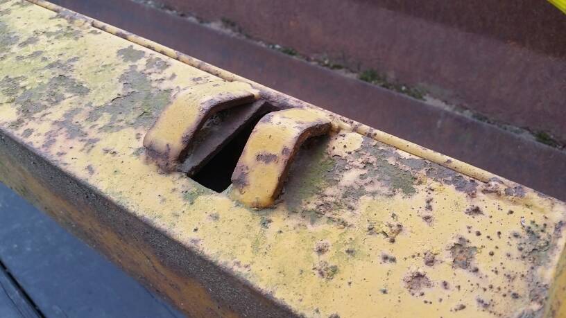

Here's a pic, it looks like they take a pin and the opening is 2 1/2 inchesView attachment 463005
Yep. That's how my KK is built. When searching for scarifier teeth you need ones with holes drilled in them for the pin. Make sure the width and thickness of the teeth will fit your BB. Then you need to buy or build some pins. KK uses a similar pin to what holds a hitch receiver in the tube, but shorter. Anything you can rig up will work.
Here is what I am looking at Agri Supply, it looks like they will work. They also have the pins.
Agmate(R) Box Blade Shank, 18 In. Long, 4 Hole
/ 8 foot back blade too much? #23
Yep, looks like they would work.

I got the scarifiers and they fit
perfect. I still have the backhoe hooked up so haven't had a chance to try it out. Snowed here yesterday so everything is a little muddy still. I hope to try it out Saturday. uploadfromtaptalk1460318225814.jpg
