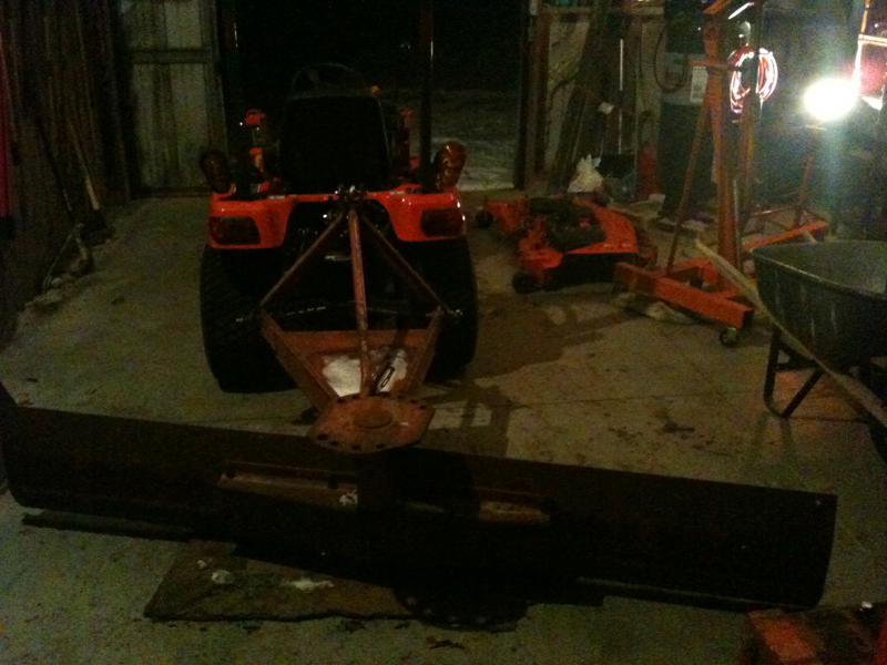

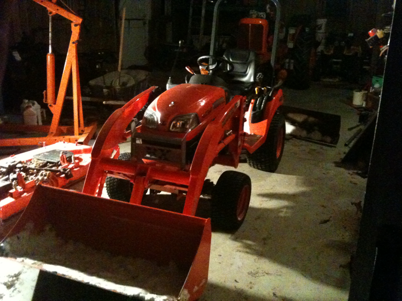

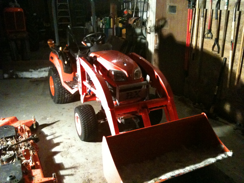

Not too worried about loosing traction, my drive could be used to calibrate levels - there is a small rise going up to the garage (1ft rise over 35ft), otherwise the only risk would be falling maybe 2 inches if I were to drive off the blacktop. My biggest fear is for the health of the tractor as this is a big heavy (450 to 500lbs I would guess) plow that would pull a lot of snow. But if the only risk is loosing traction, I feel pretty good about it. Here are some pics of it in the barn. You can really see how big the blade is compared to the tractor in the view from behind.

There are holes in the top where a pin should sit to hold it's angle so the use of angle iron shouldn't be needed. My guess is the previous person probably just lost the pin and welded the angle iron to keep it from moving. Buy a large pin and set your angle and stick the pin through the hole to keep it there.
/ 7ft blade on BX 2360 #17
I agree- At first without pics of your backblade, I thought you had a onee of a kind or custom made backblade. judging from pics, you can cut that angle iron out and use a pin/bolt/etc instead in the holes.
/ 7ft blade on BX 2360 #18
In my snow plowing experience, I"d say 45 deg is too much. Mine is closer to 22.5 to 30 degrees. I'll have to try to figure it out the next time it's on.
