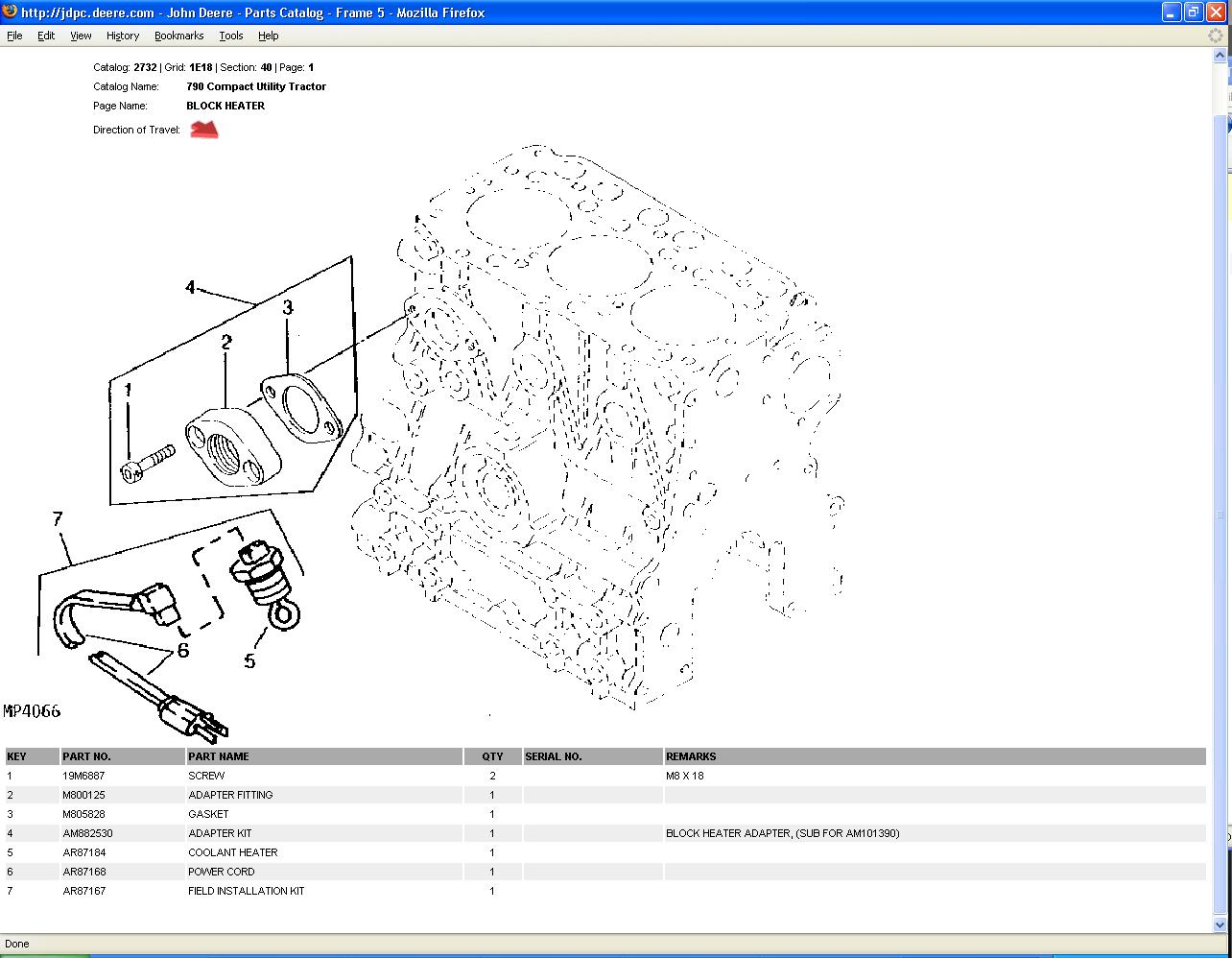

I have a 790 tractor that I would like to put a block heater on. I like the frost plug style heaters and saw the left side of the tractor has an easy-to-get to plug that I had planned to use (measures 1.175".....so it must be a metric size plug) and its at the back of the engine block. I didnt find any mention of the heater in the JD operator manual.
HOWEVER...when I went to the NAPA store to get the heater....the guy behind the counter comes up with a thread-in plug. I have an older (02?) 790. Do they have a threaded spot in the block for a heating element?? I would prefer that....but have been unable to locate that.
Anyone put a heater on the 790? What did you use? Also, is there a way to check the serial number for the production year? I think this may be an issue with parts as time goes on......so I better find out for sure. As my 790 has a model 70 loader.....It may be a bit older model than I thought when I bought it. :(
/ 790 block heater?? #2
http://www.phillipsandtemro.com/UserFiles/File/ZEROSTART_Catalog_WEB.pdf
Head on down to the Yanmar section...PG 65 in the catalog
Looks like the same setup as what was on my F935...JD wants you to buy a ton of parts...see attached...
I went with the Zerostart PN# 3500001 which was basically "Everything in one" and it only cost 35.00 for the whole shebang including the cord and even the installation bolts. Dunno if it would fit yours....
I'm guessing if you keep what you got, you'll need to get the adaptor plate from JD: "M800125 - ADAPTER FITTING"

I finally removed my loader and that allowed me to get the engine side panels off to see what I needed. There it was....a nice little threaded plug to install the block heater. So.....off to the JD store to buy a block heater. Thanks for the information.....I did not know that plug was there. NEAT!
