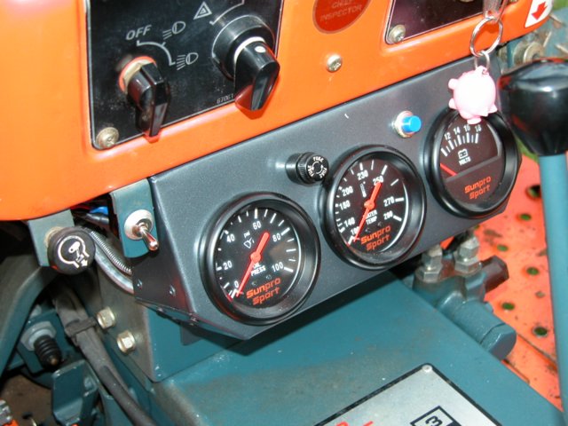

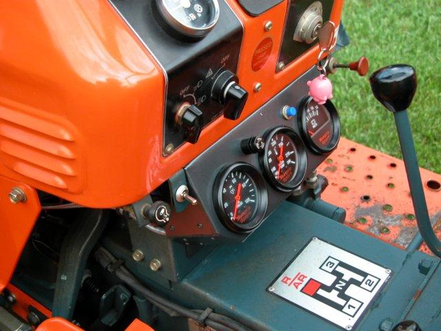

/ 77 245DT oil pressure help #14
With a '77 tractor, you might benefit from adding more gauges to watch its operation. I added a trio to my old B8200, cost me under $20 (and the time to mess with everything) but I liked having the gauges, just to keep an eye on the engine systems. Oil pressure, coolant temp. and volts.
