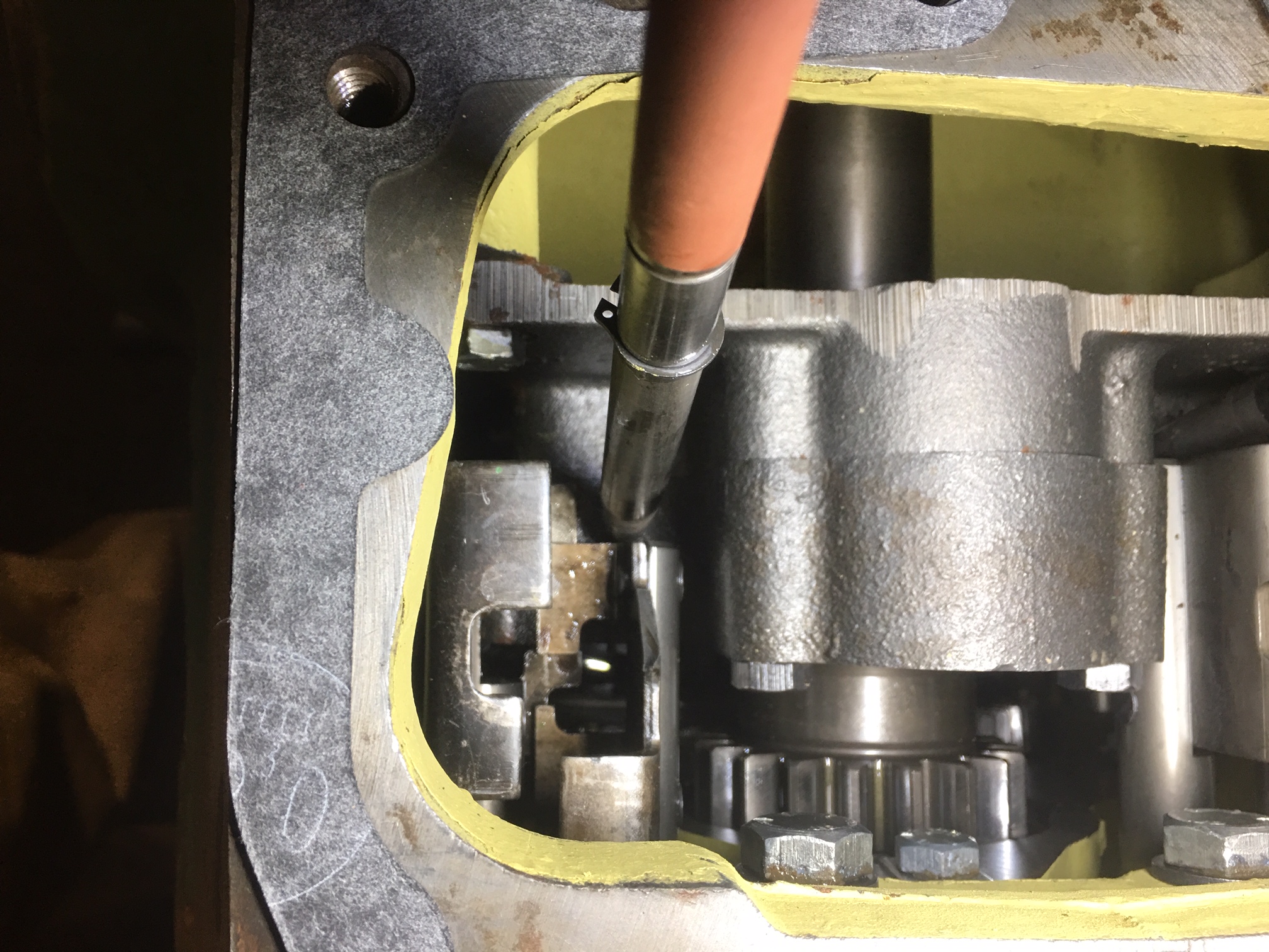

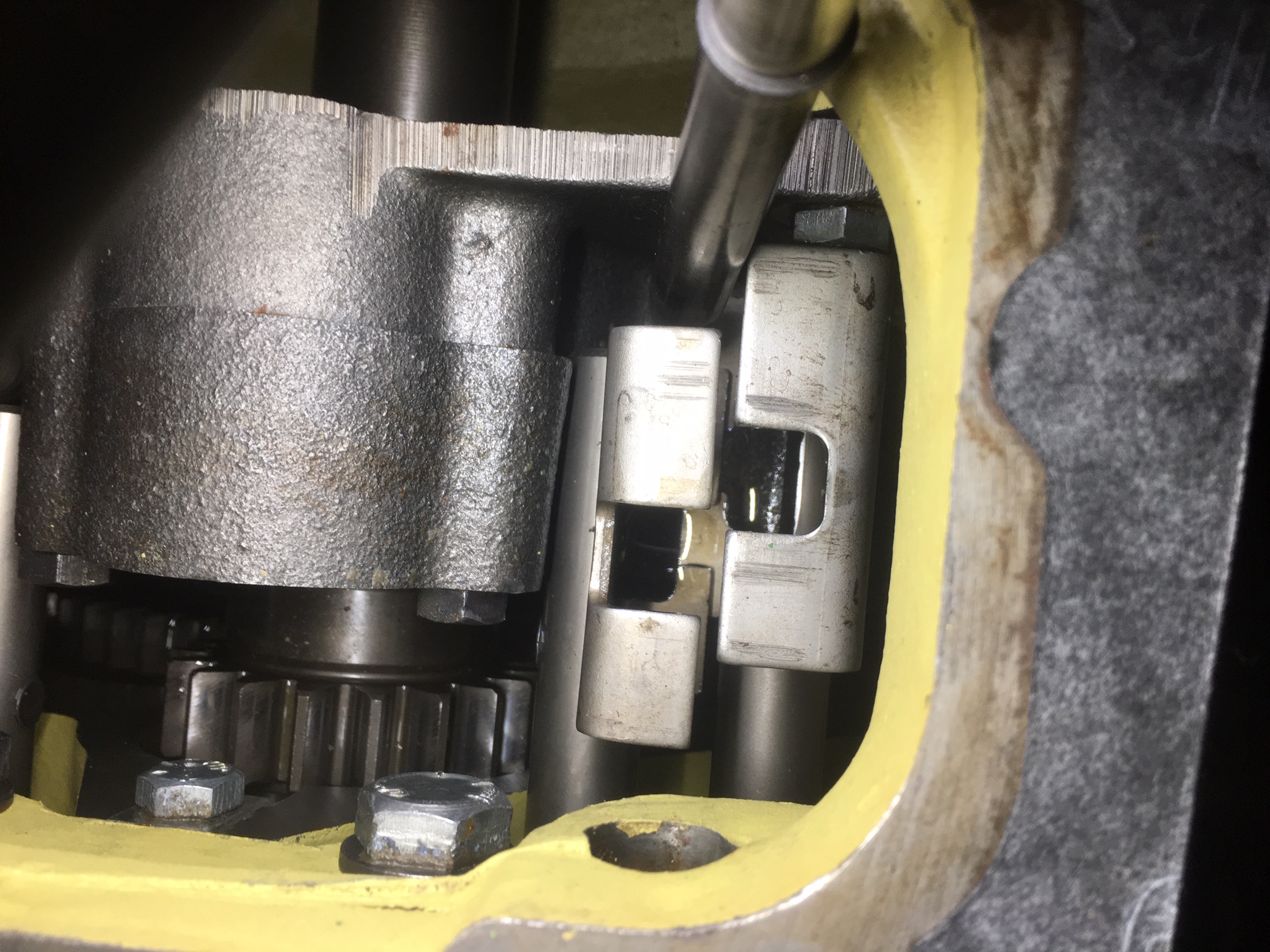

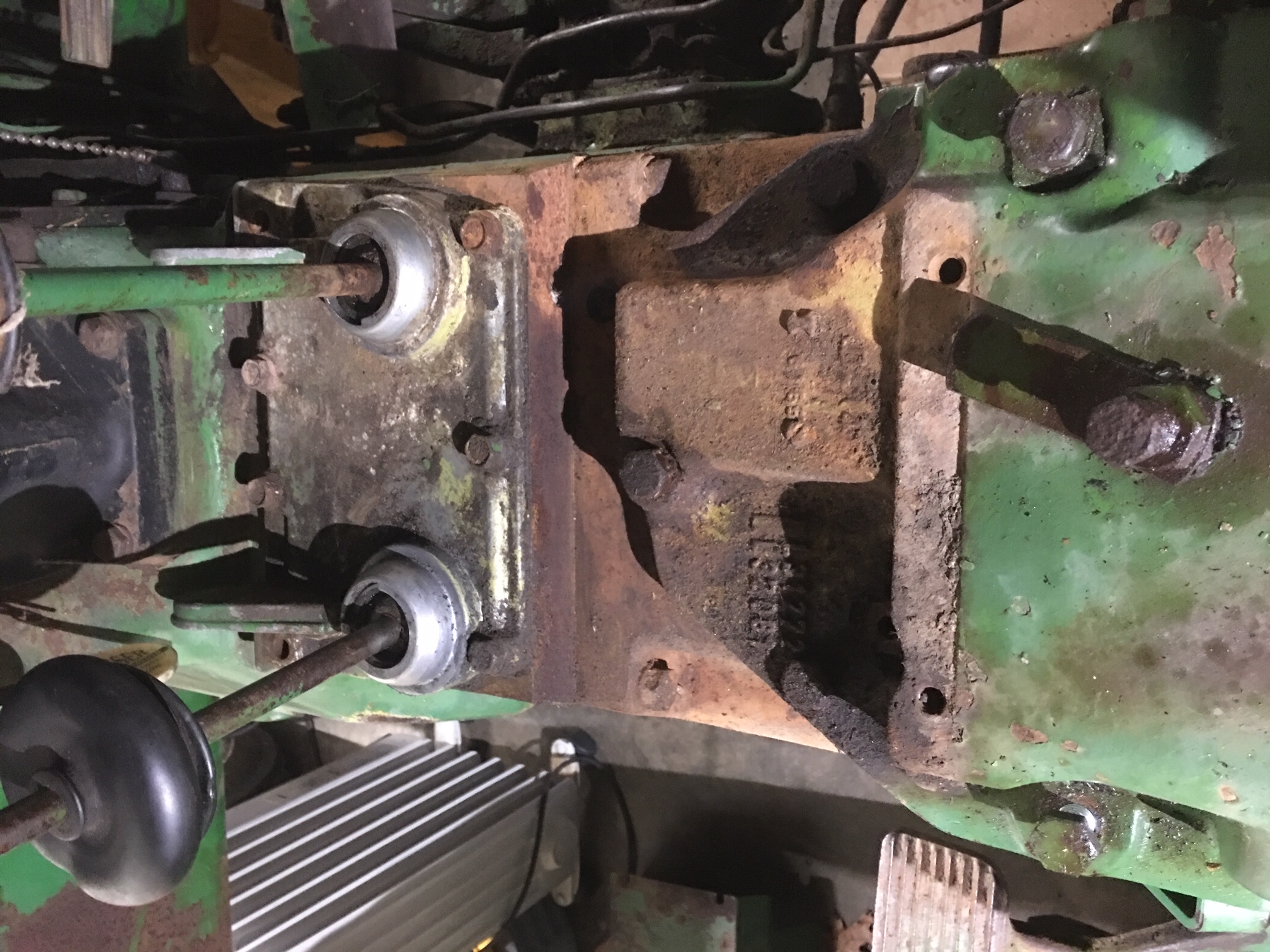

When I took the cover off the shifter area I didn't realize the levers would lift out with it. I wasn't too worried thinking it would be fairly obvious how they were oriented to be placed back. Not obvious...at least to me. Can you all tell how I should put these back in? Below is a picture of just before I took it apart (thinking it was in park and first gear?) Would it be better to get the gears in neutral? If so, how and is there a picture for reference of what that would look like?
Thanks!

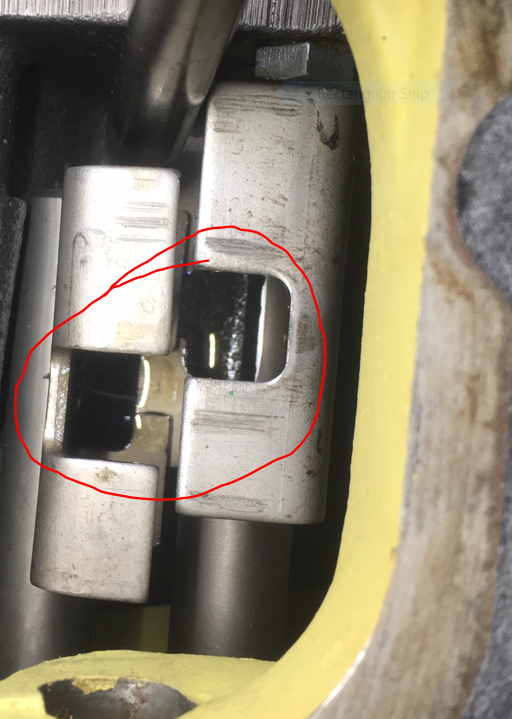

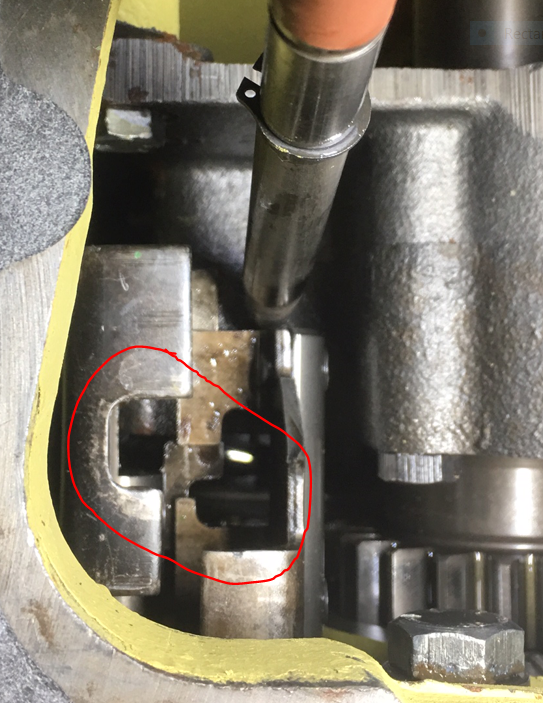

Circled in red is where the shift lever engages the shift rails. I would move the rails to line up the notches. so it will be in neutral.
