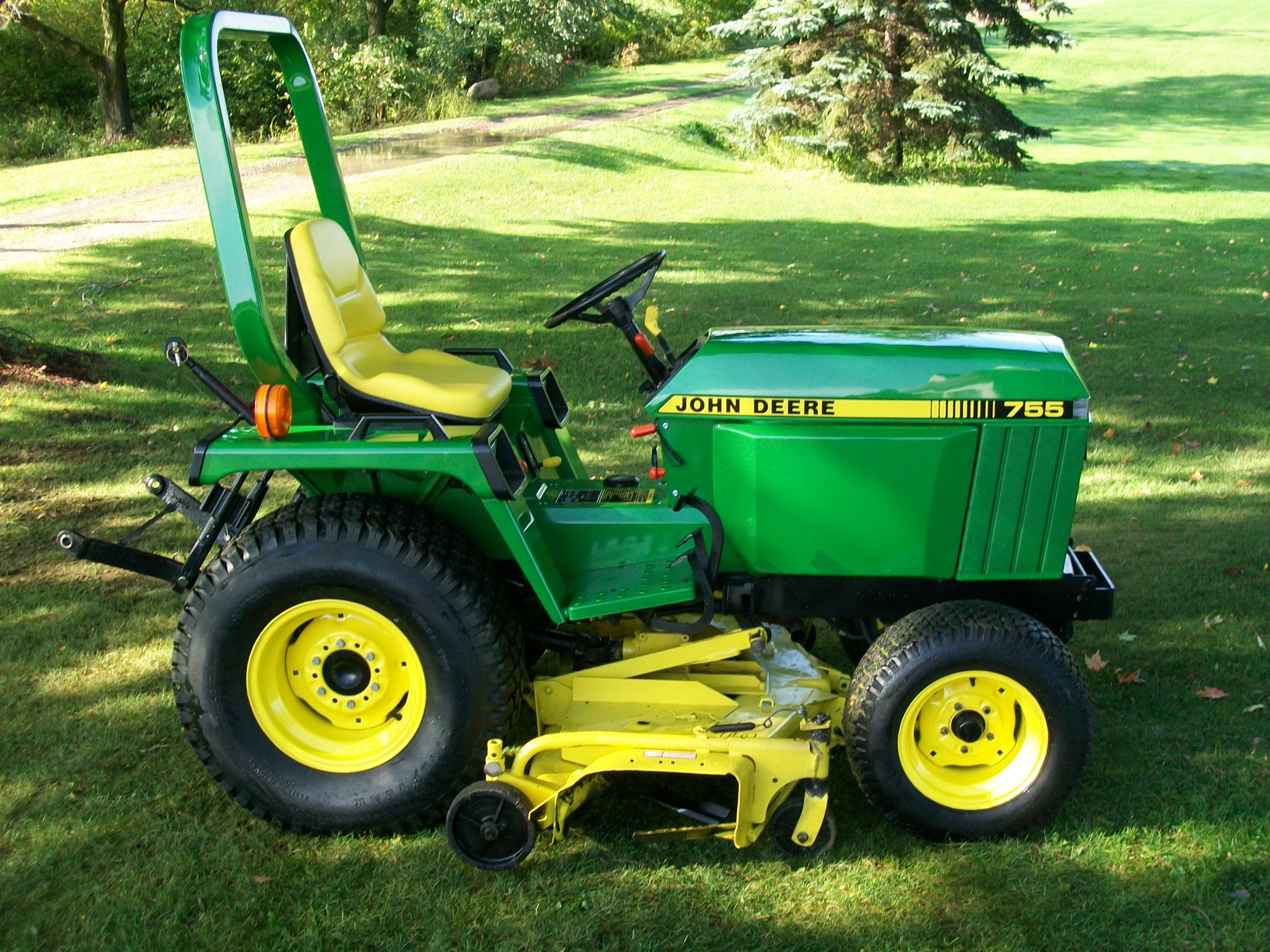

Got the time to tear the deck off and guess what- the blade was on upside down! Mows great now! Thanks for the help, I never would have thought of the blade though. Here are a couple of pics.
WOW:eek: That thing looks better that new!

960, a guy who restores Corvettes repainted the body panels. That old JD green paint they used faded a ton. It was done right-no rattlecan special! Added a hardener to the paint to make it more durable and shine longer.

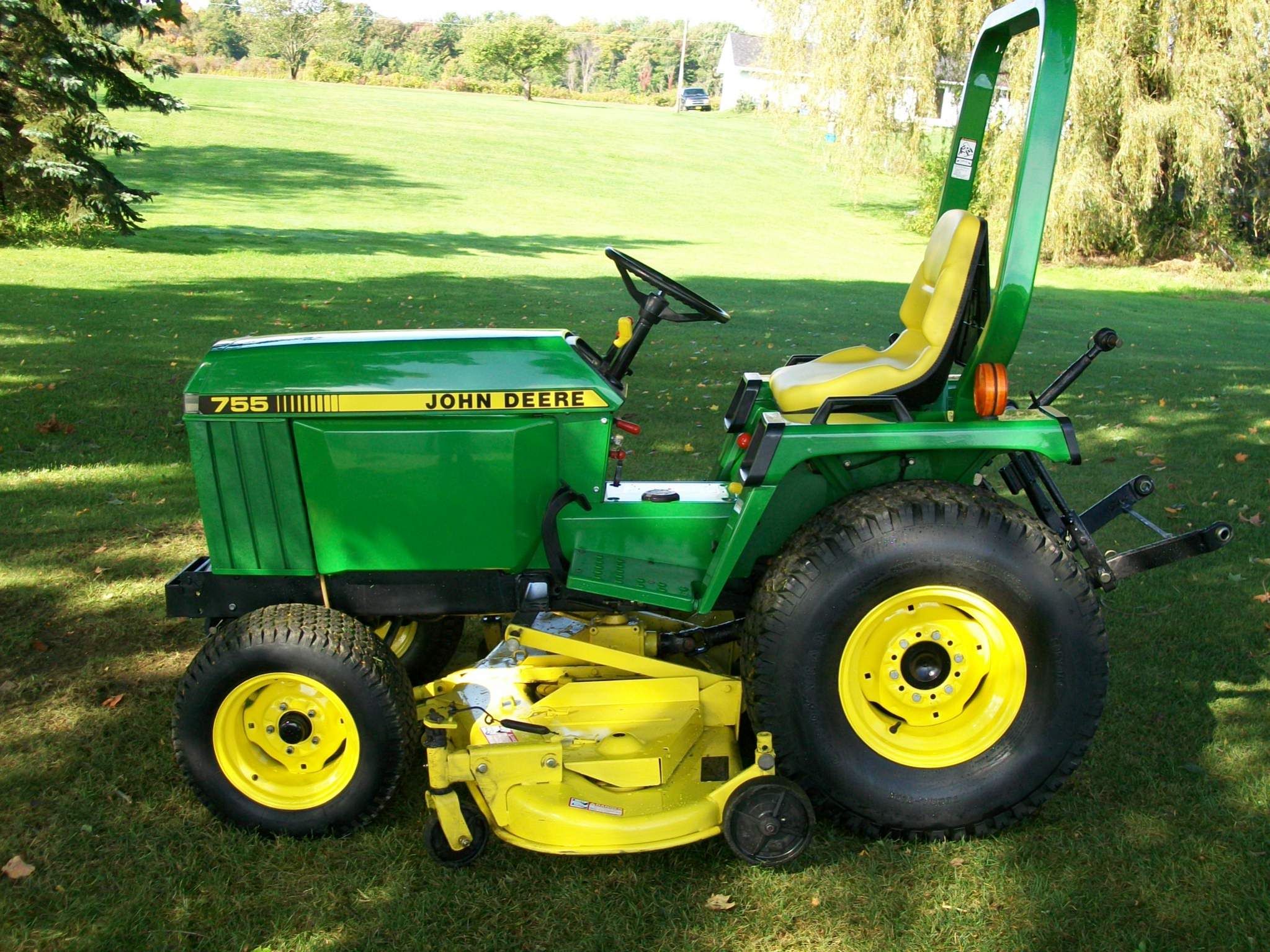

Very nicely done. Was the seat replaced? Some of the early models came with a yellow seat, but I know you can still buy OEM yellow or black ones. The yellow would be cooler during summer use. I attached a couple pics of mine with 608 hours.

The seat was a yellow replacement, not original. I should flip my rear wheels like yours!
