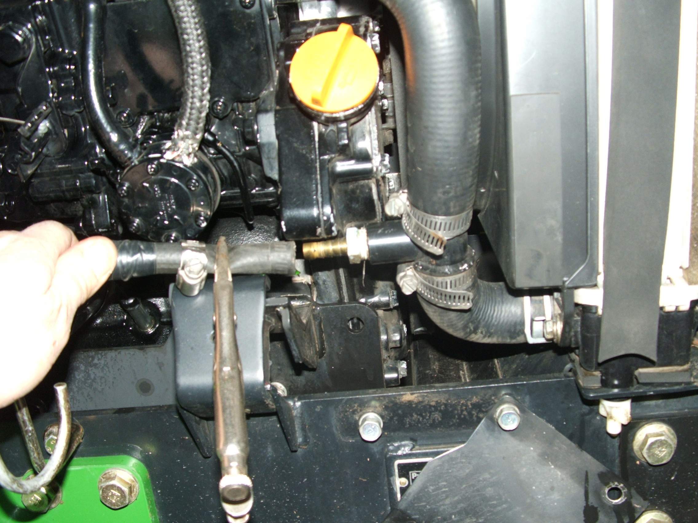

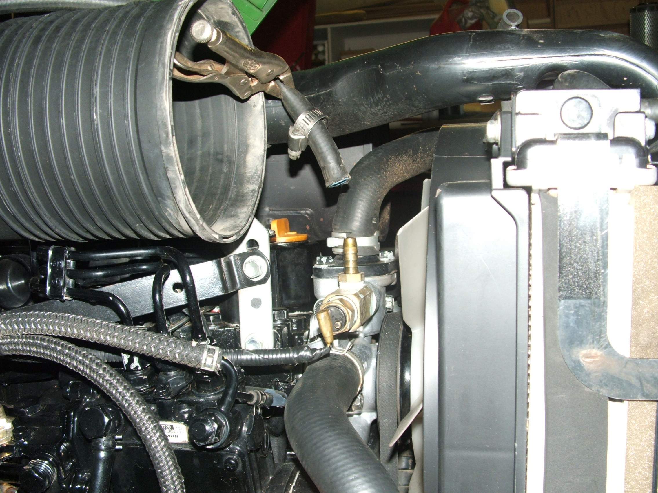

Hello everybody long time no post , Anyway I recently purchased a used Curtis Cab for my 755 John Deere and was wondering where I should tie into for the cab heater ? Pictures would be greatly appreciated !

The question im asking Is where to tie into the cooling system ? couple of possibilities ... ?
/ 755 Curtis Cab Heater #3
Here's mine! 2305 JD Top one is your hot water, bottom is the return.
Thanks mine looks a little different , but I will try to figure it out
