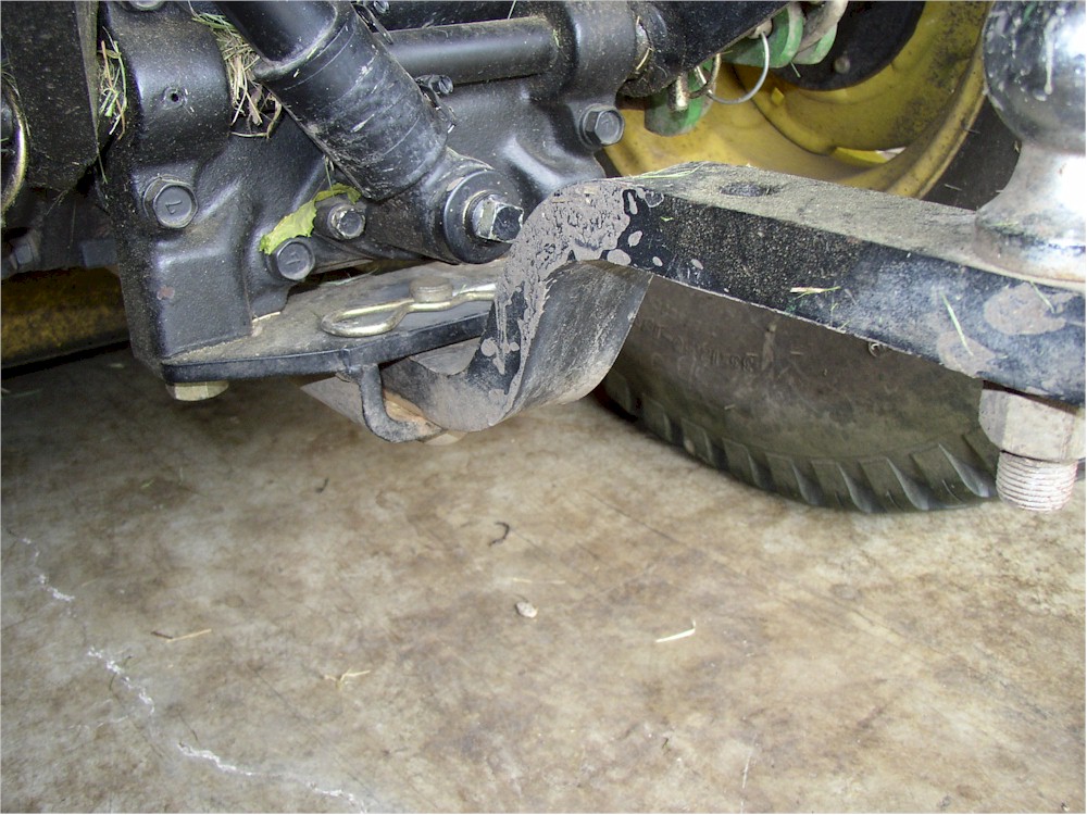

Great news...I filled the radiator back up with some water, washed the crud out of the cooling fins checked the belt and away I went and havent overheated yet! Thanks guys! I need a new water pump belt on there its a little rough an crispy..... anybody know anything about a hitch thats suppose to go on it? There is a insertion point with a hole for a pin right below the rear pto but I cant believe that anyones suppose to get a pin down through that hole. I want to attach a 4' york rake to it. I love this little tractor.. It was my pops and was shipped to me from up north but I do believe that there are some pieces missing...

What you are missing is the drawbar. The hole is for the pin to hold it. The pin needs to go in from the bottom and the clip is on top.
