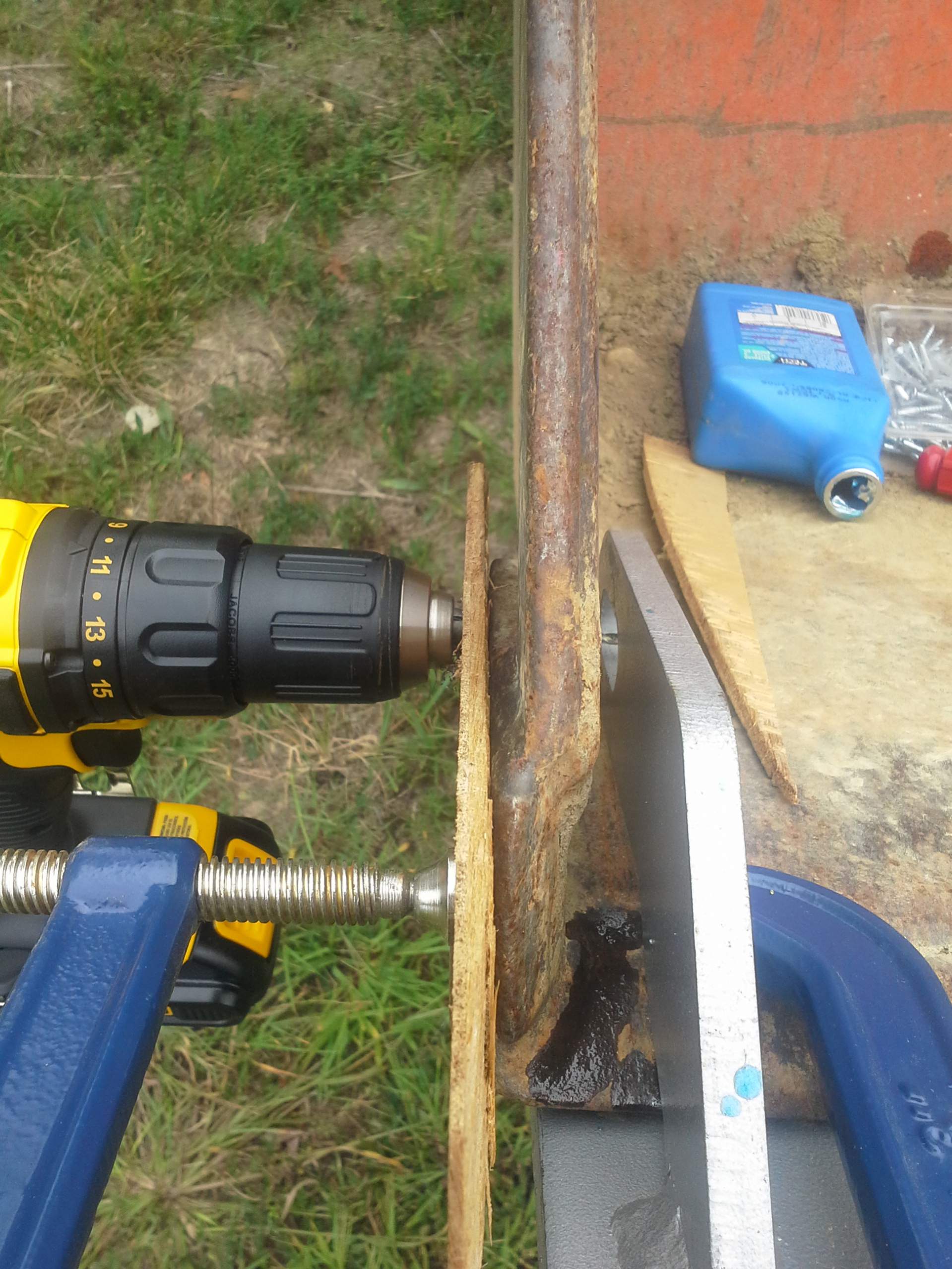

A couple of months ago I ordered a 6' piranha tooth bar. It came very quickly. The service was great.
I just got around to installing it. I lined up and drilled a couple of pilot holes. Rut roh, the holes are very close to the reinforcement bar weld. So close in fact that I would have to grind on the weld and reinforcement bar just to get the bolt head flat. Not a problem I thought. Out comes the 4.5" angle grinder and new grinding wheel. Wow is that steel tough! So tough in fact that I have about given up and am thinking about contacting BXPanded and seeing if they will accept a return.
Question for you guys; is there an easier way to grind on the reinforcement bar. What tool would be best suited for that job? I want to keep the to Piranha, but I'm kinda stumped. Suggestions/ ideas welcomed.

I ran into the same thing, the bolt hole came out slightly into the reinforci g bar. I put the bolts through ant tightened pulling the bolt cockeyed and went to work thinking i would grind off flat later. The bar makes an amazing difference. I have abused it on rocks using breakout force to lift slabs free, I have dug stumps ans roots on big trees, and all day digging for bldg site prep and the bolts have not moved at all. Who cares if they are crooked? I dont anymore. This thing made a bulldozer out of my tractor. I can fill the bucket with dirt on every push as long as the clay is not dry.

Mine is half on / half off the reinforcement also. Luckier than Raised on a Deere, mine did not go cockeyed when tightening. The bolts are very strong, but really, they are just there to prevent accidents. When you push against stuff it is the bucket edge that takes the force... the bolts shouldn't be taking a lot of the force.
No need to grind the reinforcement. It was hard enough to drill through, grinding it never crossed my mind.
So it isn't as pretty as when installed on a BX... it will work just fine.

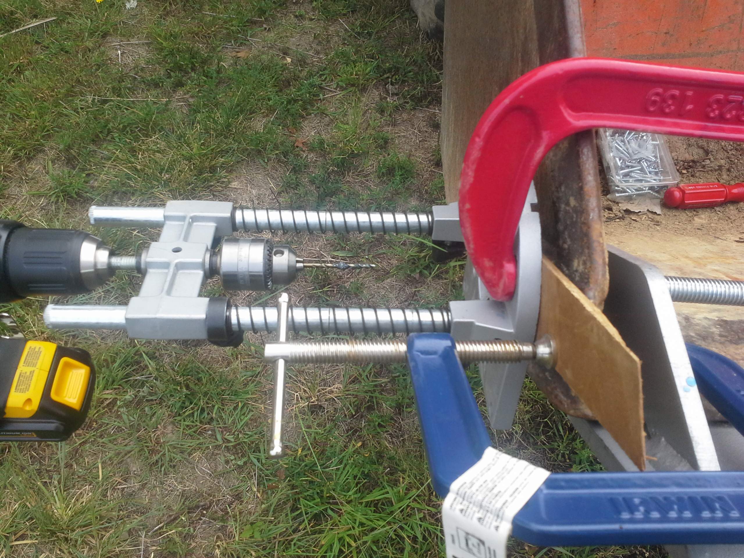

I ended up drilling the bar and used a drill stand w/ my Dewalt 20v drill and various cobalt bits
held on the bucket with clamps and strategically placed wood shims.
It took about 10 minutes per hole, drilling SLOWLY with various bits and lubing with chainsaw chain oil (it's sticky so it hangs around a while).
