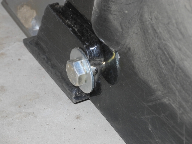

Took me awhile to get a pic of my piranha bolt on my Kioti CK27:
Drilled from inside. Could not use step bit. Mine was far enough inside the reinforcement that, although the bolt shows, it did not cant when installed.
edit to add: had to buy longer bolts, of course. as long as buying new bolts, went to grade 8.

If you read my post (#99) I had the same problem drilling the reinforcement, used several cobalt drill bits starting at 1/8 and going up to 1/2, plenty of oil and the "drill press".
The slot should be long enough so you can get entirely within the reinforcement for a flat mount.
