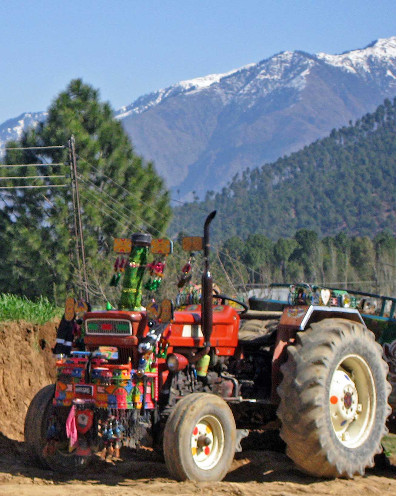

You caught me! :) Actually I only post at this hour when I am either outside the US or jet lagged after returning. Here is a tractor photo I took last week while working in northwest Pakistan. To keep the post relevant, it was interesting to note that virtually all the tractors there were either MFs or Fiat and were all about 45-60hp. No FELs at all. No mowers or lawns either. Just plows, cultivators and road trailers. They also use the tractors the way we use pickup trucks and they decorate them as you'll see in the photo.

   / 72" finish mower on a 21hp tractor??? #23
I didn't know that there were Mummers in Pakistan! That tractor would look at home in Philadelphia on New Year's Day.
Thanks for the cross-cultural photo.
