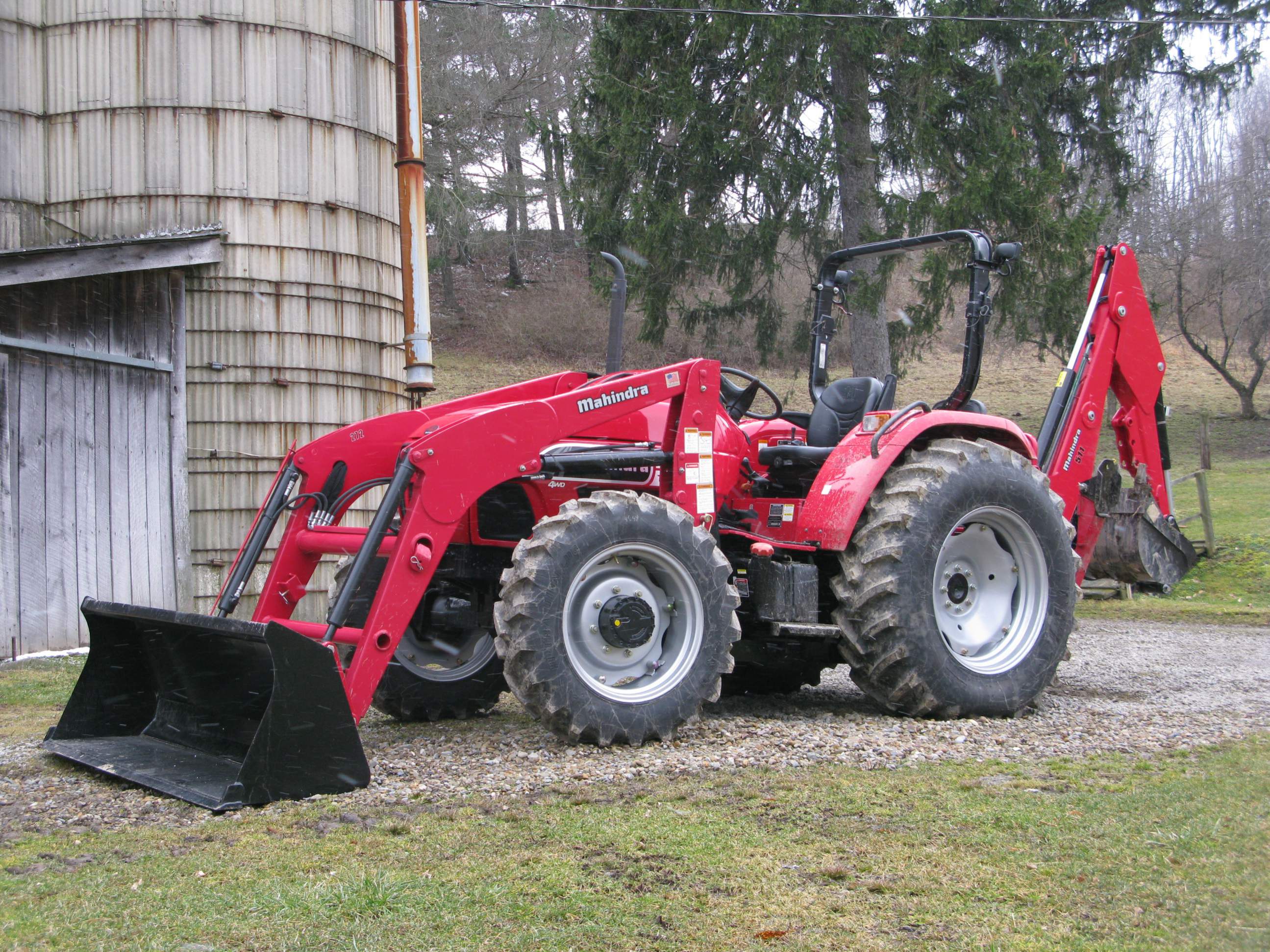

Have been way too busy having fun on the new machine. I was going to wait until I had the canopy installed....but here are a couple pictures of new machine.
All I can say is wow....

Farmerboy,
Beef up that loader bucket with an angle welded on top. I bent mine and welded 3/8th inch angle on top and 3/8 inch plate on the sides.
If it isn't too late to get more included in the "tractor package", get a Bradco thumb for that backhoe. I have the manual thumb and it is worth it's weight in gold back there. Eventually I want to make it hydraulic. Bradco has kits for both. The 511 backhoe already has the mounts for both kits.

Congrats on your new tractor-it looks great:thumbsup:

Great looking machine! Someday I'll spring for a real backhoe....I wouldn't call the backhoe on my 3316 a backhoe.

Congrats ... I'm sure you will find many uses for it.
