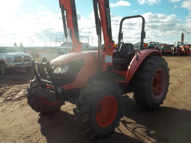

Finally received a quote for a new 7060 today. One thing I asked for was the R1W tires that come on a 20" front wheel and a 30" cast rear wheel. The very first question I asked the saleperson was if the fronts are adjustable. He responded that they were, but after cruising through a bunch of posts with pics on here, I don't think that they are. I stole a couple of pics from another thread to add to the confusion.
Anyone know what size tires these might be? They look adjustable.
I believe these are the 20" wheels that come with the R1W wheels, and they don't look to be adjustable.
/ 7060 R1W tires #2
The standard sized "pizza cutter" front tires are supplied on two piece wheels that can be adjusted for width.
The optional metric sized tires are supplied on one piece wheels that can be adjusted into only two positions by moving the assemblies from side to side.

That is correct, however if you dish the wheels out they can interfere with loader mounts if fitted.
The 20" R1W radials have pretty well been standard on M series that size in Canada since the 40 series. I test drove an M5040 a few years ago that had the 20" radials dished out to the wide position and they rubbed on the Kubota (Orange ALO M loader) mounts on a full lock turn.100_1859.JPG
The 20" R1W radials have pretty well been standard on M series that size in Canada since the 40 series. I test drove an M5040 a few years ago that had the 20" radials dished out to the wide position and they rubbed on the Kubota (Orange ALO M loader) mounts on a full lock turn.View attachment 610744
PDI includes inspection and readjustment of the steering stops after installation of optional equipment, e.g., FEL, and tire width adjustment. Such inspection should include interference inspection including full steering lock at maximum axle oscillation but many (most?) dealers do neither.

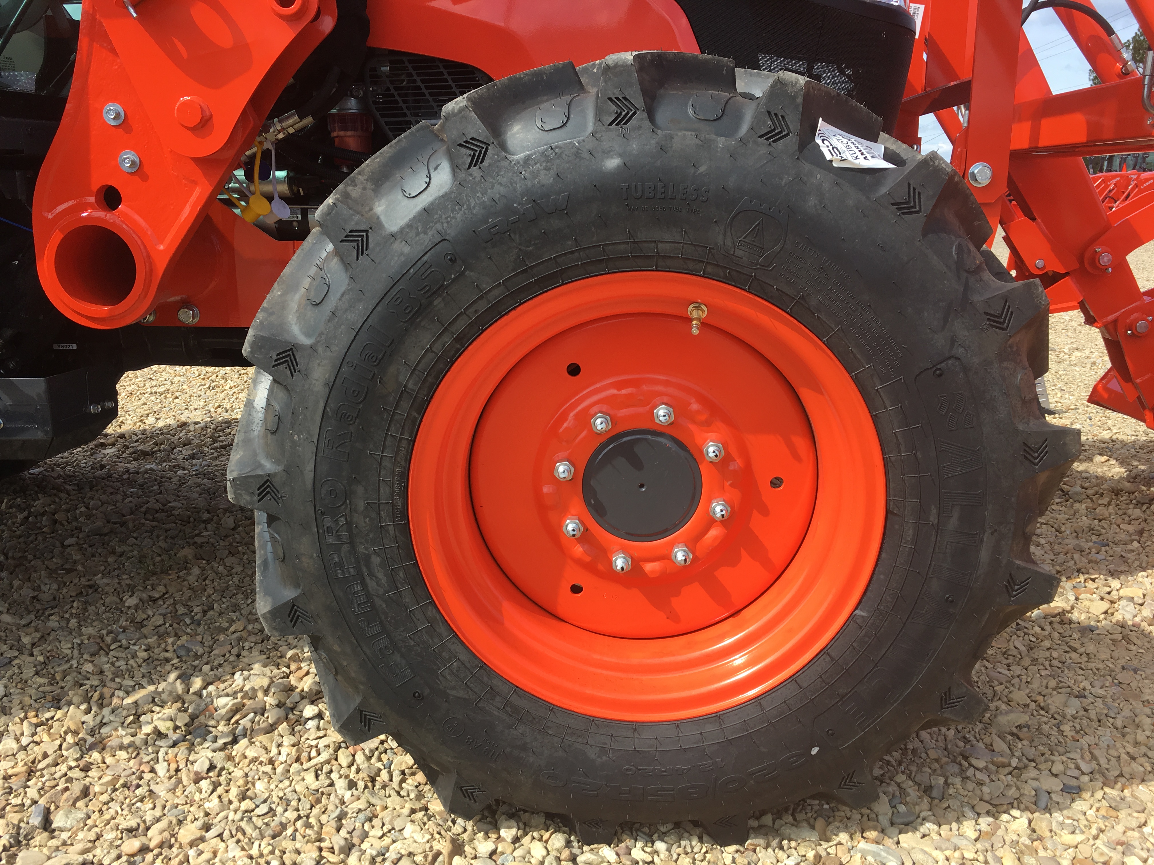

Hmm - - the picture shows that there is only two settings. Dish in - dish out. The front rims on my 2009 Kubota M6040 have the same ability to be adjusted as my rear rims. There are eight differing settings. I have my rear rims set out to the max and fronts are at a near neutral setting.
My tires are OEM - six ply - bias - Titan/front - Firestone/rear.
A photo of my front tire/rim
/ 7060 R1W tires #20
Yep. You don't have R1W tires.
