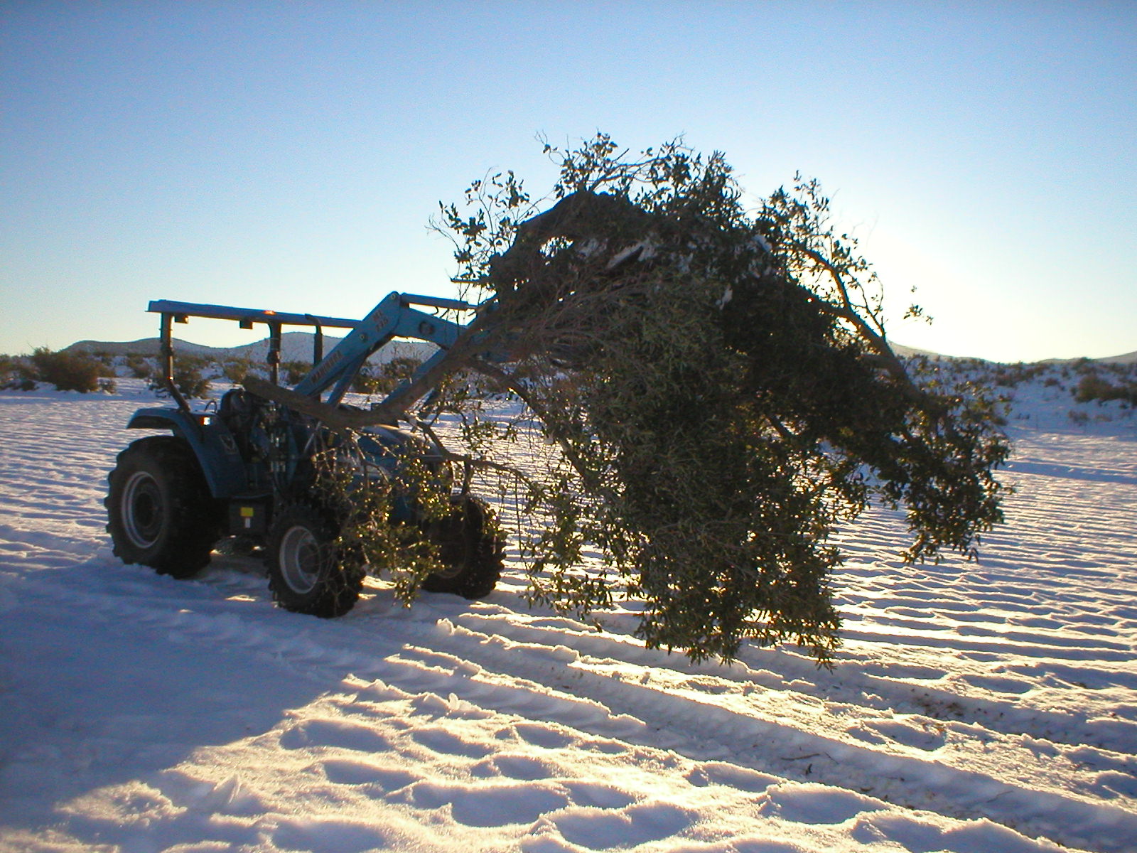

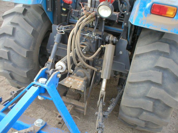

Dan, do you have an idea of what implements that you will need to complete the tasks that you are going to try and accomplish? If not, what are the tasks that you are wanting to accomplish?
I know that you have a some acreage and have about 3000' of road-driveway to take care of. Does your property have a lot of trees and or brush such that clean up is in the future? Perfect for using a grapple of some sort to help with that chore. Much more efficient than getting off of the tractor and hand stacking into a loader bucket and hoping nothing falls off as you transport the trash to your dumping area.
As far as your roads, the best single implement to have is questionable, sort of depends on the terrain the roads go through-over. But road maintenance is where Top and Tilt hydraulics shine. I maintain a little over 2 miles of roadways and have 4 different implements to do just that. While a person could get by with any of the 4, each one has a specific task that it is better at than the others.

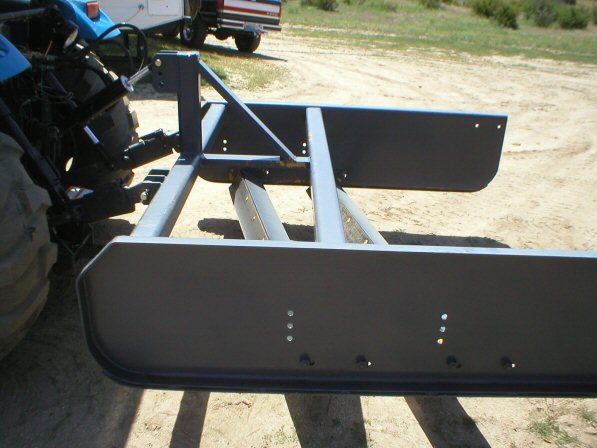

I feel that a rear blade would be a must if you have ditches along side of your roads. When you are grading with a rear blade, it is very nice to be able to angle the blade using a rear remote vs stopping, getting off of the tractor and manually setting the angle and or offset of the blade. When you have hydraulic control of these functions, you find yourself making adjustments as you need them vs just getting by with whatever you have it set at as is very common with manual adjust implements.
A box blade is great when you have a high spot or area that needs to be shaved off. The box blade is great for moving material from one area to another providing that it is a reasonable distance of course. It is very nice to have hydraulic actuated rippers which is where that 3rd rear remote comes in.
I feel that the twin blade road grader blades are the single best implement to maintain the surface of our roads. Simple to use and is great for taking care of all the little imperfections that come along with most dirt roads.
I use a landscape rake the least of all, but when it is used it is mostly for final dressing-clean up of our roads. Roads always look great after using a landscape rake.
Something that you need to keep in mind is that with the size of tractor that you are looking at, all of your implements are going to need to be in the heavy duty range. I'm not saying that it is just rated heavy duty, I have seen a 500lb box blade that was 8' wide and rated heavy duty:laughing:, it is not. A heavy duty box blade for your tractor would be in excess of 1000lbs.
You should be able to get both hydraulics and hose sets for a complete "TnT" set for about $800 shipped to your door step. Hope that some of this can help, please ask any more questions that you might have. :thumbsup:
