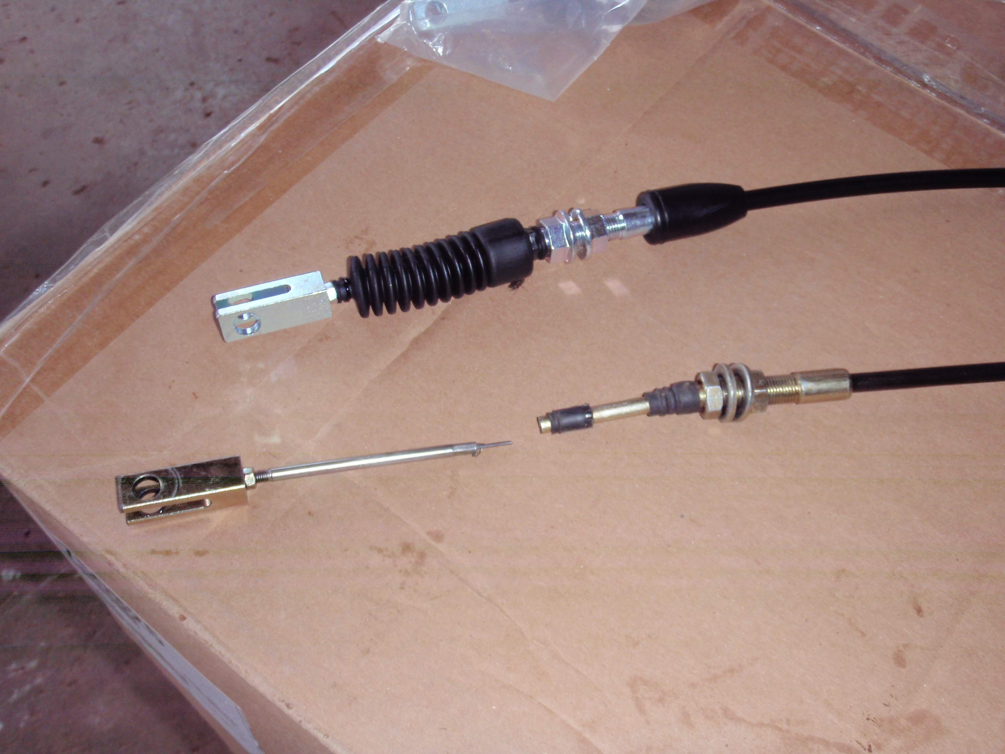

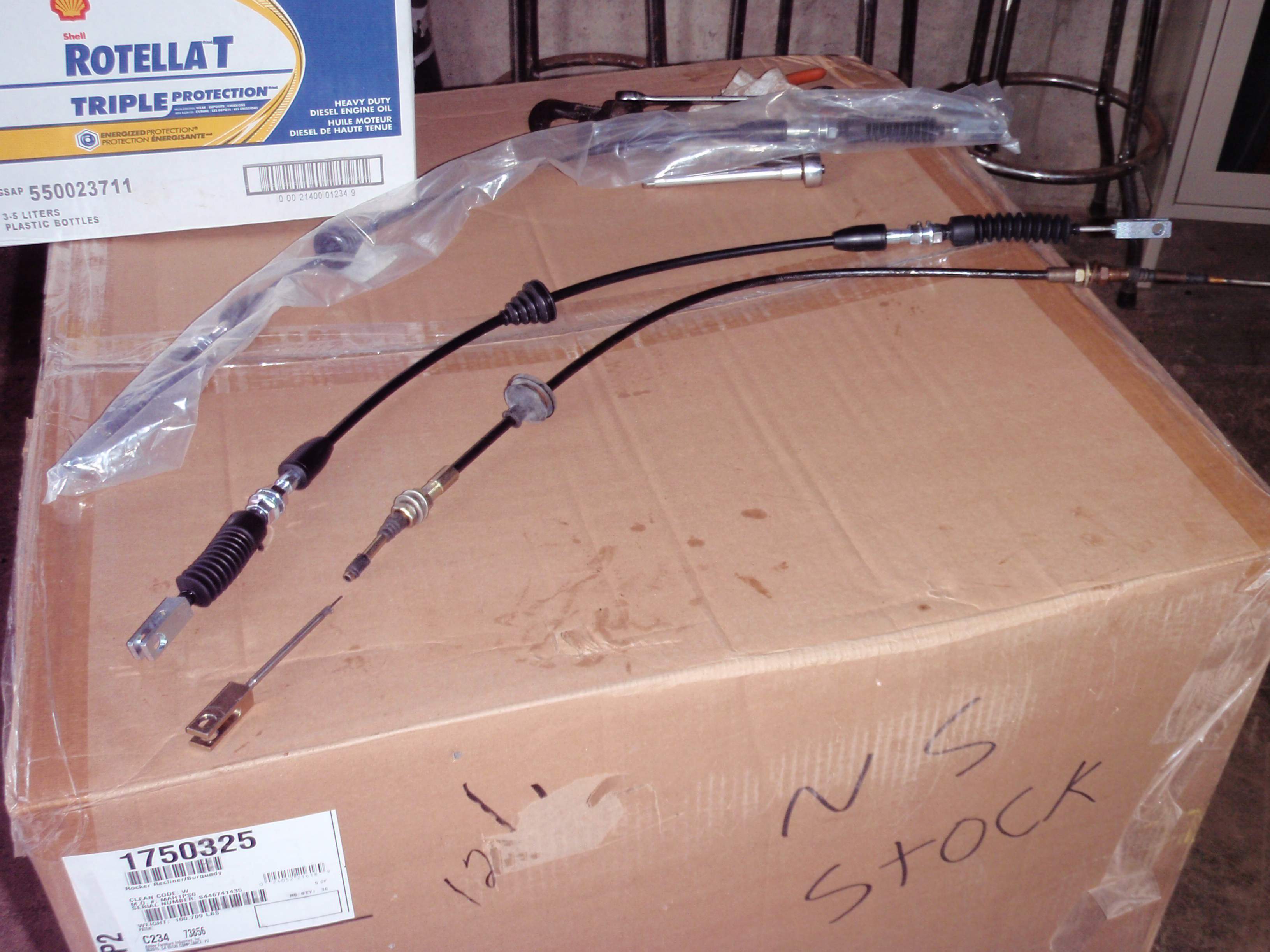

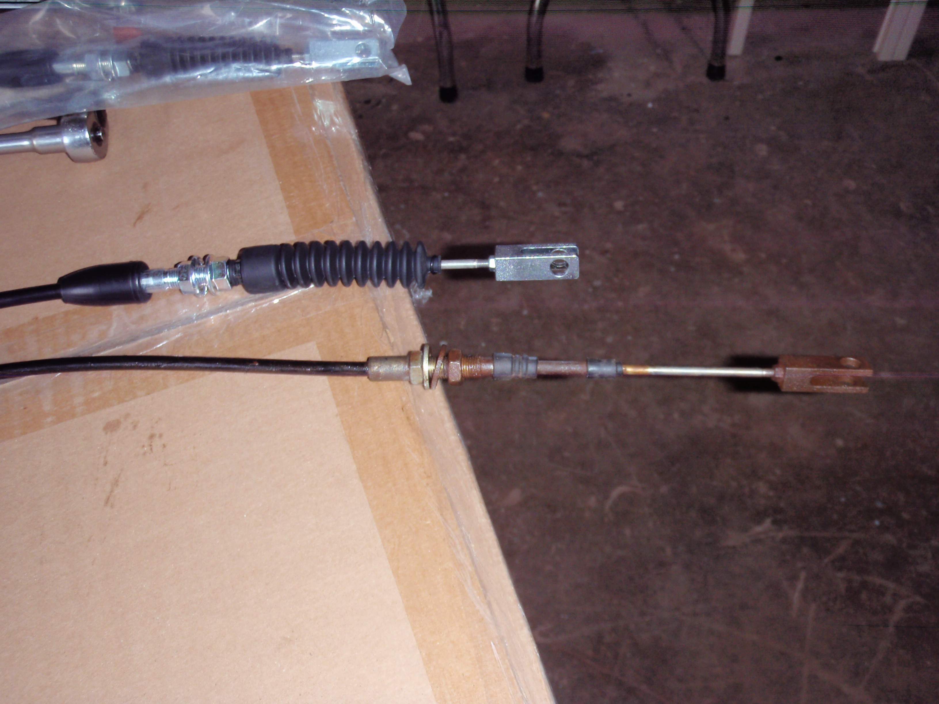

I'll take a picture of the two together, when I receive the new ones, I bought two in case the other one fails. Really kills me spending 500+$ on something I'm making payments on!
/ 7010 Transmission cables
Updated vs original

/ 7010 Transmission cables #11
Thanks for posting pictures of the cables. Hopefully, the new ones will last for years.
