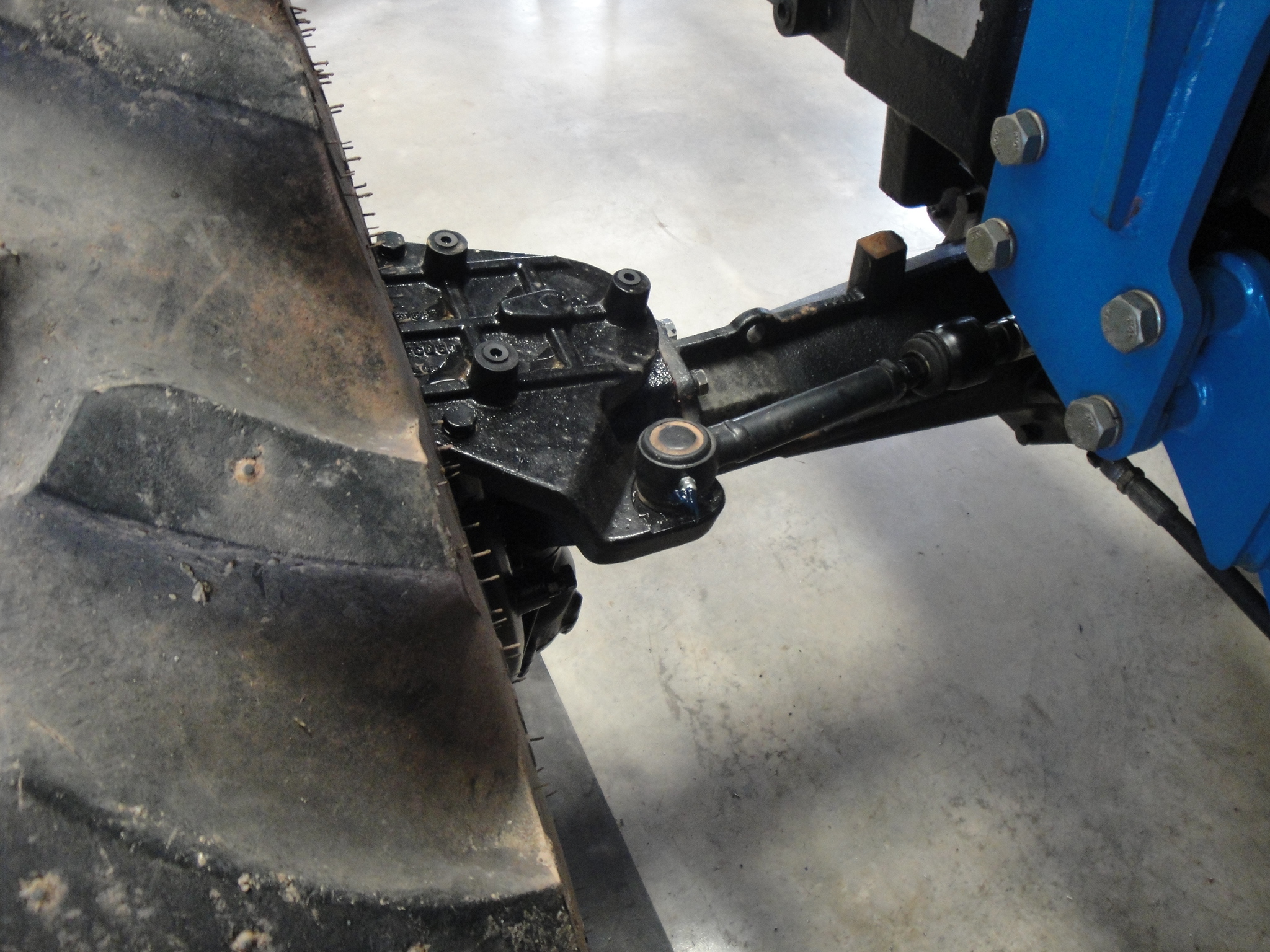

2013 7010, tie rod ends worn out, 800 hrs. Anyone else see this? Little package is coming today,$ 800-900. I'm trying so hard to like this tractor.

Good idea, hopefully the replacements will have fittings, actually I have to replace the tie rod end, and the short shaft that ends in a joint that's attached to the steering cylinder, that joint has even more play than the tie rod end, I could see them moving back and forth as I drove.

This is the tractor that's had the hub replacements, but all this present wear are on parts external to the hub, no contact with shavings.

LS mechanics replaced both hubs today on my 2012 7010. They are replacing all of them under warranty. Mine were fine but nice to get the latest upgrade done. I have close to 900 hours on the tractor. The tie-rod ends the mechanics had with them today had grease fittings. I am going to drill mine to help extend their life.
/ 7010 Tie Rod Ends #11
Today I added grease fittings to my tie-rod ends on the 7010. I thought it would be better to give them some grease before they fail. Just a note, that the boots should be sprayed periodically so they don't dry out and crack allowing water to get in.
