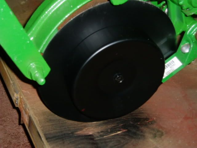

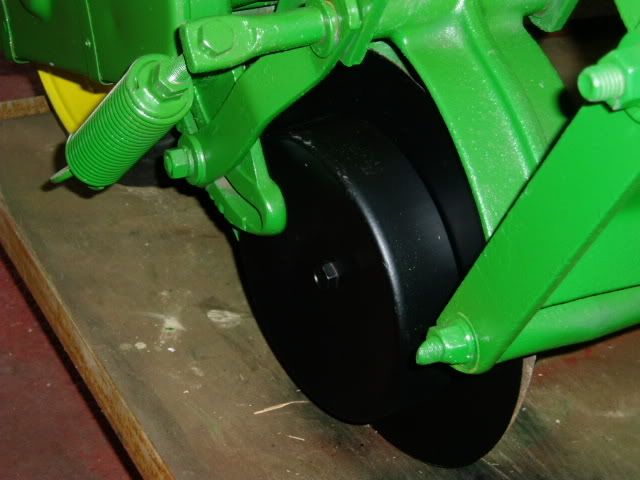

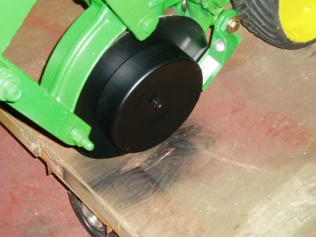

Another chain in the link is complete! The depth bands are on, along with the disc opener scrapers. Depth bands are the "gauge wheels" attached to the sides of the disc openers. They help to maintain a constant seed depth as well as to slightly firm the soil on each side of the opener. The scrapers keep sticky soils from building up on the depth band or disc opener.

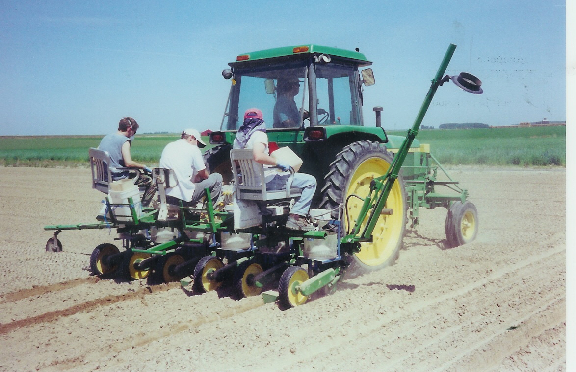

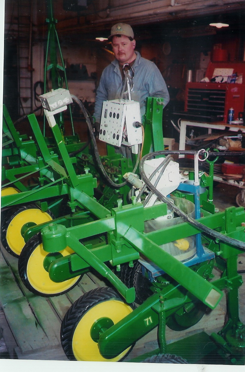

FWJ, excellent information and attention to detail. As you stated, JD Flex planters (70, 71) have been used for many years. Many of the ag research and early generation seed increase programs have used these units as a base on which to build specialized planting units. The seed program I was associated with (prior to retirement) used a gang of 6 JD71 planters with Almaco seed cones (instead of seed cans) tripped by electronic solenoids to plant seed from single heads or plants in short (10 - 20 foot) rows for breeder seed production and variety evaluation. The result was 6 rows in a block, each row having a seed from a different genetic source.
First picture is the planting crew and planter on the back of a JD4030 tractor. Each person feeds seed from pre-measured packets into 2 of the 6 cones. Each packet holds seed from a unique head or plant. The crops we worked with included small grains, grasses and dry edible beans. Row length is determined by the gearing in the planter unit which controls the relationship between one cone revolution and the distance traveled.
Second picture is the planter unit being rebuilt. The planter units, solenoid control panel, push button unit and one cone are shown. We took a lot of pride in this unit but your attention to paint and restoration far exceeded what we were able to do. Thanks again for your posting.

Not only is that very interesting, your photos served a purpose. I got a great idea from looking at the "seat frame". I'm working on a plan to mount a fertilizer box off of another Deere planter and needed a good strong platform to mount it.
About 20 years ago, I visited a Pioneer Seed Corn production facility in Northern Indiana. They had a similar planter to yours. I was trying to recall details of the way it was built.
Thanks!
Bill
